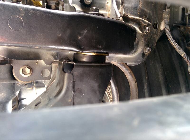

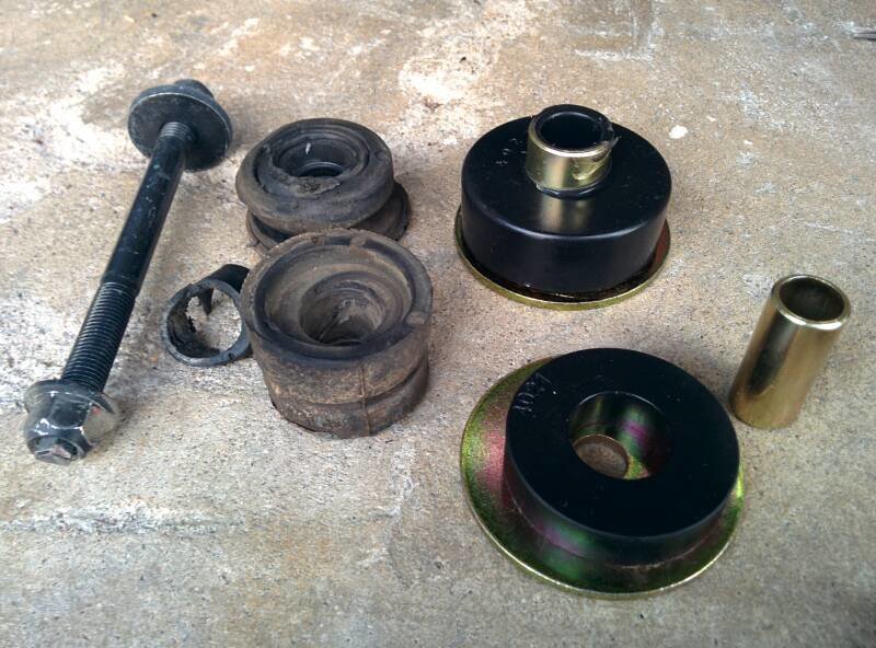

    I got the first one done in 20 mins. The other was a pain in the ass and still not right. I could not get proper alignment for the bigger bushing sleeve to seat properly. I tried tapping with a large wooden dowel but I only succeeded in deforming the surrounding sheet metal. :(
    I tightened it down enough and will gently flex the chassis to see if it seats properly on the way to work tomorrow.
    My bushings were beat, and one corroded bolt.
    Pass side.
    New v. Old
    Edit: I may try using my hi-lift to lift the driver side of truck from slider to see if that flexes it enough. Only need like 2mm more clearance.

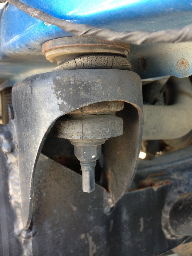

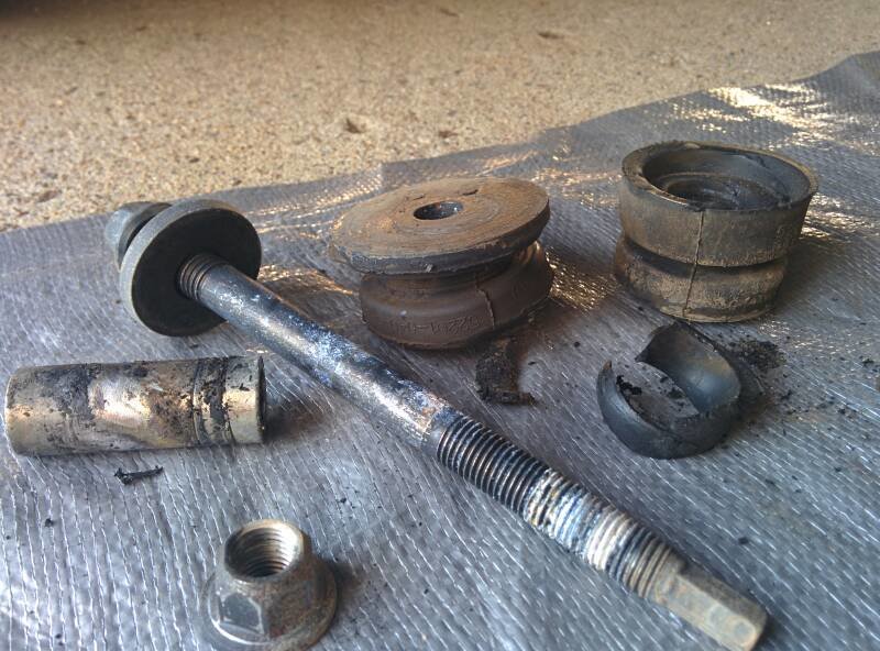

    My OEMs show damage after <6K miles. Replacements going on now.
    10 min later...

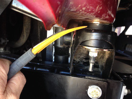

    I used a small pry bar as shown to get the top OEM out. Easy.

    Are these worth it? Does it feel any different or is it just piece of mind? I got 30k on mine.

    Totally worth it. Mine were torn to shit on a 2012. Since I've changed them I don't see my front end dancing around and the noise and squeaks have gone down a lot.

    Look at the pics in post #17 and you'll see why this is such a good idea. It's cheap and easy= no brainer.

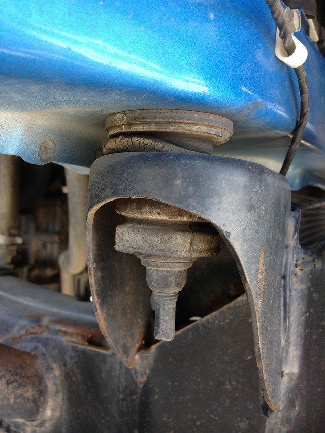

    How do mine look? 06 and 57k on the truck.

    They are smoked. Get the kit.

    My new bushings seem to make a lot of noise. Especially off road. I greased them plenty with super lube when installing... Maybe that was a mistake. :notsure:

    The lube definitely helped to quiet mine down. Was going to get in there a little better with a thicker grease when I have time.

    Double check that all of your hardware it tightened properly. I did the whole cab and do not have any squeaking.
