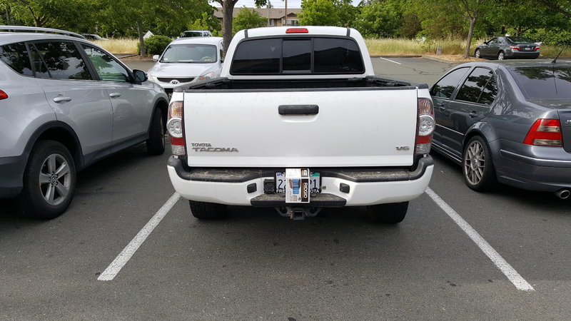

    For the record Taco lean , pre bushing install
    12TRDTacoma[OP] likes this.
  12. May 3, 2016 at 5:32 PM
    #832
    12TRDTacoma
    12TRDTacoma [OP] Powered by Ford, GM, VW, and Mercedes
    Aug 20, 2012
    #85133
    16,671
    Rob
    Concordia
    12 TRD Sport DCLB 4x4 Supercharged
    Boosted
    This ^^^ without question!
    The factory steering rack bushings have a ton of voids in them. Which allows them over time once they weaken to allow the rack to shift 1/4 side to side when turning the wheel. It also can causing wheel centering and alignment issues once they are FUBAR.
    I like what I see!! :thumbsup:

    Figured I'd post pics my driveway isn't as level as he home depot lot and also I would prolly forget....
