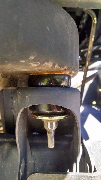

    Dude, don't bend your radiator support. You put a thicker bushing on top than what was there originally. Did you not expect it to raise your body? Smaller bushing up top is closer to the stock thickness.
    12TRDTacoma[OP] likes this.

    Just sand some off to bring it back down. I measured mine and it looks like I need to take about a strong 1/8" off if I don't want to use the top washer.

    The top washer is necessary to run to ensure a proper flat resting surface. Run it.
    Cutting the top bushing would make this especially more so essential to ensuring a proper flat surface, as when sanding or cutting down the bushing to a smaller size there is the chance you cut it ever so slightly diagonal.

    How tight are you guy's tightening the bolt? Seems like you can keep going. I know this info is in here but I can't find it, and I want to finish this tonight.

    This is a very good question. I was just looking at another member's truck and only on one side you could keep tightening it. One side was normal, it got nice and snug, the other side seemed not tight and the nut was way further up on the bolt.

    Are you saying I should keep going till they snug up? I didn't keep going.

    No, I don't know the answer. There has to be a reason why. Is the sleeve in the bushing lining up correctly or differently from the other side?

    I think everyone in this thread just tightned them until it's snug.
