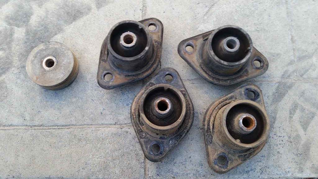

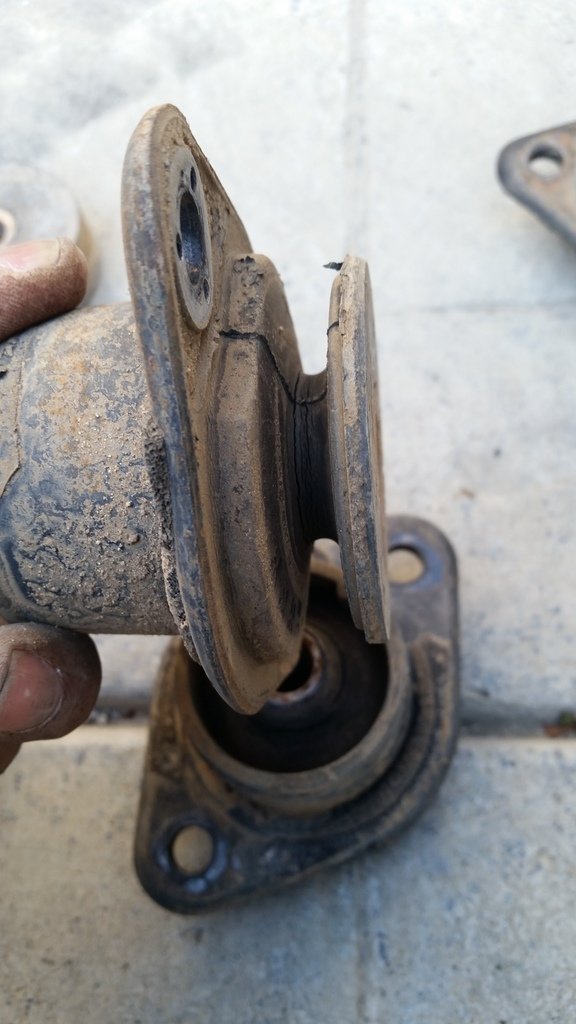

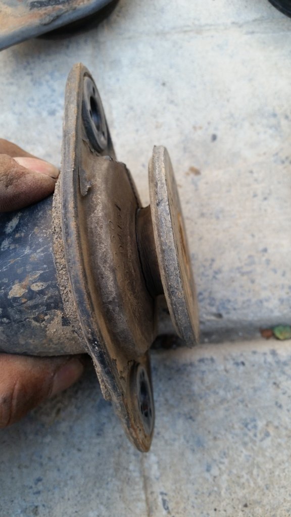

    Here to give an update. Finally completed the mod yesterday, I really enjoy it. The cab feels more "solid" per se. The old bushings in the rear ended up coming out super cracked, almost torn. The fronts were mostly intact, the rears were very pronounced in their tearing, which tells me that for some reason there is either more cab weight, or flex back there.
    Here are pics. The rears are the ones with the rusty center sleeves.
    Additionally, I have to say that Energy suspension's QA sucks. They sent me smaller center hole diameter washers than the size of my bolts. That or they don't suck and there is a variation in cab bolt sizes amongst the 2nd gens. Jeff @VolcomTacoma says he had 3/8" bolts and his fit just fine. Mine were 1/2" bolts. He had to drill my washers out some so they would fit. Just something you guys should be aware of.

    No, I never said I had 3/8" bolts, Just that the holes in your washers were 3/8". I don't remember which ones mine were, everything fit just fine :D

    Strange about the washer holes.

    Yeah Luckily I had a 1/2" drill bit and was able to drill them out. I had no issue with mine that morning, so its weird.
