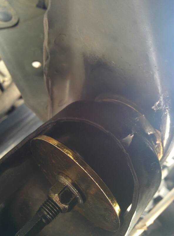

    That large washer looks like it would cause some noise.
    I think I might buy two kits just so I can use the big bushings and the small washers.

    Honestly, why even have that little washer up top, metal on metal. It also may be causing noise, not to mention future rust.
    Why not put a bushing between the body and frame, then under the frame, bushing/washer/nut.

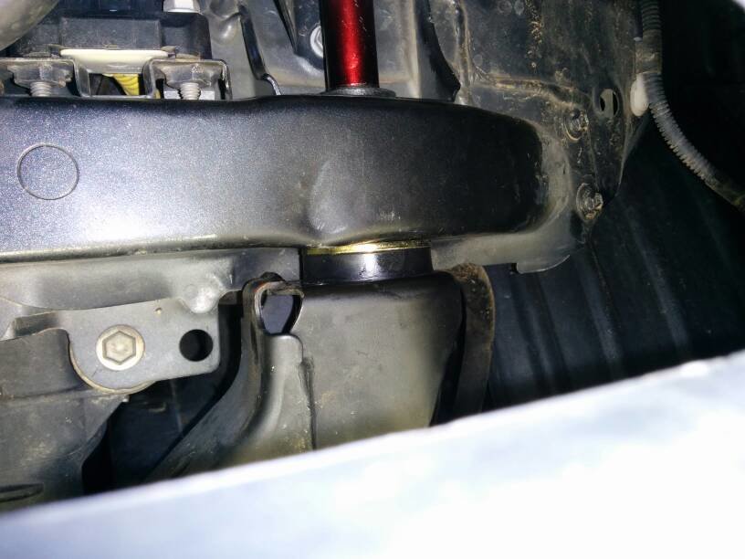

    I think I figured out what was wrong on mine. I think the noise I was hearing was the bushing slipping because it was not seated properly. It was not a squeak but a thud or knock sound whenever doing anything off camber. The noise started the day after I swapped out the factory rubber.
    Look how it was misaligned.
    I fixed it.
    I used a hi lift jack from slider, jacked the wheel 1" off the ground, and undo the nut and the joint comes right apart, no prybar required for swapping bushings
    :D :D

    I was thinking the same thing when I first saw the ES ones, but I did note that the Toyota one had an integrated washer built in.
    I dunno...

    I'm thinking of installing it like Roberto's, but just leave out the big washer. It also won't give me as much "lift".

    Yeah the big washer looks like it was contacting the frame...
    I say go for it.

    Yeah that large washer is pretty darn thick. As long as you retain the lower washer as it gives the fastening nut at the bottom a hard solid surface to clamp on you will be good to go.
