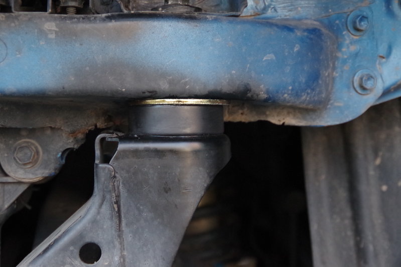

    I had to get my trusty long crowbar to nudge the subframe "tower" into alignment with driver's side core support bolt.
    If you closely at the pic, to the left of the "tower" and the right of the lower radiator mount bolt, is a folded over piece of sheet metal where a full hole used to be. That was the fulcrum point of my crowbar.

    I'm definitely a fan of the universal harder bushing. The effects were dramatic on my truck. With stock rubber, front end was mushy when pulling into sloped driveways at an angle. It was all I ever knew, so normal for Tacoma. When I put the es universal ones in there I was blown away. The front end felt planted, sure footed, solid, so much more confidence inspiring.
    Right on target. lol
    :( The core support is so soft. I did something similar by tapping with a piece of wood. I only succeeded in deforming the core support. :(
    Glad you got them in! +1 For wrenching in NY in winter! :thumbsup:

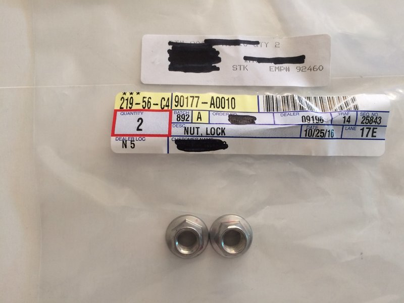

    Pick these up for the install Ken.
    2x- 90177-A0010
    Crom and DVexile[QUOTED] like this.
