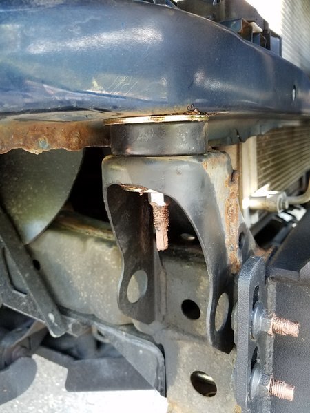

    Got the universal kit (9.4101G) from what I under stand is the small bushing in the kit should go on the top to avoid clearance issues between the fan and shroud ? I don't have an off road bumper. I want to avoid extra body lift, looking for a factory "like" fit. TIA

    I'll be doing this install today - I ordered new nut/bolt from Toyota as well (I'll post up the part number later for the hardware).
    I'll be putting the larger bushing up top

    I had to put the small on top

    Alright just installed mine. Took me about 30 minutes, a jack and a 2x4...a bit sketchy because the 2x4 kept wanting to slide out but I shoved my foot behind it....

    Yes small bushing on top then.

    I put the larger one on top. I did at first put the smaller one up, but my the front sounded like it pounded. Swapped them and been happy since with the larger one top.

    No fit or clearance issues with the larger one on the top ? I have heard of the fan rubbing on the fan shroud with the larger bushing on top.

    No sounds on my 13. Works like a champ and everything still looks alligned like it came that way from the factory. Maybe some of the older trucks have radiator support issues??? I know the battery weighs the front down pretty hard as well. I put mine on around 30k, haven't regretted it since, just turned 48k

    HAHA well I have heard both sides on here: big or small on top, that is the question. Seems like there is a very clear answer but nah can't be that easy. My truck bumpers are stock. Just want to only do this job once ! Guess I am going to try the larger bushing on top for now.

    Seems very sketchy, some do this, some do that. Can't hurt, if it doesn't look right, or you get the fan rub, then just flip them. Not too hard of a job if you pull off the grill at the least.
