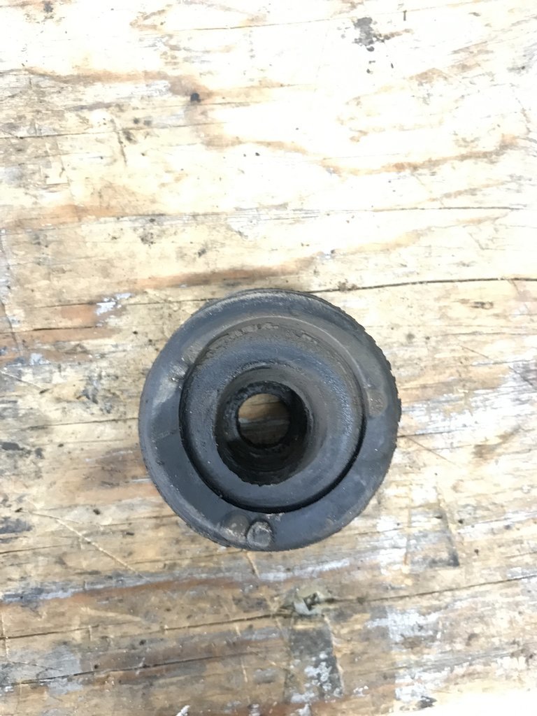

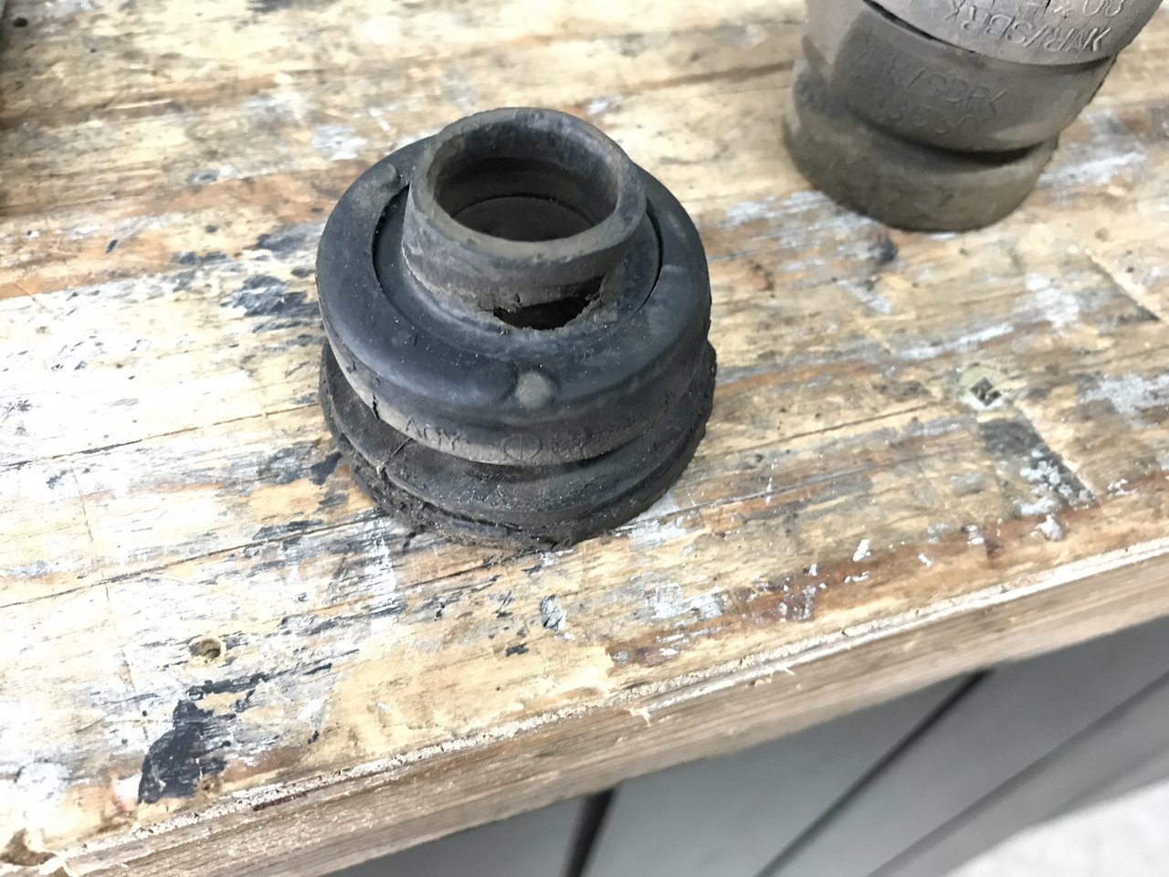

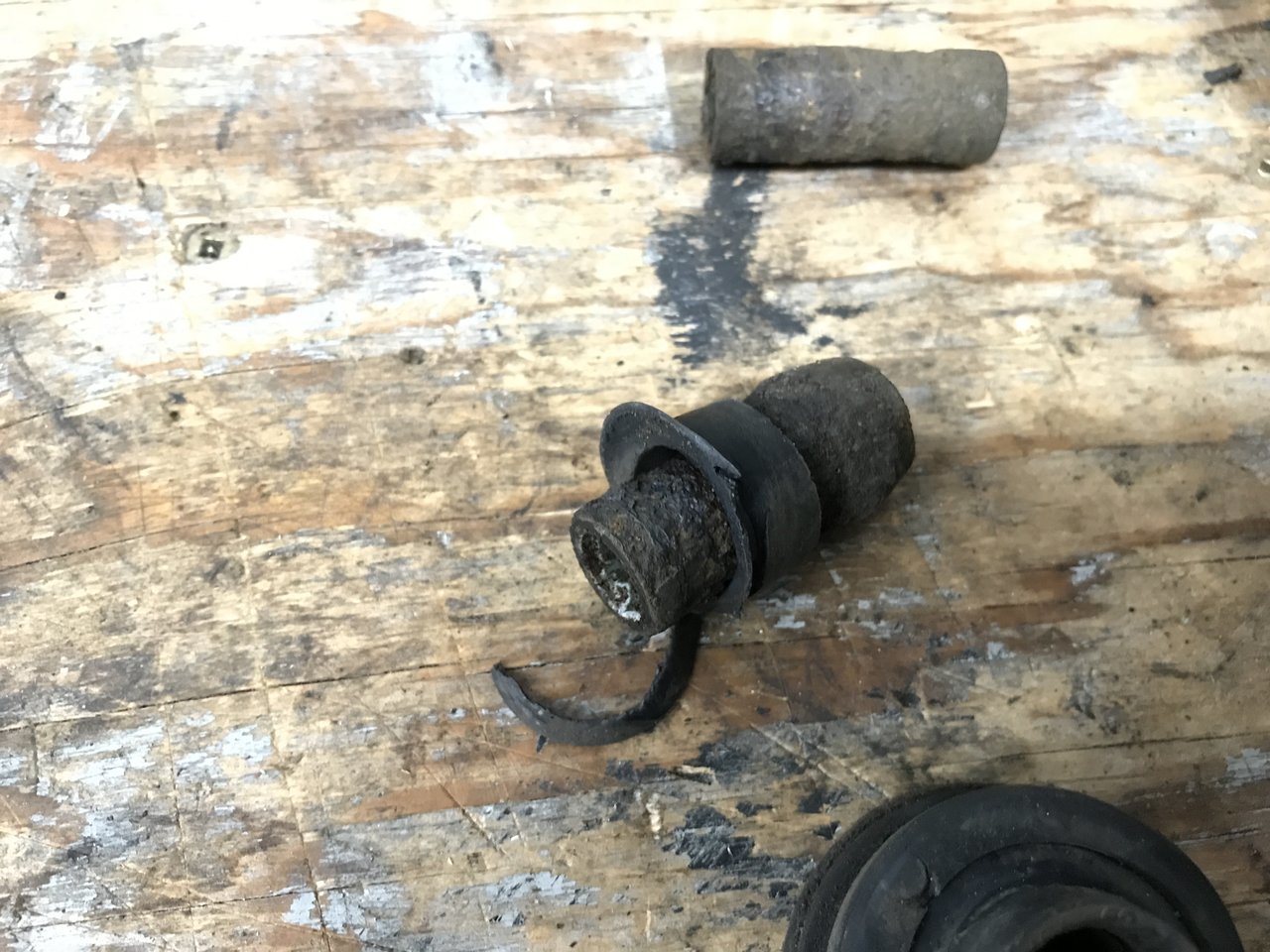

    Here's what my factory mounts looked like. The creaking I had is all but gone now. We will see if it does it bad tomorrow at work off road.

    So the creaking is gone under normal off-road driving. But if you hit a larger hole it will still creak. I'll have to have another look under there some day soon, might be aluminum bumper support and these new poly bushings stiffened it up enough to stop the creaking 90%
