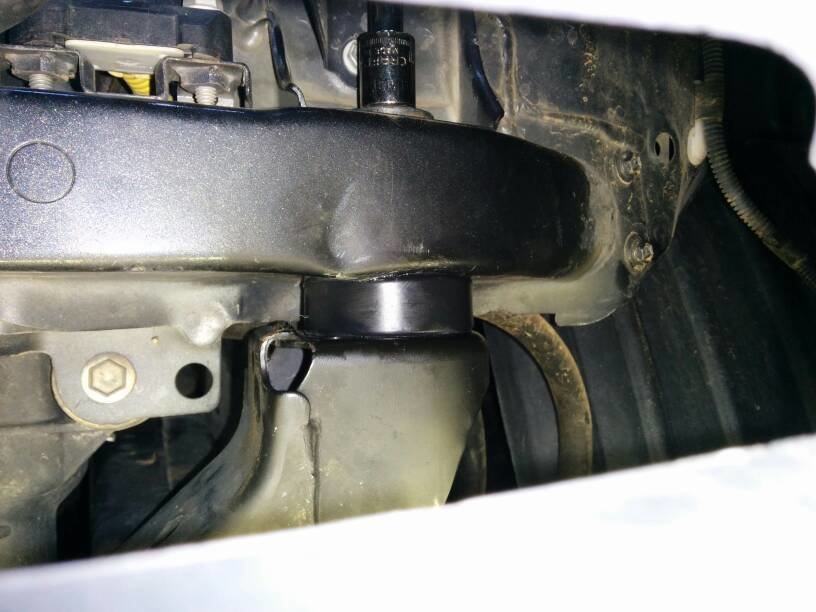

    Millions

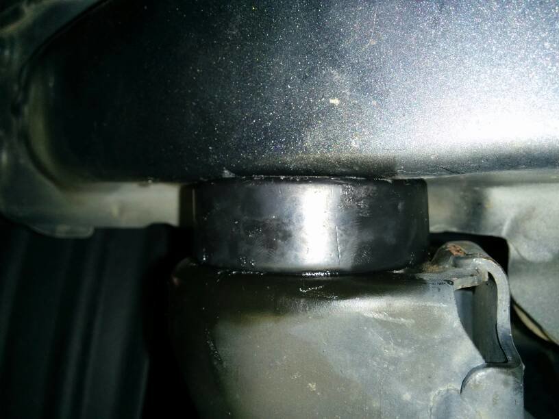

    Before dinner tonight, I decided to flip the bushing so the larger one is on top now. I left out the big washer. Can't tell from my pics but part of the big bushing bulges out a bit. I think that's what the washer does, keeps the bushing square. I'm not going to worry about it, but will keep an eye on it.
    Only reason I did this is because I think the big washer on the bottom was contacting the frame making a little noise. And I hate noise. :D
    BadBrains likes this.

    It very well may had been making noise. As for the washer I can see where it will begin to cause problems, put it on, it doesn't look happy in there as it currently sits. Or get a thinner washer set from a hardware store. Use the current ones you left out as a reference for the holes diameter and the overall diameter.

    Looks like that dent is causing the bulge. Still think I'm going that route with mine.

    Oo.. I just saw that. Ouch.

    That dent is from tapping with a wooden dowel when I couldn't get proper alignment.
    It can't be stated enough that the sheet metal is really soft.
    I know my core support is bent. After flipping the bushing the pass side bumper has some clearance, but the driver side does not...
    Oh well... :D
