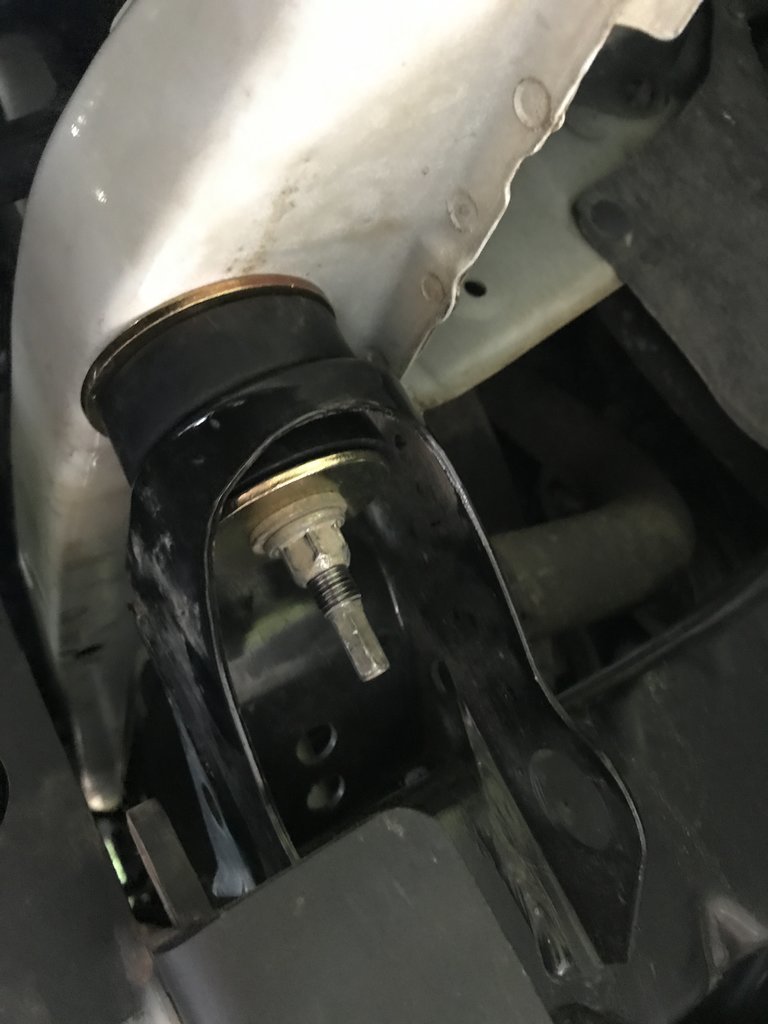

    In case anyone is having trouble getting the top thick bushing in place since the sleeve sticks out quite a bit....a well placed stock bottle jack works wonders. Since it's braced against the frame it lifts the rad support exactly how you need it.
    (Bushing bolt not yet tight in the picture)

    It takes the install from "this is impossible...never going to happen" to "Oh, easy" in seconds. :D

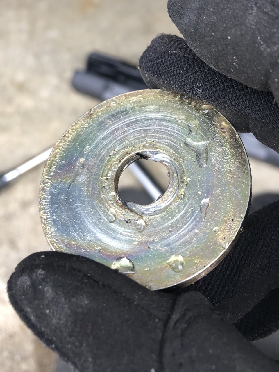

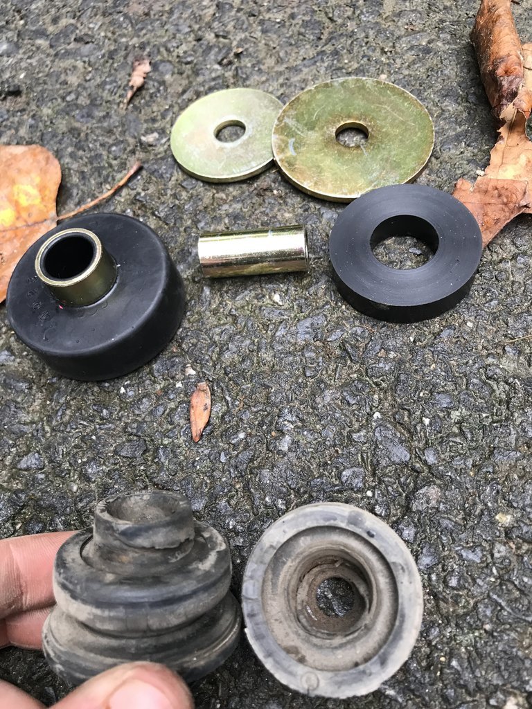

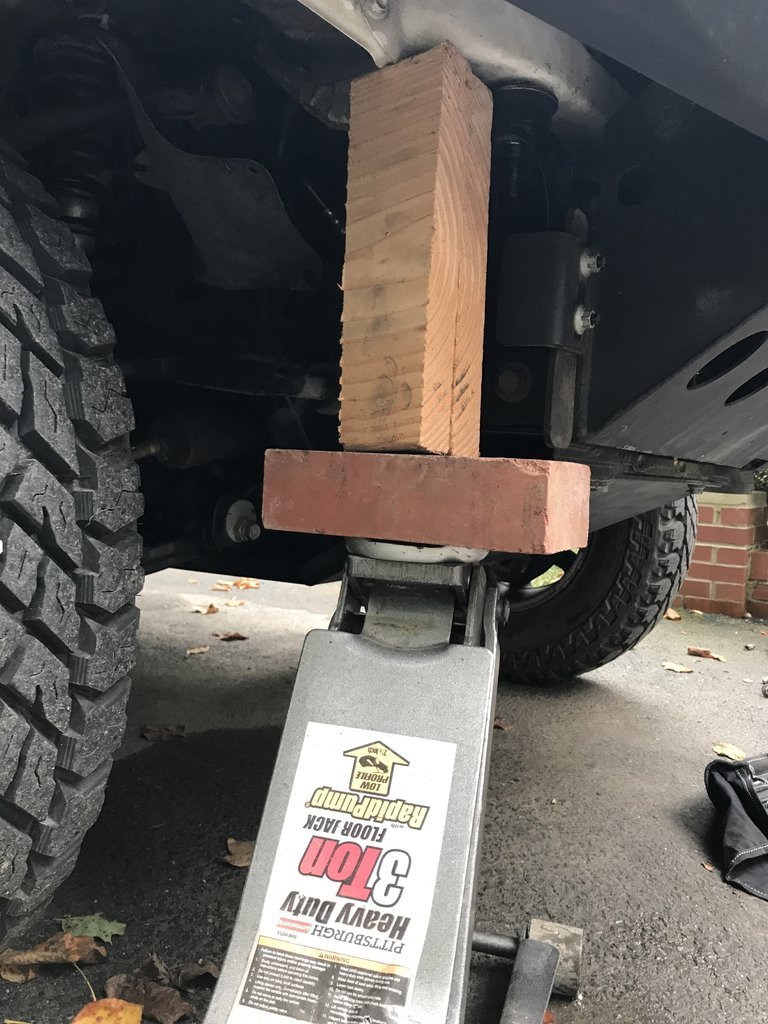

    I have been pulling my hair out for a couple weeks now on the rad mount install. I don't know why I am having so much trouble with it, but I have them installed the way everyone says to (thicc bushing on top) but now I have a thud/clunk which I didn't even have with my stock blown out bushings! After being installed for a week I decided to do an inspection. What I found was the washers are being damaged by the tube that's inserted into the big bushing. It's as if 34 ft-lbs is too much, and was bottoming out the tube to the washers? So i decided to re-install but this time with about 25 ft-lbs. But i still have a clunk/thud over bumps. I did also notice that it was pretty difficult to line up the frame to core support holes to get the bolt to drop down on the driver side, which I know means my fender is warped from the battery. After i let go with the pry bar I cannot simply push the bolts back up. Which tells me that that the clunk I'm hearing could be the bolts rubbing as they are misaligned in the holes. I might try to install the bushings I got in the 8.4109G kit because I honestly think they are a better design since the top bushing has a rubber protrusion that would insulate metal from rubbing on the frame perch holes, unlike the 9410 kit. I don't know, I need an outsider's view on my issue here. Picture is the washer from the lower bushing.
