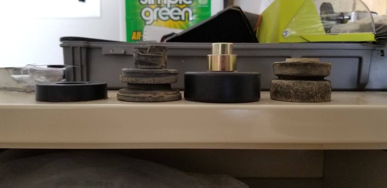

    Finally did mine. Small on top because I don't need anymore space between bumper and body. Used both washers. So far so good.
    Fun little tidbit: the larger bushing appears to be pretty similar in height to the OEM top bushing.
    Tops on left, bottoms on right.

    Just ordered this, will be here tuesday! Hoping it fixes my thud issue I'm having. I think it is shot on the passenger side and my bumper and fender are hitting pretty hard when I hit bumps while driving on the road
