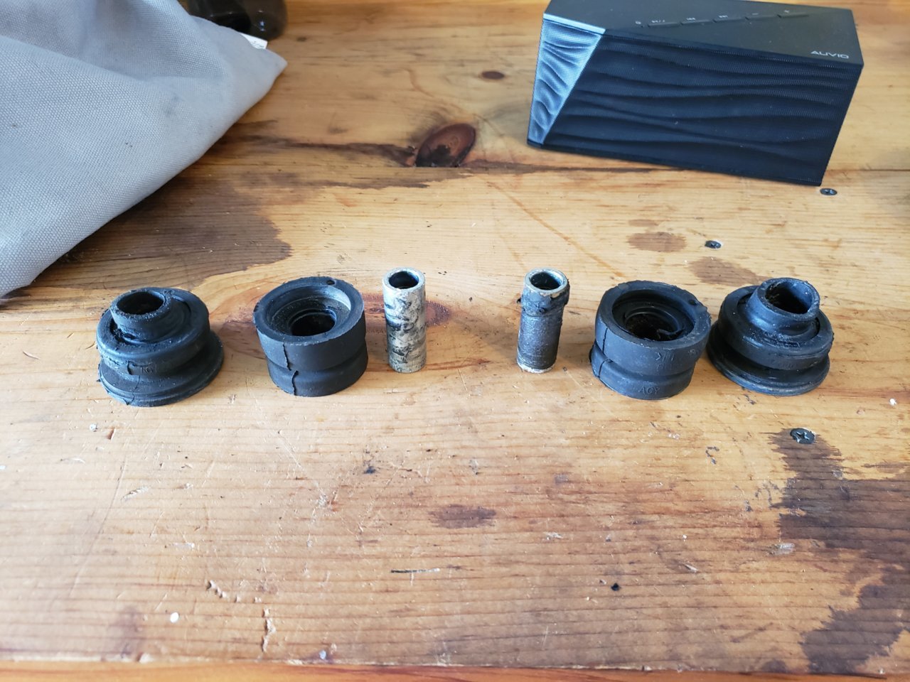

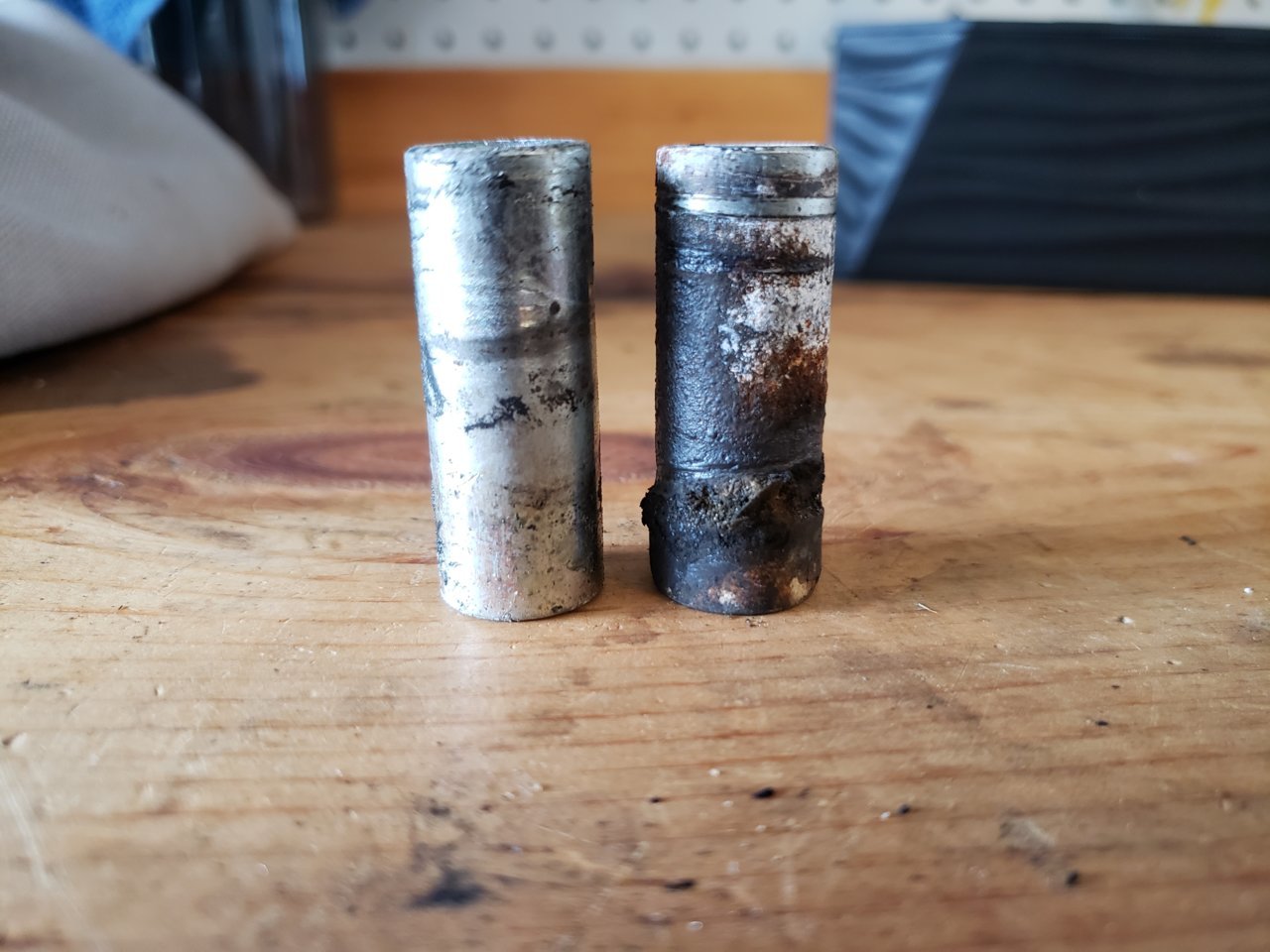

    The driver side was the hardest to line up, like everyone said. The factory bushing liner on the driver side was visibly bent.
    I put the small puck on top and large on the bottom. The driver side small washer was slipping off when compressed. So I flipped the top and bottom washer so they're flip flopped from the way its designed. But hey, it's a universal kit right?
