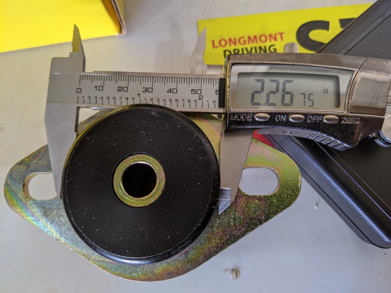

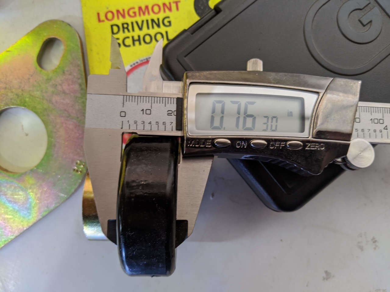

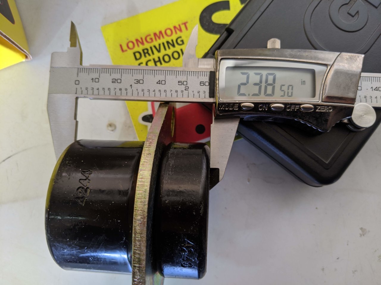

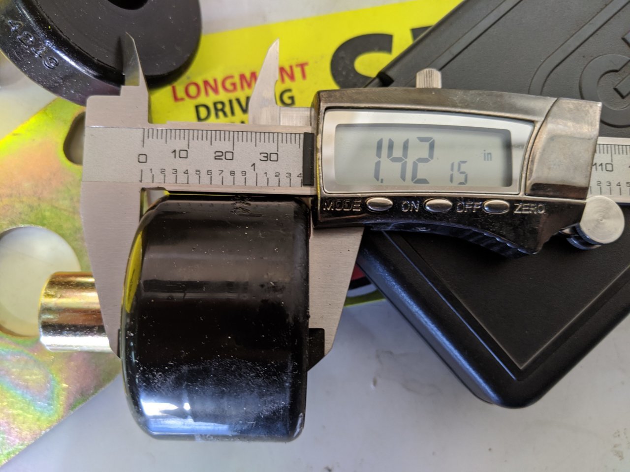

    Sorry James. I forgot about this.
    Then I had to find the bushings.
    Then I had to find this post.

    Thanks, based on those dims I think those would have been a better fit, that top one is about a half inch thicker than the 9.4101G, same diameter. But, without hearing back from Energy Suspension I would have needed to buy two full kits to get the three pairs I needed.

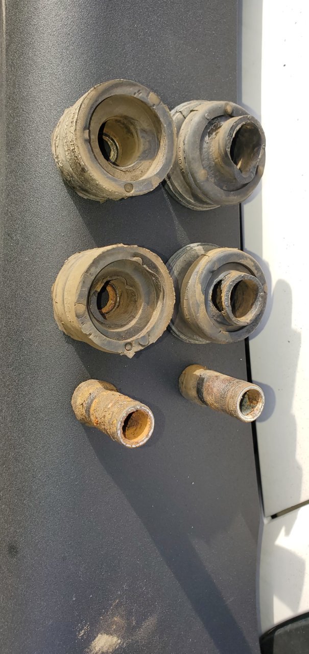

    106k on stock bushes. Been bad for about 30k. Such an easy procedure to change out, 10 mins per side.

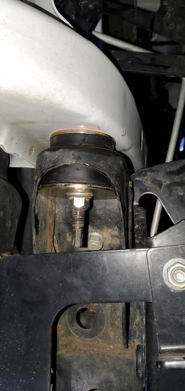

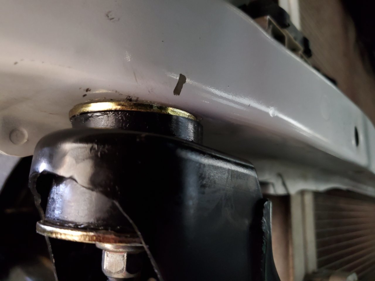

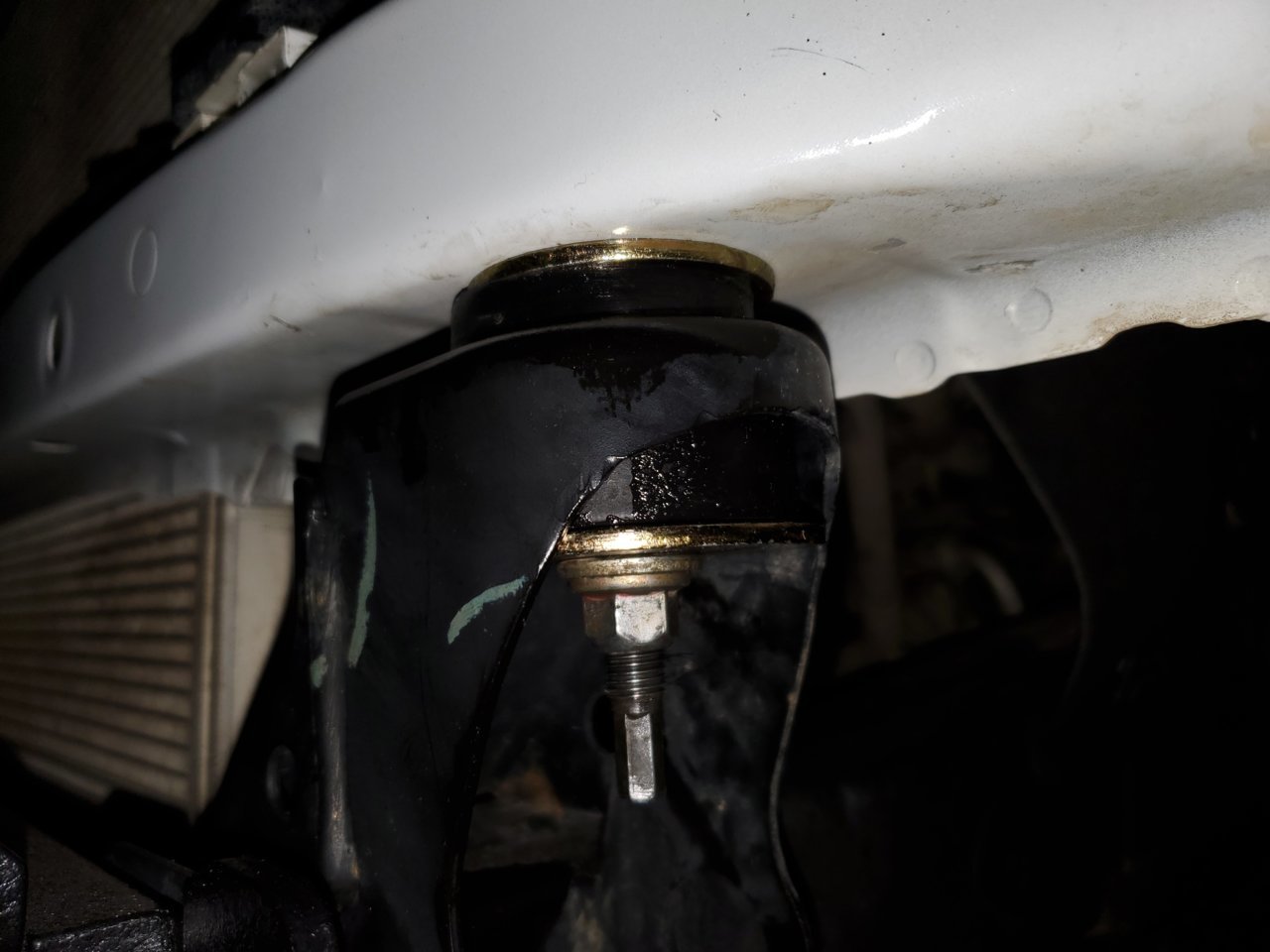

    Just installed mine, had trouble getting the top washers to sit even. I am going to see if they even out after some driving.
