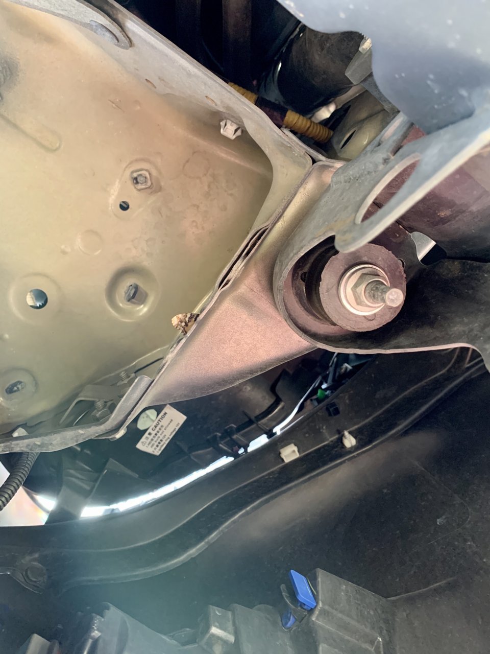

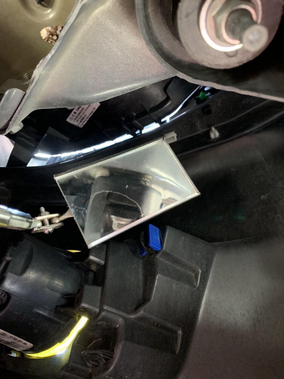

    Was planning on tackling replacing my bushings today. Just a couple quick questions first:
    1. This is the correct bushing to replace, right? Also, when jacking up the truck just enough to get the old bushings out/new bushings in... where is the best place to jack the truck up from? Can I just jack from the pinch weld right underneath that butterfly/moth wing or is that not strong enough? I assume it only needs to be lifted ever so slightly to take the pressure off the bushings.
    2. Here is a picture of my current (old) bushings, do they look bad enough to replace yet?

    hard to tell in your dirty mirror. Do they squeak or give you any other indication that they need to be replaced? Regardless, the majority of the "damage" that will be done is on the interior and won't be visible until you remove them.
    Yes, that is the correct one. I probably wouldn't lift it by the pinch weld, but I think I used the flat metal surface right next to it with a 2x2 piece of wood since the jack isn't that tall.

    Lol, the mirror itself is corroding away. They make no indication of needing to be replaced. No squeaks, clunks, etc. Thanks for the tip on where to lift the cab from.

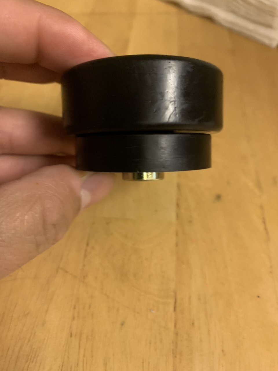

    Did anyone else put the large bushing on the bottom?

    pretty sure I put the large one on the bottom

    83A33B28-F40C-4BFC-A028-5B368AEDE5B2.jpg Just got my bushings in the other day. Before I start installing them, I just wanted to make sure I did install them correctly. I do have a plate bumper and just wanted to make sure that that thicker bushing with the washer was on top. I read though this thread with different responses.
