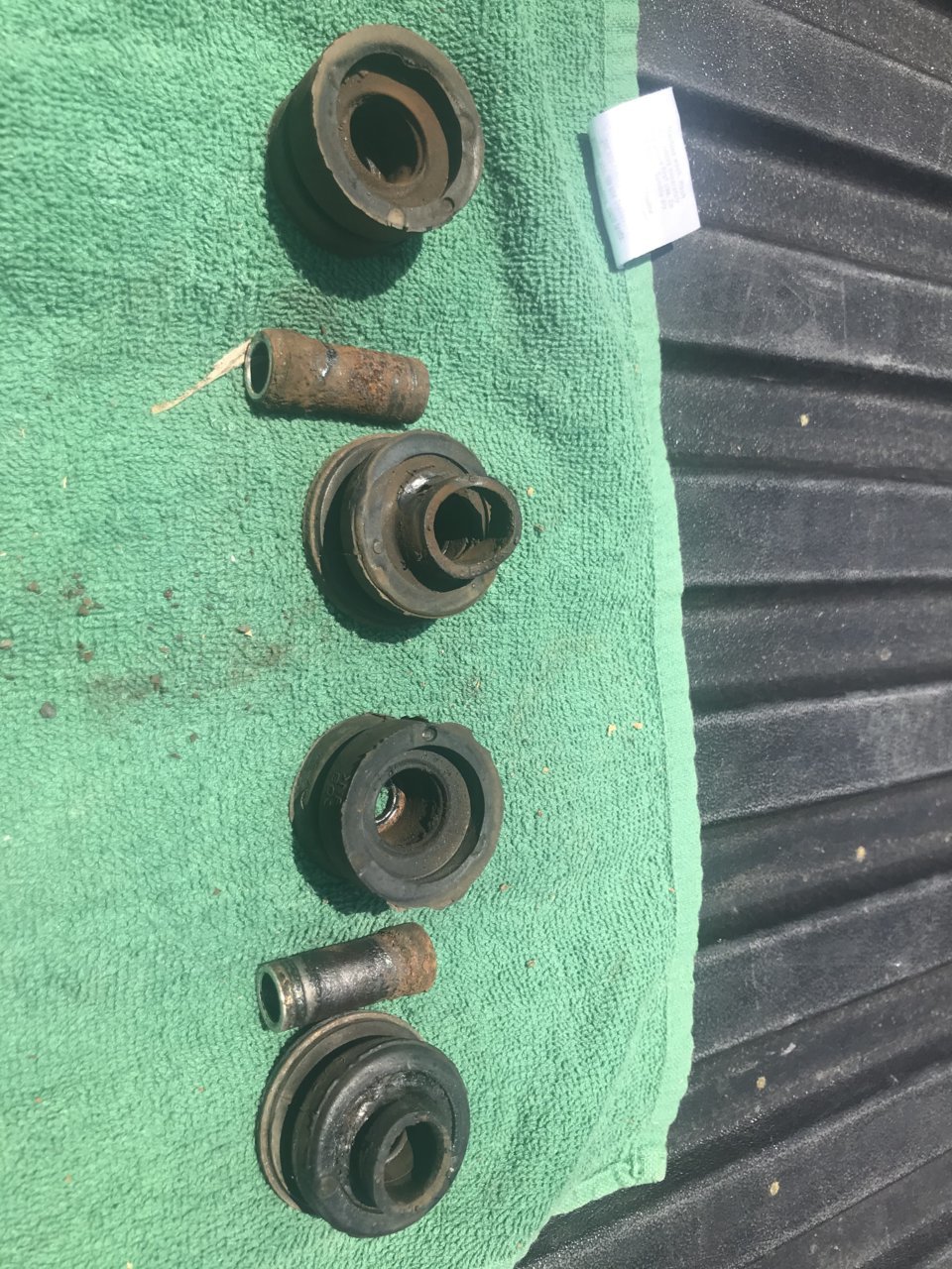

    Finally getting around to these tomorrow.
    Gonna go with small puck on the top + washer (oem bumper don't want the gap anywhere)
    Wish me Luck! I'll post before an afters tomorrow :thumbsup:

    All finished. Left is the drivers side and the right is the passenger side. Pretty straight forward to be honest and should have done it sooner. As others have mentioned the drivers side did take waaay longer. I started on the drivers side and had an issue with the bushing lining up to get the screw through. So after a while of frustration I moved onto the passenger side. It was cake. Once I removed the oem bushing and bolt I went back to the drivers side and that remedied the misalignment. Tightened that side went back to the passenger side fished there. All said and done it was about an hours work. Haven’t driven it yet so we’ll see how it feels. Hope this helps anyone still waiting to do it!
