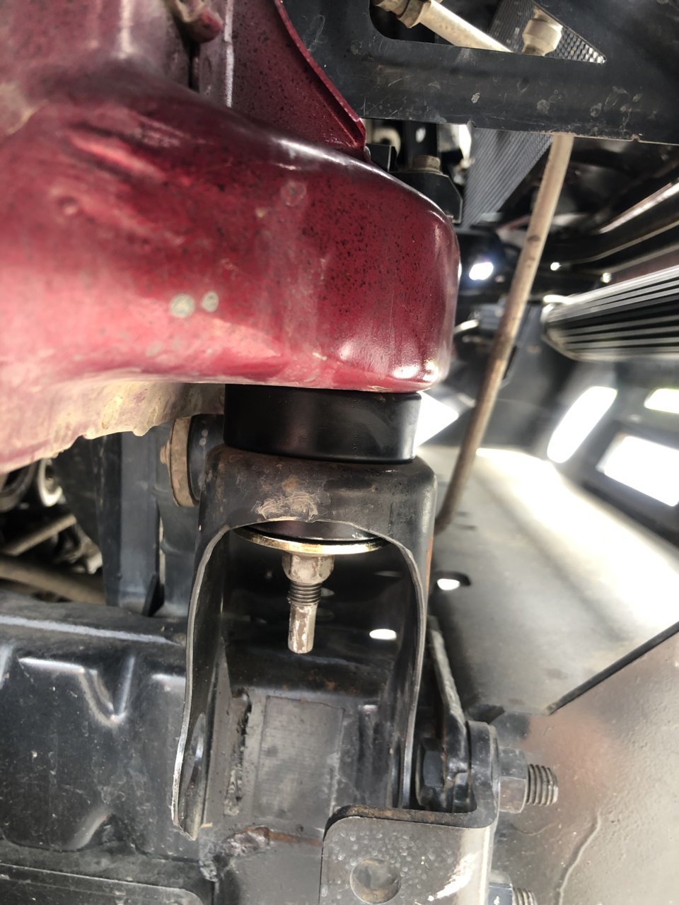

    Drives fine, got rid of the little squeak I had from the oem bushings, but my ocd doesn’t like the way the bushing is seated lol

    I just did this mod with the 9.4101G kit. First off I guess Im lucky and had 0 issues with the driver or passenger side lining up. Both went really quick and easy. However, I have an issue with these that Im not sure if Im
    being too picky about.
    So I decided to do the bigger bushing on the bottom and smaller in between so I didn’t mess the the bumper gap since Im running a stock bumper still. I like that these make the truck feel solid again... but almost too much cause of the durometer. I feel like Im driving a sports car now, I feel the road a lot more.
    I understand the other kit which is for the cab mounts as well are not as stiff which I like, but the surface area is smaller. Really wish they offered the 9.4101G kit with the “squishyness” of the other kit.

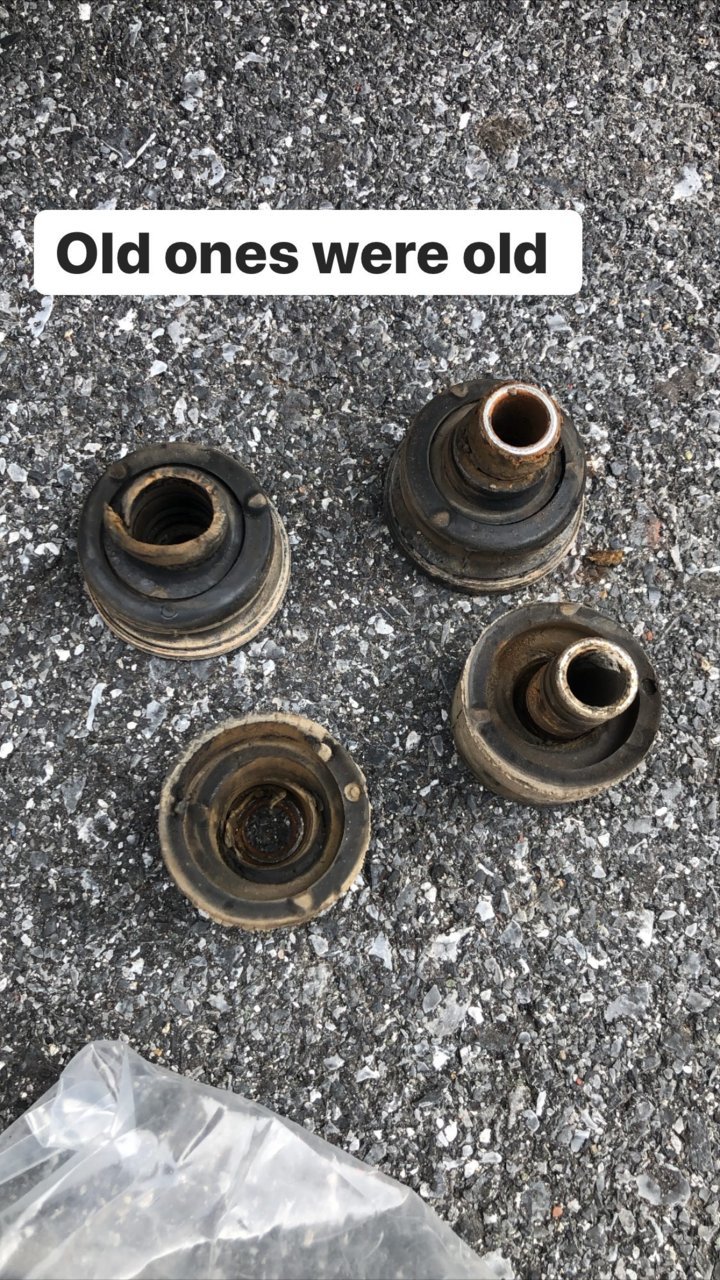

    I figured I would change the front bushings before I had any issues because I like doing preventative maintenance. My ‘19 has 12K miles and these were obviously shit already. Thanks OP. Great thread. DA6FBD4D-ED29-4F57-9D37-514F5CCD681D.jpg

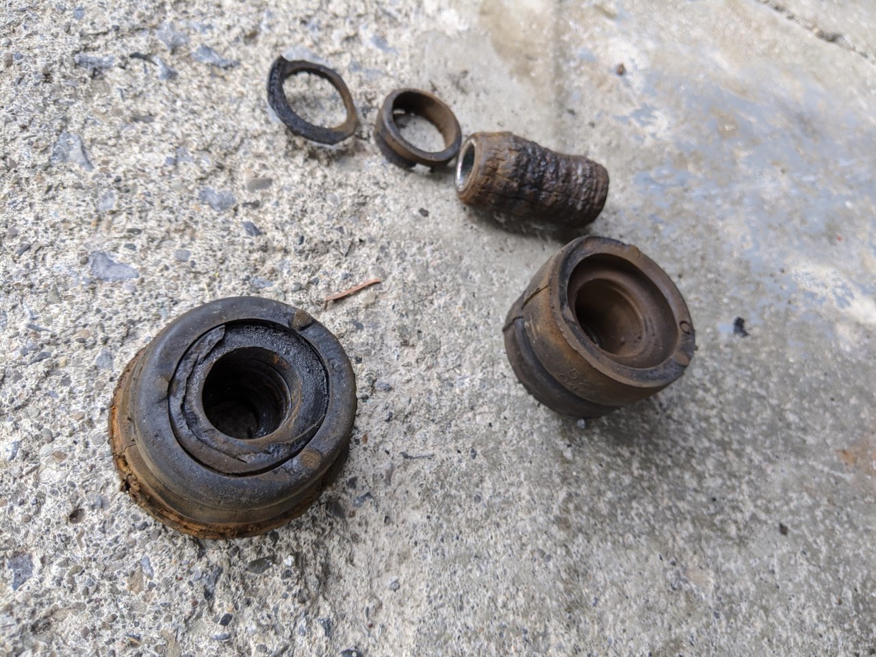

    something to be said about the bushings. I had a decent amount of miles over 100k (guessing I did mine around 140k) and I did more damage to them removing them than the truck had done in all those miles. So don't look at pictures of the destroyed bushings and think that they wore out that badly from use. They did wear out some over use, but probably not as bad as the pictures post-removal make them look.

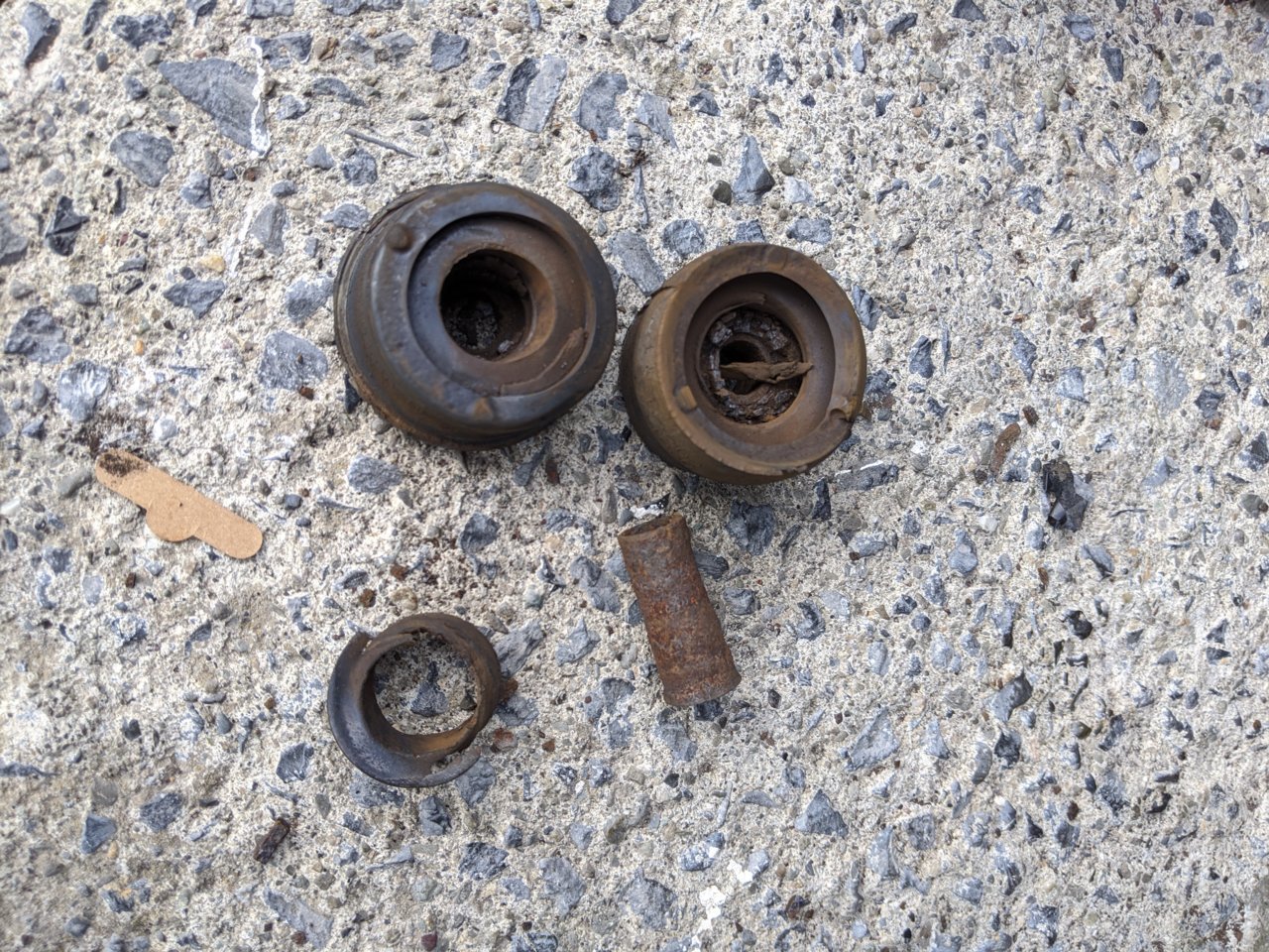

    Stumbled on this tread and now just order the radiator support bushings. I’m just over 200k miles and cab mounts are one of the few wear and tear parts I haven’t replaced. Curious to see the shape of the old ones.
