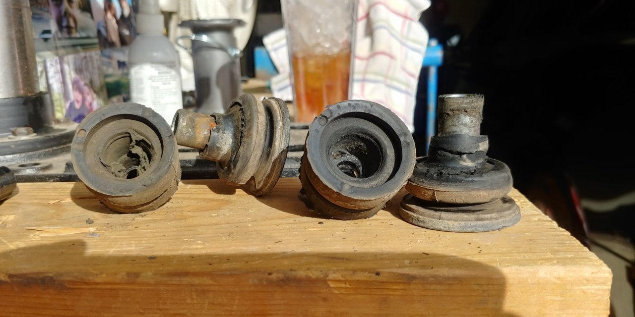

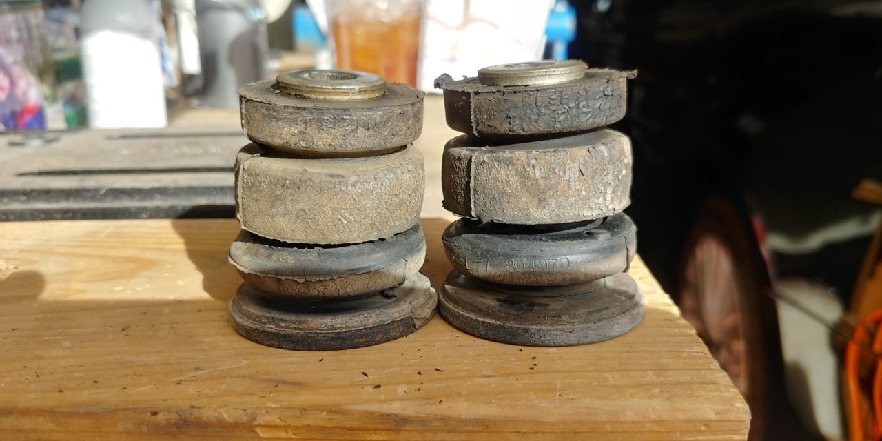

    I finally got around to doing mine. I was planning on using the smaller bushings on top but it was loose fitting before I even slid the bolt back in.

    can you just loosen the rad support to swap or do you need to also loosen the cab? I bought all but may just add the rad support for now. Debating on universal or the kit. I have both.

    I don’t remember, I think there is enough flex but at worst you would just need to loosen the front cab mounts a bit.

    No, you don’t. Steering coupler may need to be loosened though

    I did not need to any thing but pry the old ones out and pry the new ones in. I didn't remove the wheels or anything. I tried to use the jack method but I just ended up using a pry bar.
