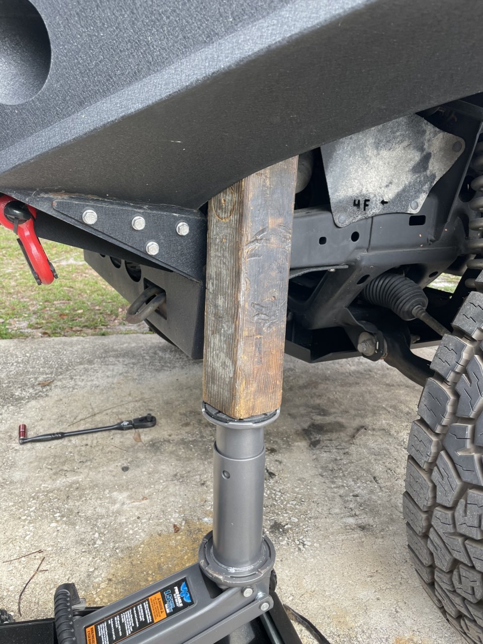

    Just wanted to jump in here real quick, I was hoping to knock out the radiator mount bushings tonight real quick before a offroad/camping trip to Joshua tree this weekend.
    Do I just need one jack to do the install? I assume the step by step process would be to take off the lower nuts, jack up the radiator support, pull out the old bushings, put in the new, then drop the radiator support and tighten it all back up?
    I don't really have a fully flat surface to work on since my driveway is jacked up asphalt on a hill and the truck doesn't fit in the garage, but I can get the front end in far enough to put the jack on a flat surface. Could anyone show exactly where they jacked up from as well? Just wanna make sure I do this right, safely, without damaging anything.

    I use two jacks just to lift the front end evenly, one per side.
    Grab you some 2x4s or 4x4s to brace from the jack up to the sheet metal of the core support, close to the bushings, if youre using a floor jack. Or crib under if using a bottle jack

    Got it, thanks from a fellow Zac(k)! I have a small floor jack and the bottle jack, so those should work. Hope to have some good news to report to you guys tomorrow haha

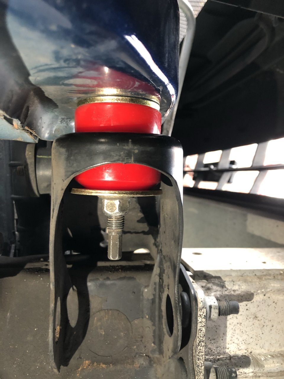

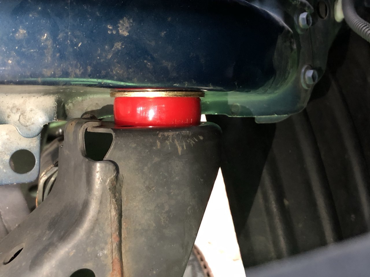

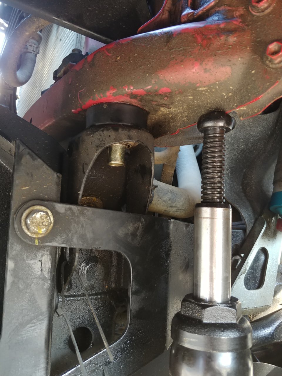

    Installed the radiator support bushings this afternoon. 15 minutes for the passenger side, 30 for the driver's side. Used a crow bar to pry it apart and remove/install the bushings.
    The oem ones weren't that bad imo. Truck has 156k on it. Haven't driven it around yet, but hoping it helps solve that knocking sound I had.
    At some point I'll swap the passenger side washers. I didn't realize they send two different sizes for these. I just grabbed them out of the box as I was going. So right now the smaller one is on top and larger on the bottom on the passenger side and larger on top and smaller on bottom for driver side. Maybe it's a good experiment lol

    Interesting you did one side different than the other. Can you see any difference in the gaps of the bumper or fender etc. What kind of noise were you getting and any improvement?
  15. Feb 24, 2021 at 4:25 AM
    #1455
    Chris(NJ)
    Chris(NJ) Well-Known Member
    Jan 21, 2010
    #29777
    5,052
    Usually in Central Jersey
    08 Indigo 4x4 DC OR
    Mods are currently being changed .....
    Well, it wasn't intentional :rofl:
    No difference in height. The washers are the same thickness. Only the diameter is different. You can see it in the pictures if you look at the washers on the top. One barely meets the edge of the upper bushing, the other hangs slightly over it.
    As for fender gaps, it's either the same or barely larger than before. I used the 8.4 kit so I installed the bushings as recommended. I dont notice a difference in body panel gaps.
    I was (am?) getting a hollow/deep knocking noise, mostly when going around turns. Almost sounds like it'd be from a ball joint or axle. But everything is recently replaced. I haven't driven the truck to see if the bushings stopped the knocking. It's not always easy to replicate. I've heard that it's a possibility so keeping my fingers crossed.
    I'm going to change out the wheel bearings either thursday or friday. I have some other concerning noises that I'm trying to get rid of at the same time. So hopefully I can drive it around this weekend and report back.
