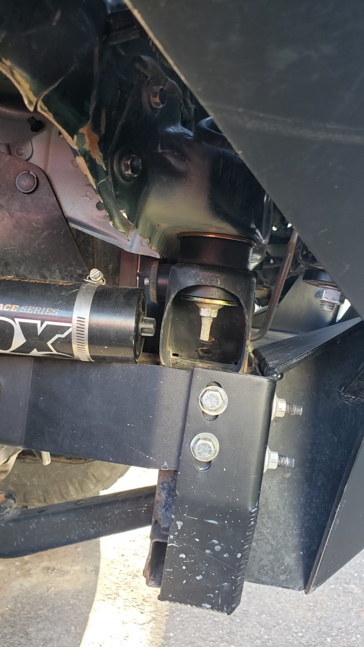

    Screenshot_20210512-195528_Gallery.jpg 20210512_182435.jpgfinally got them installed. They are really loud im guessing my frame to body mount is just bend so bad that they can't lay flat. I'm going to have to look at it again when I have time lol

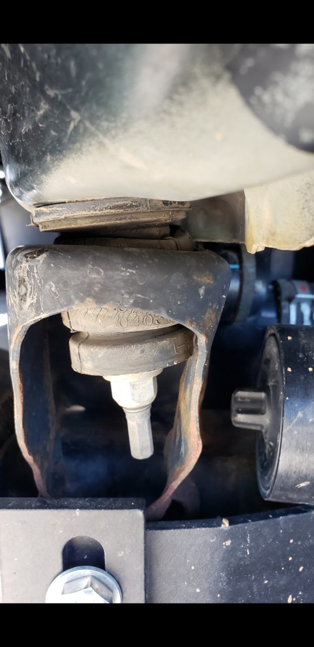

    43396C6A-344C-4212-B605-E3D0538F1B0A.jpg Ran into this issue, driver side bolt is not centered, and ideas how I can fix this?

    That’s probably just from not being on a flat surface and then lift just part of the cab

    I jacked up the track and I was able to fit the bushing, thanks
