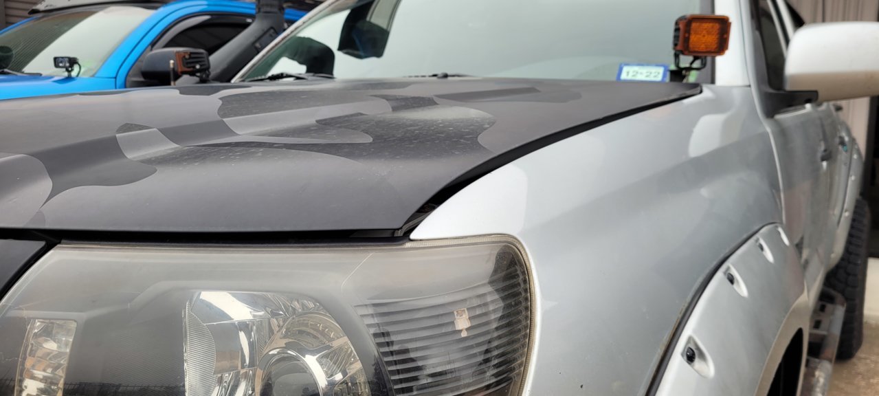

    Here's the hood gap
  11. Feb 24, 2022 at 1:32 PM
    #1491
    hoarder23
    hoarder23 Truck fell over
    Aug 14, 2012
    #84787
    12,887
    Shay
    NJ
    15 Pyrite Mica DCSB Sport
    Scratches
    You can adjust the height with the rubber bumper on the hood corners
    SR-71A likes this.
  12. Feb 24, 2022 at 1:38 PM
    #1492
    will.i.was
    will.i.was Well-Known Member
    May 6, 2018
    #252688
    1,722
    Will
    Houston, Texas
    SC 2.5
    It's adjusted where the rubber is all the way as far as it can go into the hood lol I'm sure I tweaked it :burnrubber:

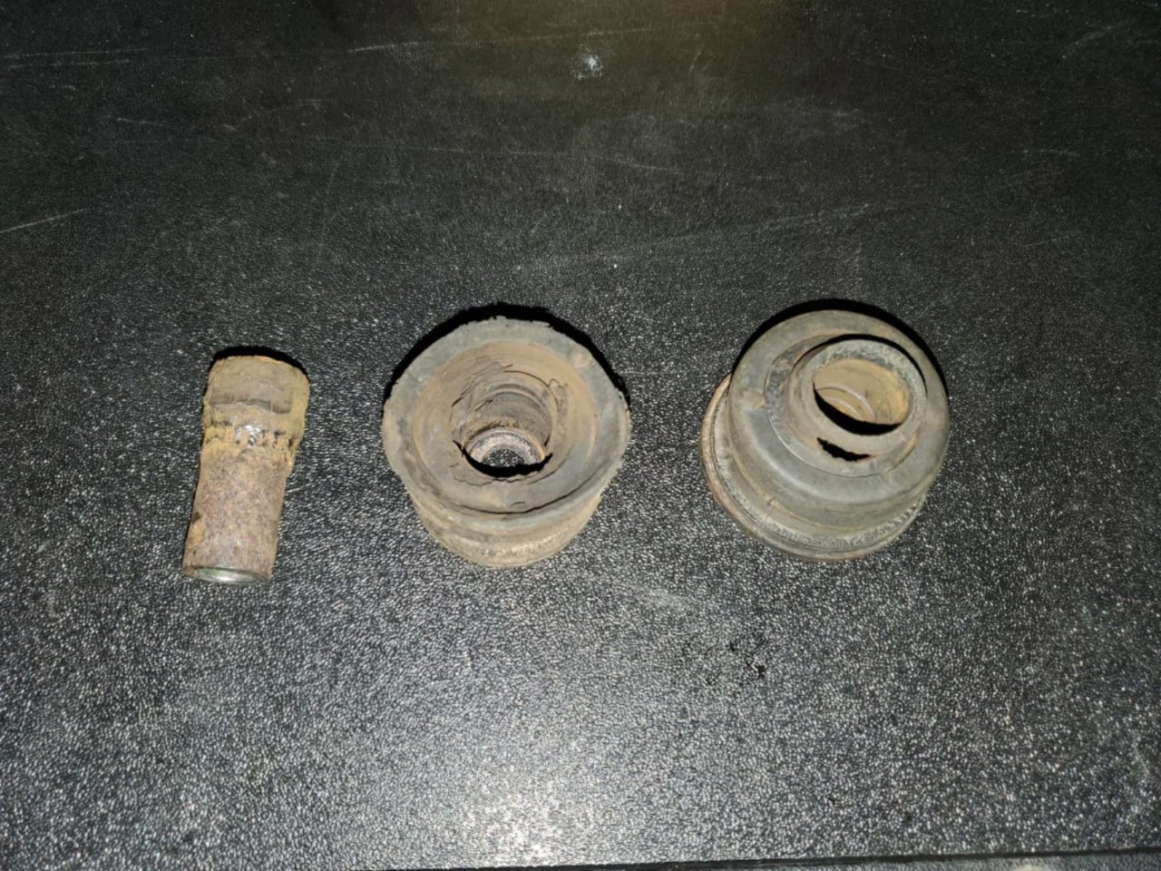

    Hey.
    Sooo, my passenger side bolt is seized in the sleeve... Afraid to torch it, will have to cut it out. I understand that generic part number is 52217, but can't find the specific one for radiator support bolt (not sure if they're different length than other ones).
    Anyone has a proper part number for that specific bolt? Or maybe a link to am_zon for a replacement?
    Edit
    My driver side bushing
