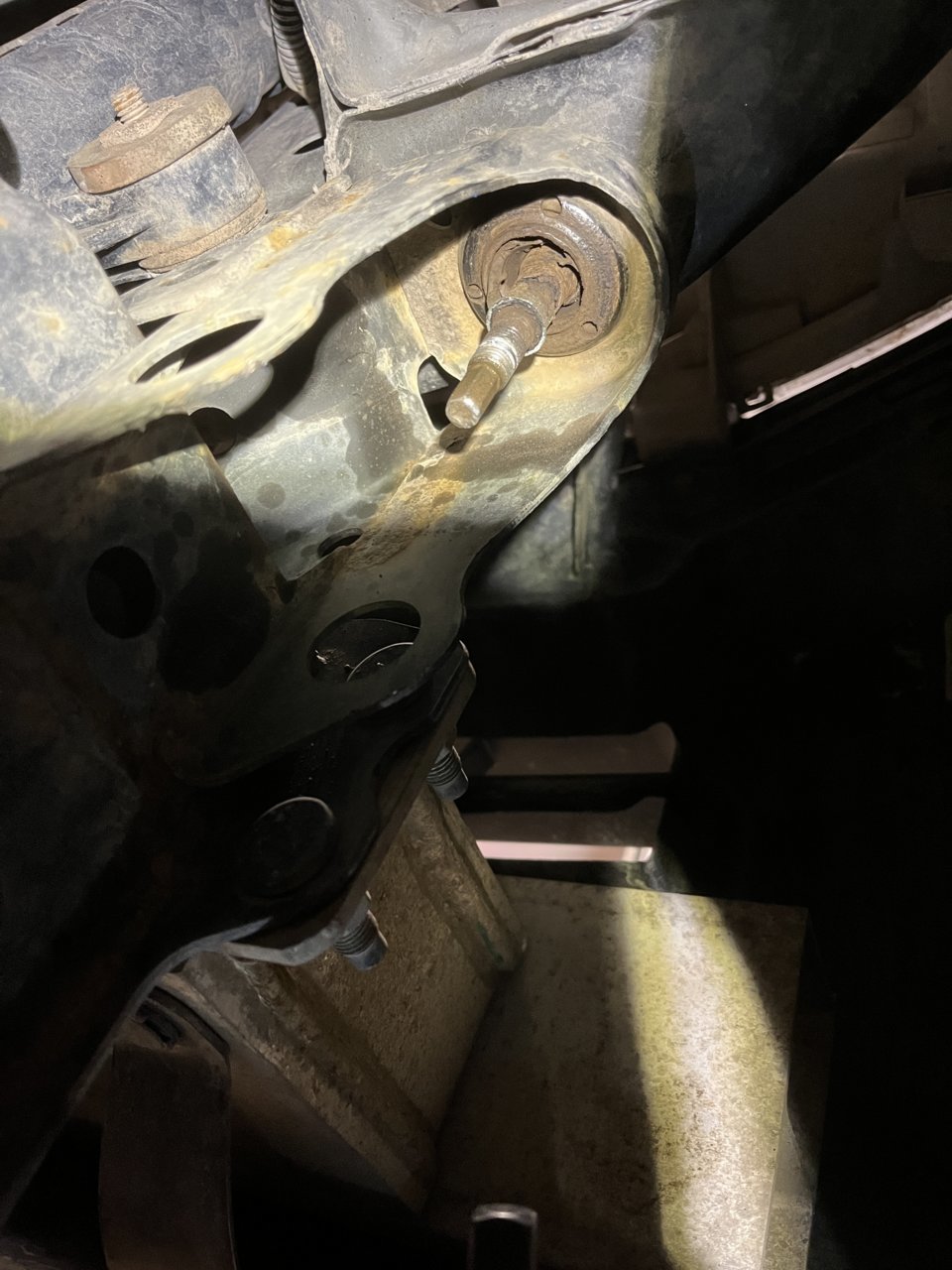

    Hi everyone, I tried swapping out my rad bushings today, specifically the driver side but when I went to lift the frame it felt like it was getting caught on something so I stopped. I managed to get the oem one out and it was torn…bought these Energy Suspension part #9.4101G and I couldn’t lift the frame high enough to get the top puck to fit…has anyone else had a similar experience?

    I recall being uncomfortable how much I had to lift the front of the core support to get the new ones in. A light coat of grease will help the new bushings slide in.

    It's been a long time since I did this but I definitely remember some prying/cussing/beering going on.

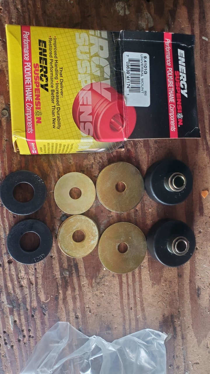

    So, tried installing the universal kit yesterday afternoon… Did not go well.
    I loosened both sides and used a block of wood and the bottle jack to lift the body. Started on the DS and got the old bushing out and inserted thicker puck bushing and washer - No issues.
    Went to drop the bolt in and it didn’t line up. Pulled, pushed, pried, and cussed and finally got it to drop down a little.
    Success! So I thought… I went to insert the inner sleeve and lower bushing and the inner sleeve does not fit in the upper bushing! Double check the set that was supposed to go in the passenger side and nope… Not even close!
    I think Energy may have supplied the inner sleeve for the truck specific bushings in my universal kit.
    Moral of the story, double check everything fits together out of the box before trying to install!

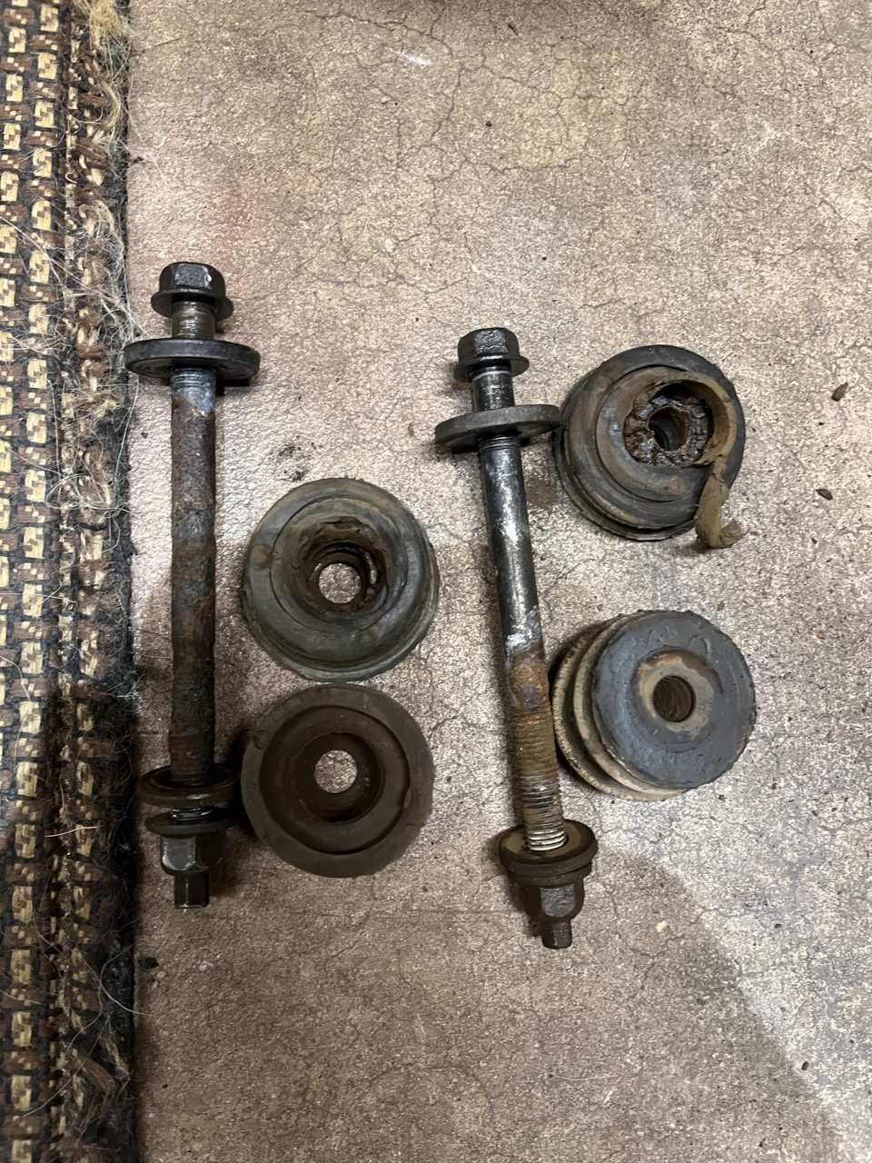

    I installed the universal isolator 9.4101 to replace my completely seized/disintegrated stock ones the other day. I was a bit shocked at how bad they could get. Had to use an extension to whack one of them out. I used one of the front cab body mount bolts (52217-04040) and accompanying nut (90177-A0012) I ordered to replace the mangled and rusted old bolt. I would have used the other one too but for whatever reason the holes in the body appeared to be different sizes and I had to reuse the better of the two original bolts which fit loosely in the new energy suspension sleeve. Anybody else have a similar experience? I am considering going back in and drilling out the body hole larger to fit a new larger diameter bolt like I was able to use on the passenger side.
    This was one of my fun 200k miles celebration maintenance things.
