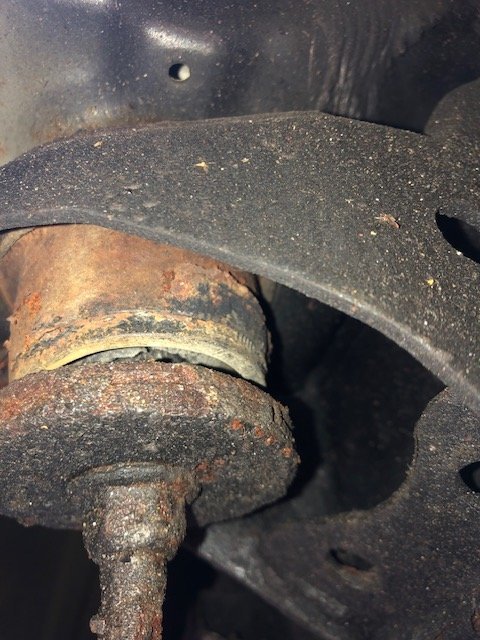

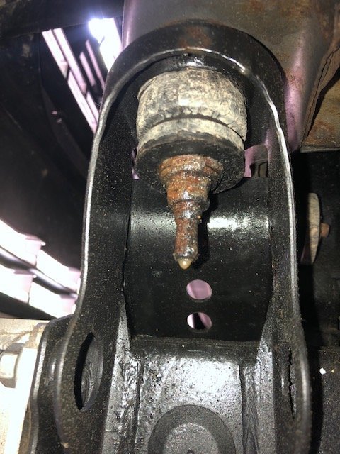

    I'm always looking for upgrades to do and thinking this on will placate the masochists in me. I don't have any symptoms such as the clunk described but am thinking my bushings are toast. thoughts? NE truck so I went ahead and ordered new hardware thinking I'll just be cutting out the old bolts instead of wasting time battling them. Is there logic behind why you only replaced the front rad bushing and not the cab mounts?

    I was getting a clunk over speed bumps, mine didn’t look terrible from the outside but they were disintegrated on the inside and the bolt sleeve was completely separated from the bushing, which I believe was causing the issue with severe bumps. I only have 78k miles on my truck, so I don’t think it needs all the cab mounts, nor did I feel like doing them in the parking lot on my back.
