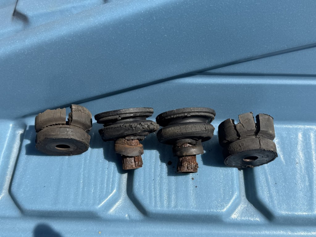

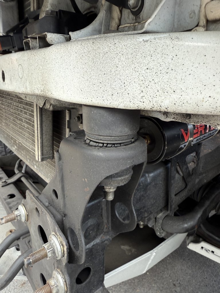

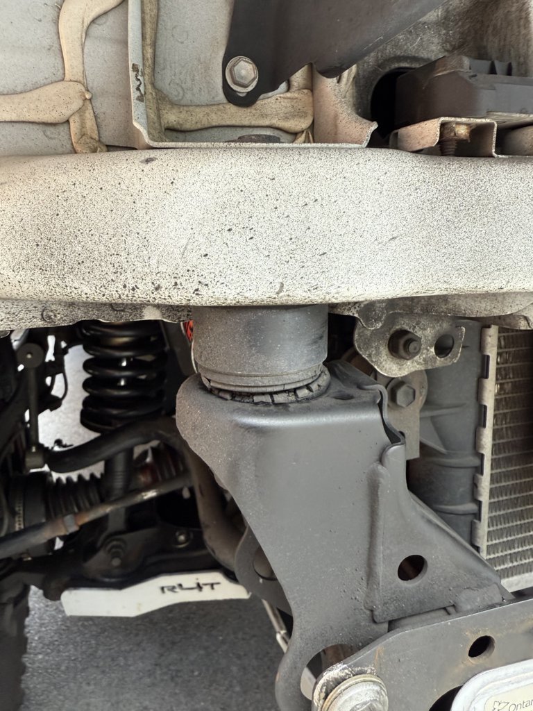

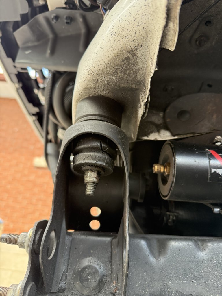

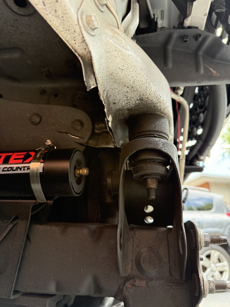

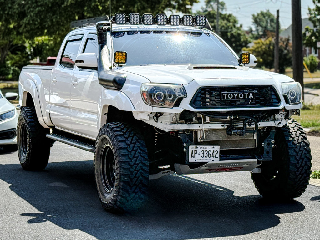

    Safe to say they are due, this is with a body lift. Would be nice to gain some slight clearance in the front wheel well.

    Keep an eye on your sub frame. Mine started to Crack after I installed these. Went back to oem ones and the cracks haven't progressed.

    Do I need to loosen both rad bushings before lifting and replacing them?

    You'll need to loosen the "middle" cab bolts or the ones at the very front of the cab as well. Then again the body lift might make it trickier as im sure youll require new hardware. Measure it up. Get some zinc grade 8 properly shanked hardware and some oversied washers or a welder bc those mounts are terribly toasted...

    My front cab mounts were replaced 3 years ago with a cab mount relocation kit, new bushings and mounts.
    So I should loosen the front cab mounts as well, is what you’re saying?

    Tried to use the bigger bushing on top but the hood wouldn’t close, I’m sure the body lift puck wasn’t helping.
    Gained close to inch on my front end.

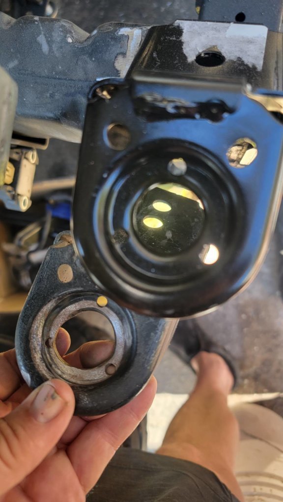

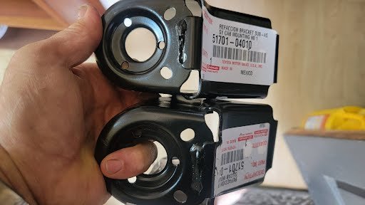

    I replaced part of my frame to since the holes were now ovals.

    I had no idea they sold pieces of the frame like that for our trucks.

    Same.. Assuming its part of a repair procedure for a moderate front end collision?

    That's most likely the case. It's actually good to know for future references! Then again, I believe you can purchase the entire radiator support bulkhead from Toyota as well if you get into a collision. Of course no one except a body shop is most likely going to do that because of the intensive labor it takes to replace it, but it is always good to offer that stuff on behalf of the manufacturer for sure.

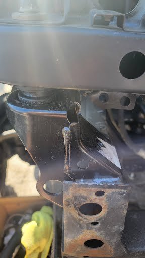

    I am in the middle of replacing my core support with a new one but not before I reinforced it with 3/16" hot rolled steel rod to 'cure' all the weak points.
    Not an easy job but like brain surgery, if broken down to small enough increments, it can be done at home. :)
    c430aa122915405ad67dbac3c33526b472c39df9-1.jpg 8adbe91803db49b9377317c89364a41117d974d7-1.jpg rad support 3.jpg 20250608_114516.jpg 20250608_115223.jpg 20250604_153926.jpg 20250710_123130.jpg
    Both outside radius and inside radius. Won't crack this time. :)
