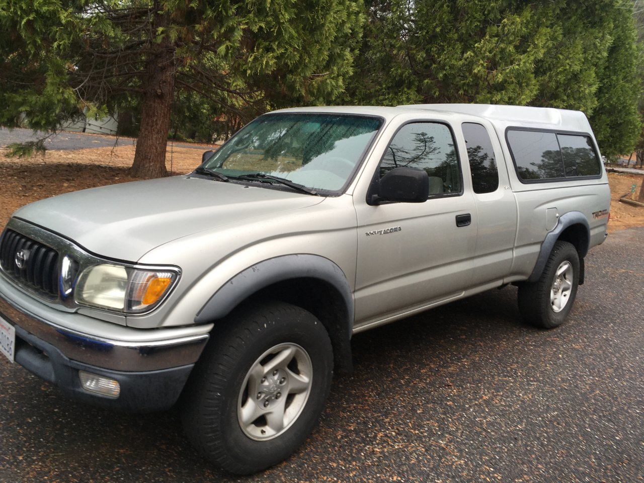

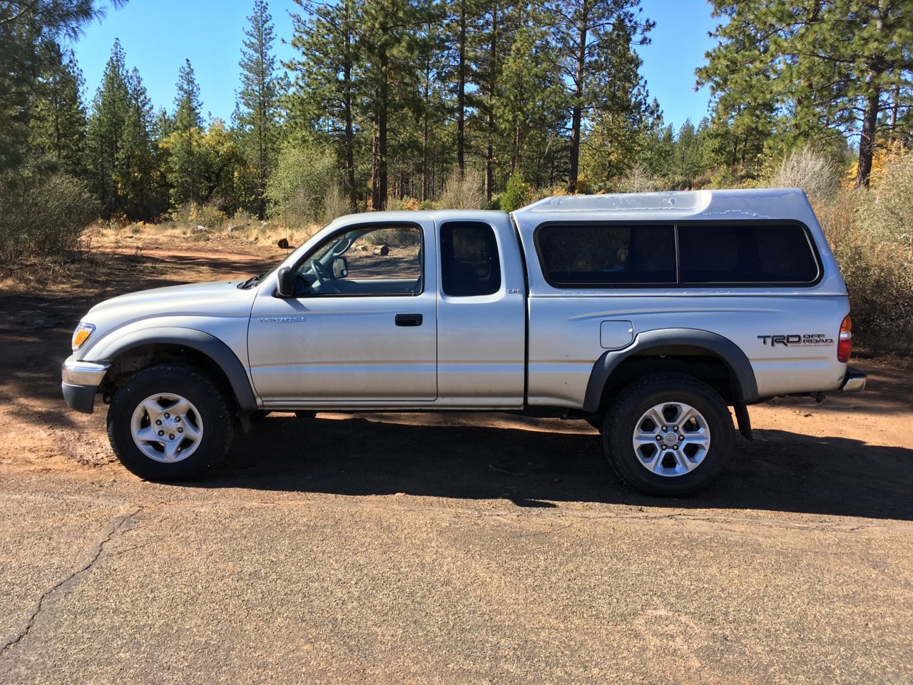

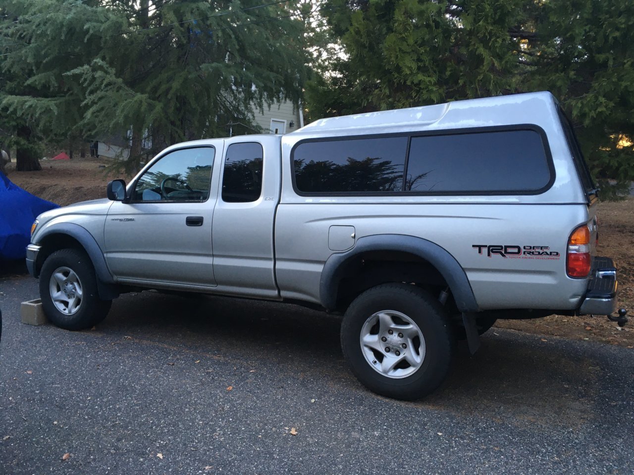

    5ACB83A0-FBFA-4176-8514-D006C7C3C878.jpg 7623AE6F-01AF-431B-943D-CF831076BC1D.jpg So recently I decided it was time to spruce up my trusty '01. I bought it new and it now has around 250,000 miles on it. Still all original except for maintenance like the timing belt and clutch. The 3.4 still runs like a top. The suspension is just a little worn out. Actually it was a little worn out years ago, now it just shimmys and shakes down the highway so it's way past time for a rebuild. Since I'm going to have it all apart anyways I'm going to go ahead and lift it a bit and set it up for back country camping and exploring here in the Sierra and the rest of the amazing West.
    Plans call for a 2-3" lift with Bilstien 5100s/OME 883s up front and a Toytec AAL with Rough Country shocks out back. I'll drive this for a few years and then decide where to go next with the suspension. JBA UCAs. New bushings, tie rod ends, ball joints, etc. New wheel bearings. Tundra brakes. Braided brake hoses. I'm going to drive on some 32s a bit and see if I want to regear to 4.56. If I do I'll likely put in a front ARB locker at the same time. Planning on some late model 4Runner wheels with 275/70-17 tires for 32.2". I may bump up to 275/80s in the future for 33".
    I'll be putting on a TJM plate front bumper from my 3rd gen 4Runner, Smittybuilt X2O 12,000 lb winch, Savage Offroad skid plates, sliders and a tube rear bumper (or home brew) with swingout.
    Also planning to have onboard air, 12v fridge, solar, and various other overlanding accoutrements.

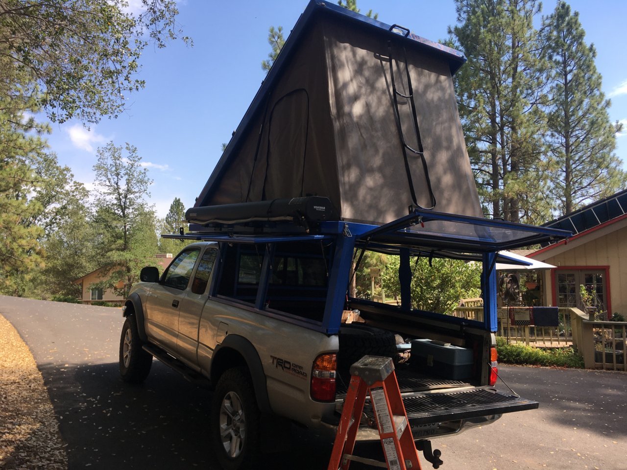

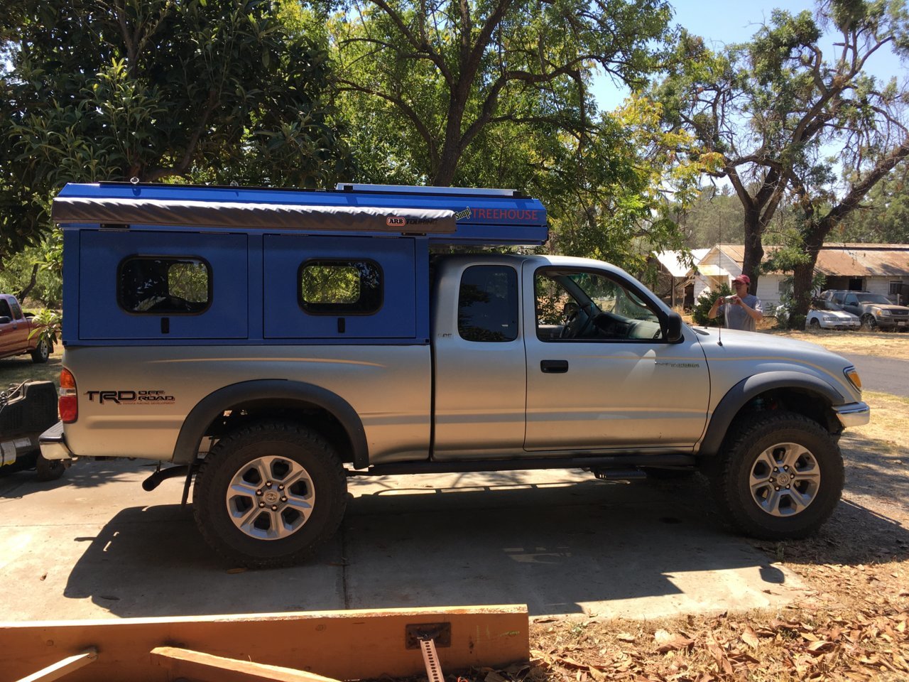

    I'm also planning to build a popup camper shell to camp in. Mixing details of both of these:
    https://gofastcampers.com/
    https://campovrlnd.com/
    The plan is to do something like this:
    https://www.flickr.com/photos/149794382@N06/albums/72157706051859295/page4/
    but modify it to have a full popup and rear barn doors like the OVRLND. If I don't wind up having time I'll probably buy one but it would be fun to build it myself.

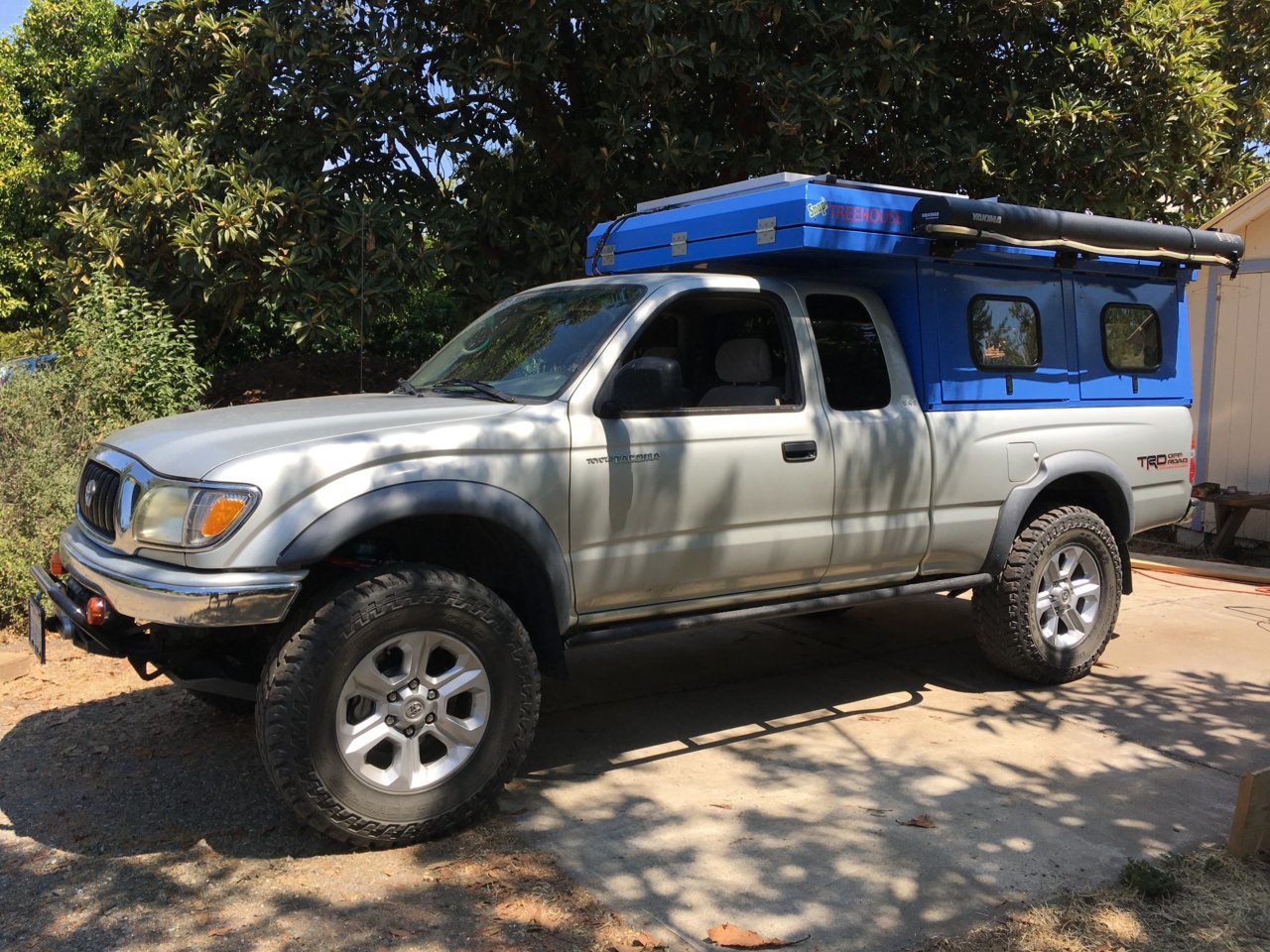

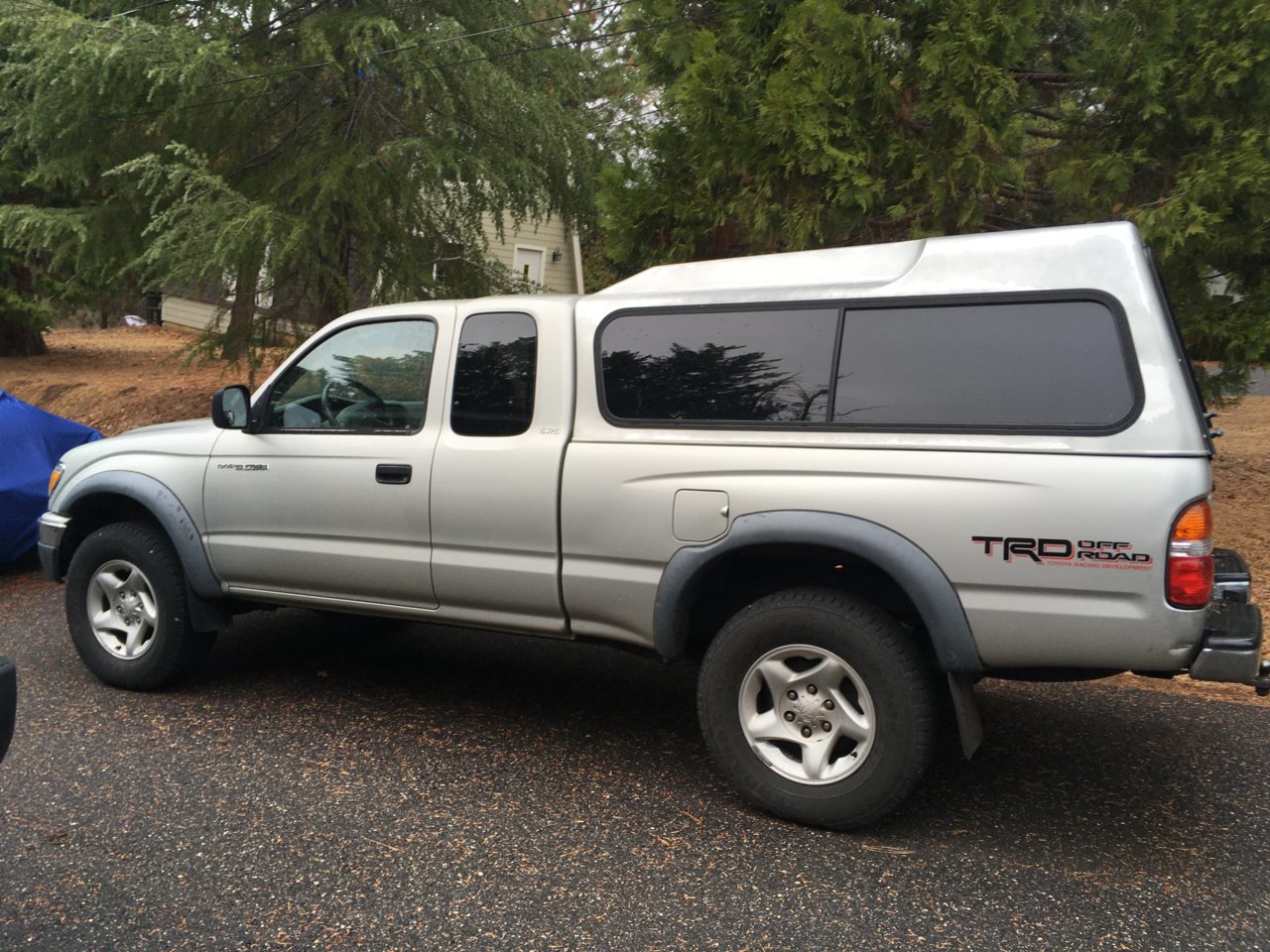

    F96F5566-4A16-4437-9AC1-BA92EFFF12CF.jpg I installed the AALs and rear shocks this afternoon. Gained about 3". I think the AALs were rated for 2" but my original springs were sagging pretty bad.

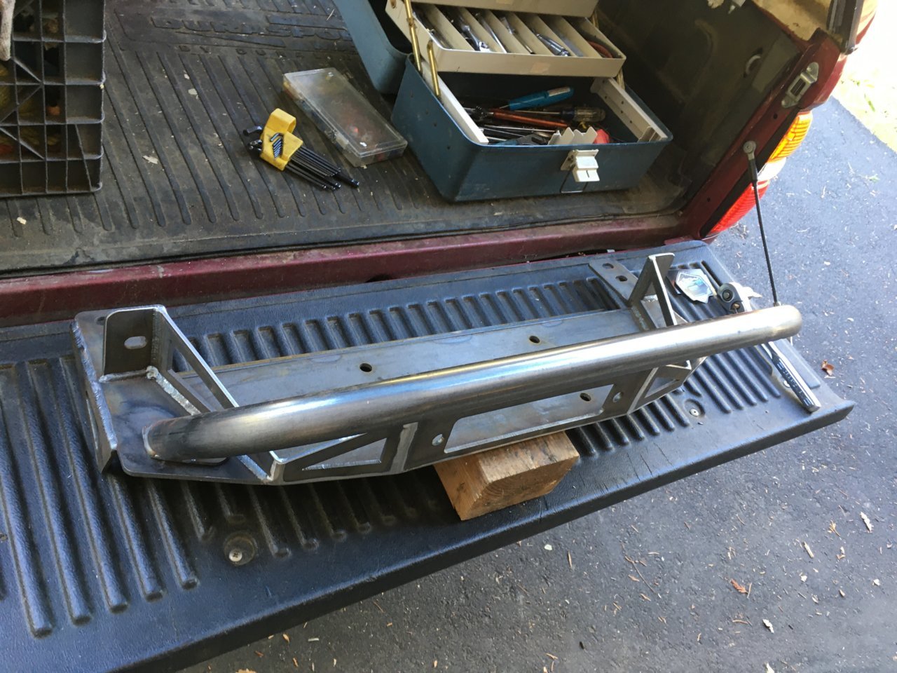

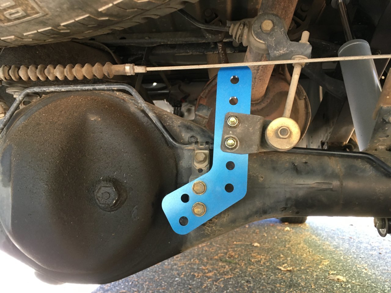

    F9E7D1A9-8111-4BF3-8B5E-168C1CE9A2CD.jpg E66A8258-3F13-4EB2-A141-4351084F2611.jpg Things just got crazy at work so I won't have much time to work on my truck for a while. But more overtime means more $$ for the build. :thumbsup:
    I got the rear AALs installed and gained about 3". They are only rated to 2 1/2" I think but the original springs have sagged. Also got some 2019 4Runner rims so I can run a 275/70-17. They currently have 265s which are fine until I buy new tires.
    Also got the BAMF BPV bracket installed. That made a great improvement in the brakes!

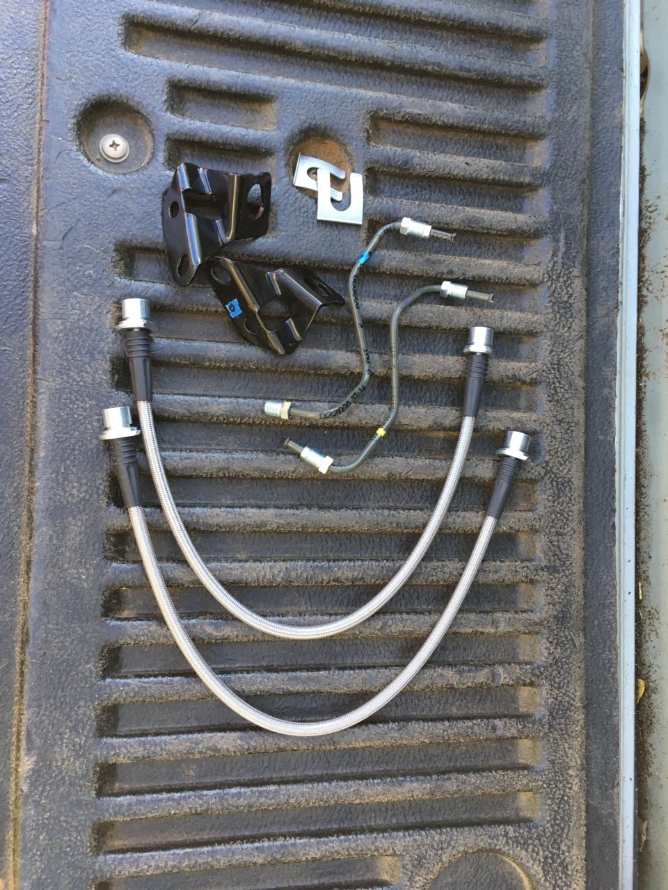

    99118161-2956-4E5A-93C6-F6B72F83C41C.jpg Parts have been rolling in. I received my Tundra brake line kit from @turbodb
    What a great kit! Shipping was super fast. My build is going super slow so far though.

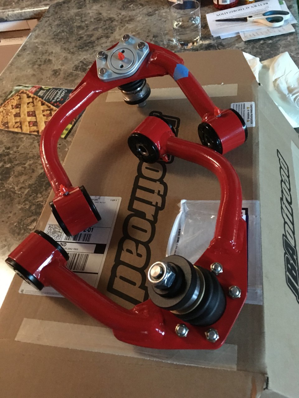

    7E51A5B1-BA42-4C47-87FE-AD07D25E2B9A.jpg I got my JBA upper control arms and they look great. Can’t wait to mount them up!

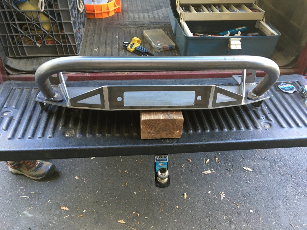

    AF2C3FD6-3613-48C2-99E0-17273E5456E9.jpg 803FAA8F-F4C9-42AC-918C-8700DA1C9142.jpg BB9D0E30-C4AA-4757-971D-386B85263608.jpg I decided to go with a hidden winch mount on this one for now. I got the one from Amp’d Up with a bull bar and it’s pretty nice. I’ll get it painted soon and hopefully mounted too.

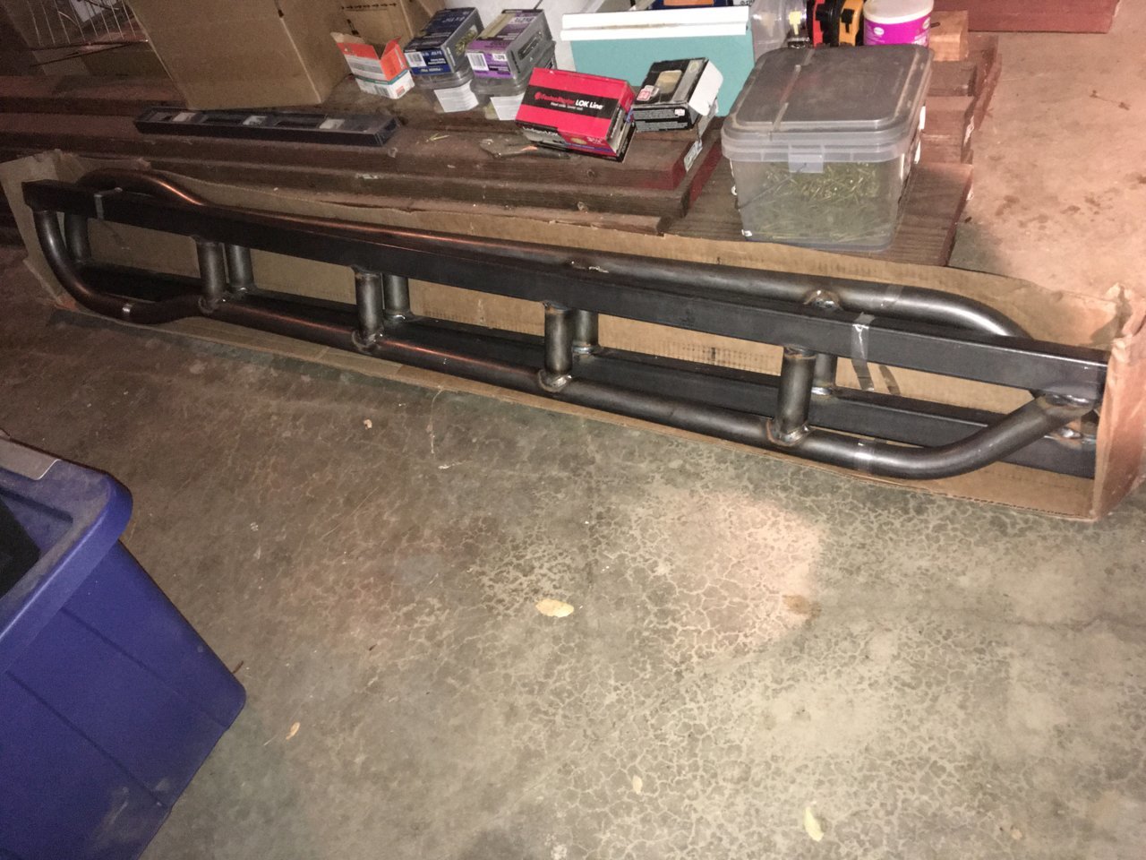

    885D745C-338B-4D40-BE60-BB511B6B66B7.jpg Also my 4x Innovations rock sliders. They are the DOM with kickout and square main tube. They look pretty sweet and super stout!

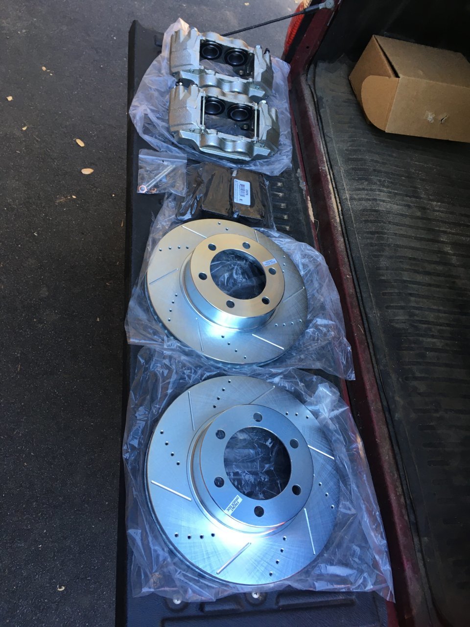

    And my Tundra brake kit.

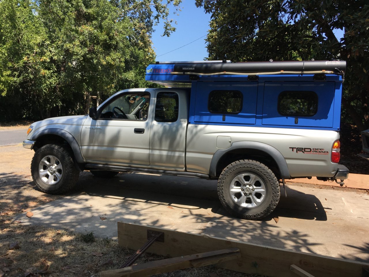

    Wow, it's been a year since I updated my build thread! I've gotten a lot done to the truck. I've got the 3" lift done, tundra brakes, winch, rock sliders, aluminum skids, etc. I also came across a deal on a very lightly used Snap Outfitter's Tree House pop-up camper. I'll go through my phone and try to find pics of everything to update this thread but here's how the truck is looking these days.
    I'm pretty happy with the progress so far. It's geared too high now with 4.10s and 33s. With the 5spd I can downshift no problem but it's still a dog on the hills around here. I'm thinking 4.56s might be the ticket. Opinions on gears? The rear axle seals are starting to weep so it's a good time to get it all done, gears, bearings, seals.
