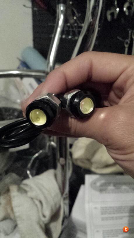

    Icons came in

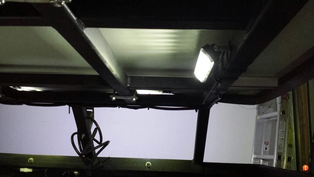

    Finally figured out what I'm going to do with the rear bed/rack lights. picked of 8 of these do dads. Two are going in my fron wheel wells to finish the rock lights. The other six are going on and around the bed rack with the final blitz pro shining down on the bed.
    After that just have one more light to install when it comes in..
    then I'm done with lights and can move on to the front suspension.
    Also picked up some more frontrunner accessories. Mountain bike carrier, hi lift mount, awening mounts.

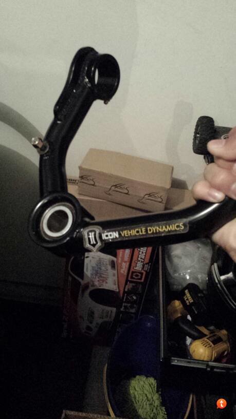

    when screwing down the nut for the abs line bracket, be careful. the stud coming up is kinda soft and easy to shear off the stud

    Pretty sure i snapped that already and a zip tie is holding the line

    Was about to chime when I saw the picture of the UCA then saw wrmathis' post.
    One of them broke and the nut wasn't even seated yet. I ended up cutting both down and zip-tying the harness in place.

    my pass side did that. one day im gonna drill out the stud and tap it and put a bolt in there.

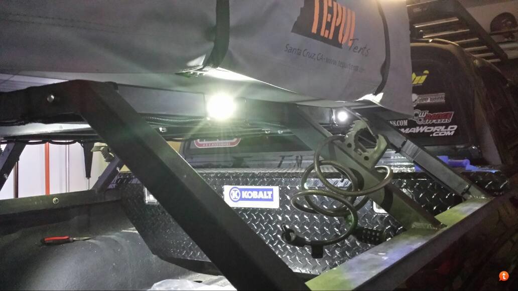

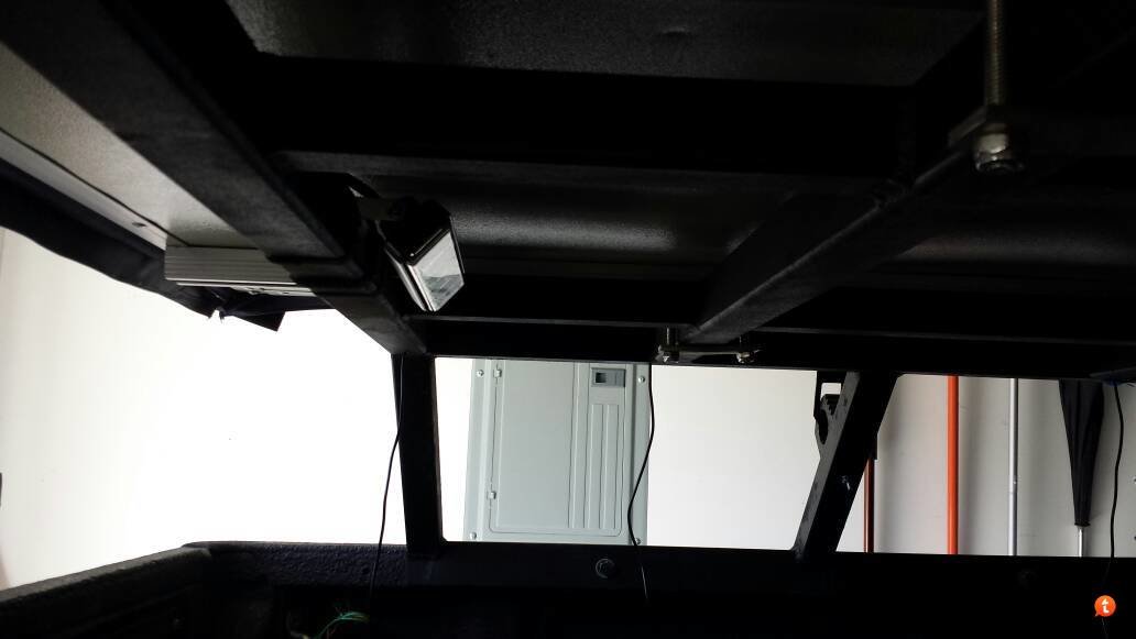

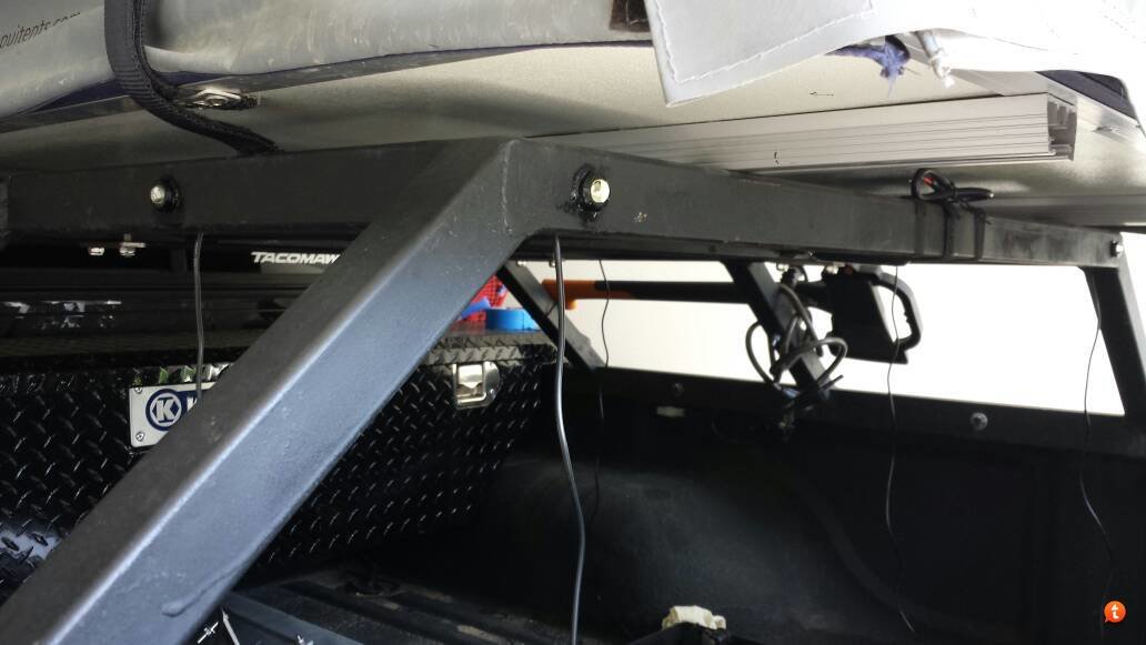

    Working on the bed and rack lights.

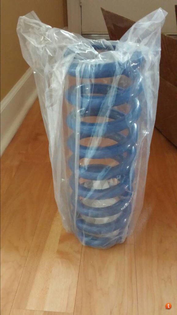

    Ah snap! No more preload. My coilovers are going to thank me

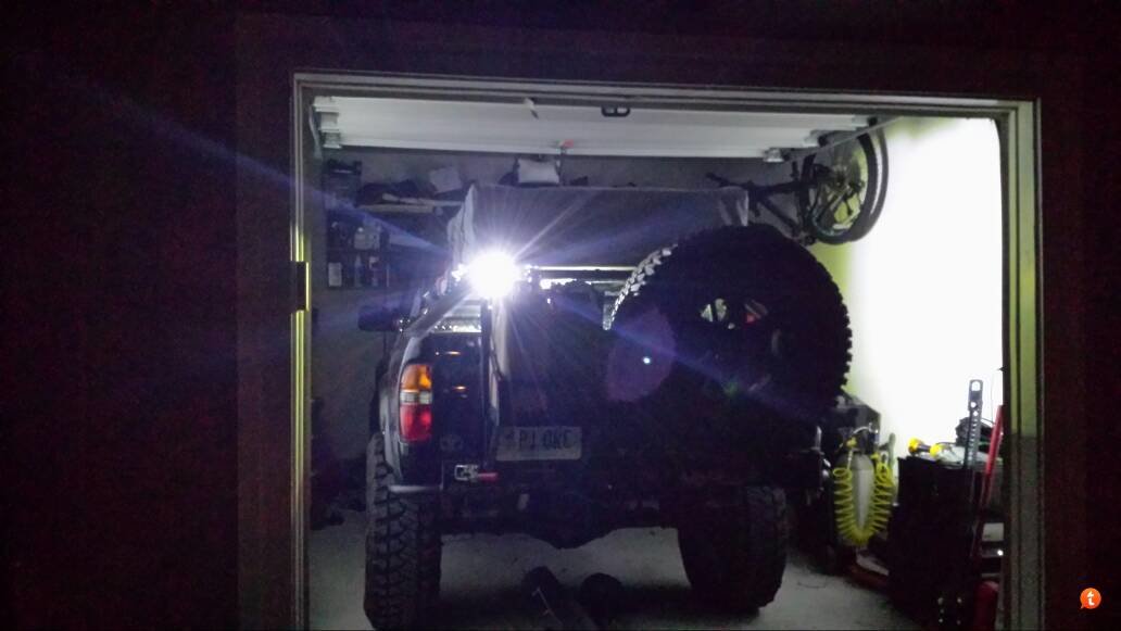

    That's them!
    Brent knows what's up!
    Pretty damn bright! Awesome for a dust light

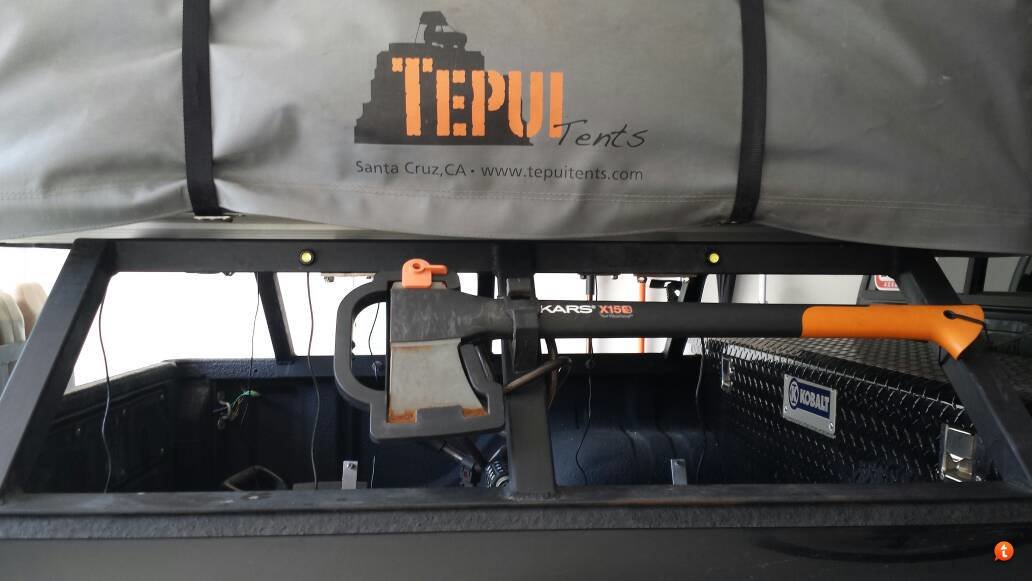

    happy the way it turned out. What sucks is one of the led on the rack is not working. Got to check it tomorrow. At least it's the one behind the spare tire.
    Lights are bright enough to illuminate the rtt ladder. Not looking for something that total blinds some one but just enough light for camping.
    Need to finish off the rock lights then one more to go.
