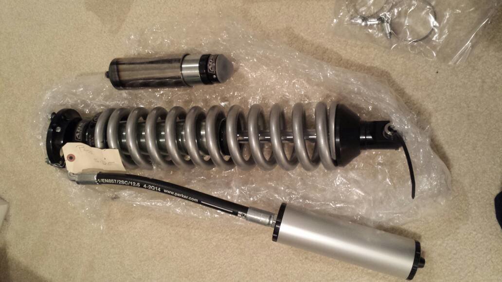

    Do you know what valving you're going to run in the coilovers?

    I'm not sure about the valving. . Any suggestions?
  9. Nov 10, 2014 at 12:58 PM
    #2769
    jberry813
    Jan 21, 2011
    #49636
    28,479
    Jason
    Lake Tahoe
    2012 DCSB Sport
    ...too much shit to list.
    Help me out with quick specs on your truck.
    3.4 v6?
    Plate bumpers
    Skids? If so, which ones and how thick?
    35's
    Anything else of substantial weight you'll have?
    EDIT:
    Also...you just want it valved for crawling...or you want it so it can handle some higher speed stuff? Small tradeoff. If you valve it for high speed, it will work fine for crawling, but will be a rougher ride on daily driving.

    If it were me and my driving style, .020 stack on compression with a .008 flutter between two largest shims, and .012 stack on rebound. Paired with a 18" 600 or 650 lb coil with the flat bottom plate. The flutter will make the slow shaft speed movement calm but you'll still have the .020's on the high speed shims which will take up the big hits. I like a faster rebound to make the front end pop too.
    If you're only going to be doing crawling, you can probably drop the comp down to a .015 stack, but keep the .008 flutter. Rebound's really not going to make a difference with crawling.
    See what MCM recommends too. Curious to see what his thoughts are.

    Awesome. Thanks jason. I'll hit up mcm and let you know what he says.

    You're doing the ADS coilovers right?
  14. Nov 10, 2014 at 1:51 PM

    Yes. Ads with 600lb springs

    16" with tapered bottom plate or 18" with flat bottom plate? Assuming 18" since Matt was the one that originally convinced me on the 18" and I've never looked back since. Your truck probably weights a little more than mine, but I have very little preload. IMO the 18" 600lb spring is the perfect spring for our truck.

    18" flat plate. .
    Jason since matt sent the coilovers already I've asked him to chime in on the valving.

    Awesome. I'm sure he won't steer you wrong. With crawling tho...it's a lesser issue because the majority of the time things are slow and less noticeable than high speed shock movement. You can valve shocks for hauling balls, and it will still do just fine crawling. Valving doesn't hold the weight of the truck up, springs do. However it can make the in-cab perception a little softer on the post office speed bumps. I have revalved my shocks countless times and I honestly can't tell the difference while crawling. It's only noticeable on the fast stuff.
    I'm slightly opinionated tho so take it as a grain of salt. :D
