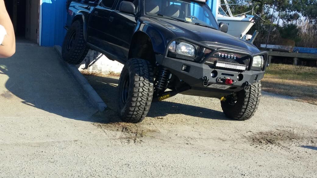

    Although I have tundra brakes that wasn't the issue. The 35s were hitting the top of the spindle a bit. .75 spacer should do just fine

    Hey, got a shit ton of preload (almost 3") on these 650 springs and its still sitting two inches lower than the 620 eibach coils, wth? How much preload did you have?

    Probably shorter springs. Longer springs=less preload and smoother ride

    Sounds about right. I remember saying. . Shit load of preload. . 3 almost 4 for me. Use the 700lb springs. Call me

    I have a set of 14" 600lbs Springs someone can have for my standard fee...Paul knows what I'm talking about!

    I do have to say this is at full droop

    Not enough ramp to fully flex out
