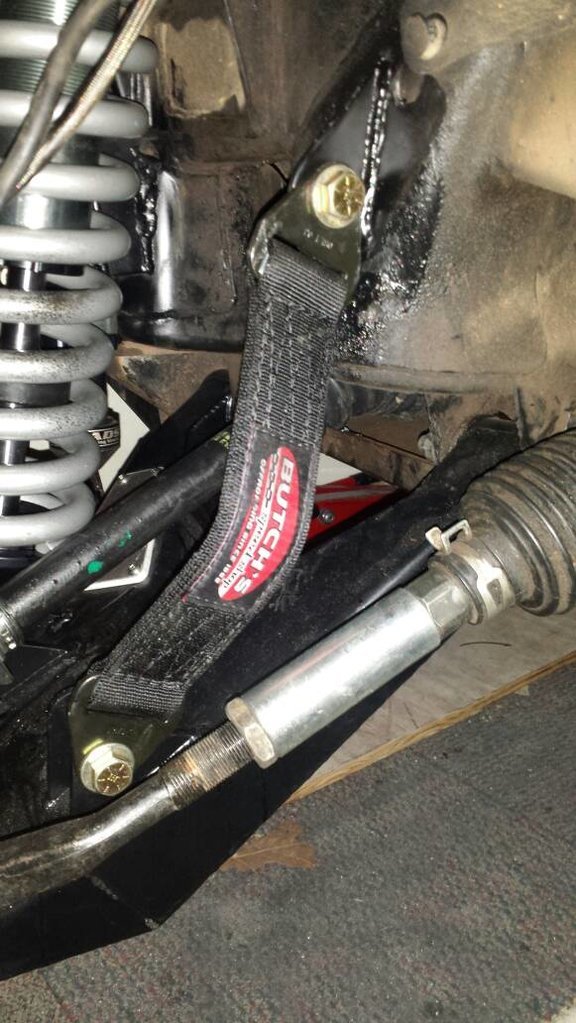

    We mounted then to one of the rear tabs on the lca. You just have to droop the suspension and mark it. Don't remember the exact number but we took in account that the strap would stretch about 3/4 to an inch

    Thanks. I plan to run a clevis on top but in approx the same spot so i may need a shorter strap.

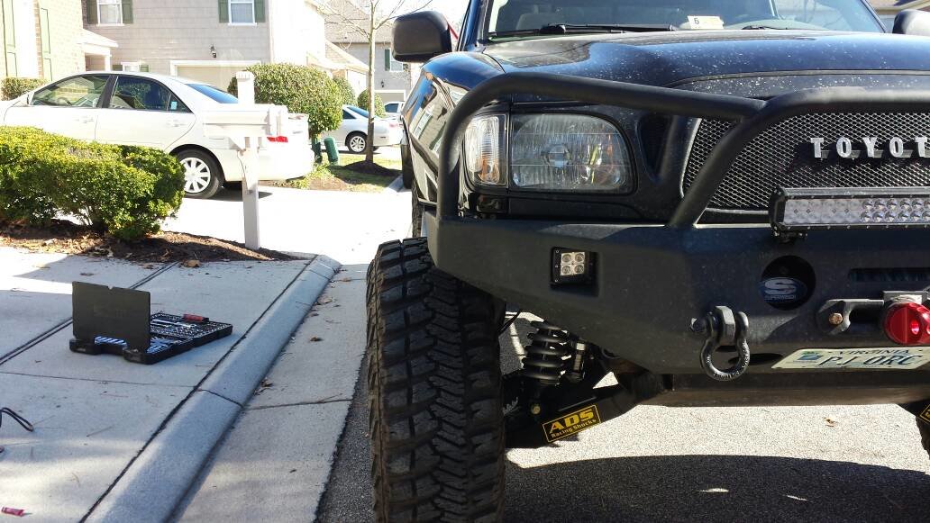

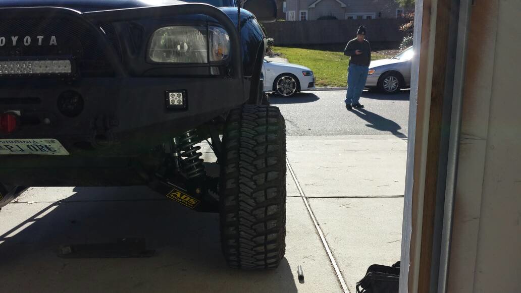

    With 4.5 inch back spacing I needed a 3/4 wheels spacer.
    Way better than the 1.5!!

    Looks so much better than them big ass spacers and no touch at droop is a plus!
