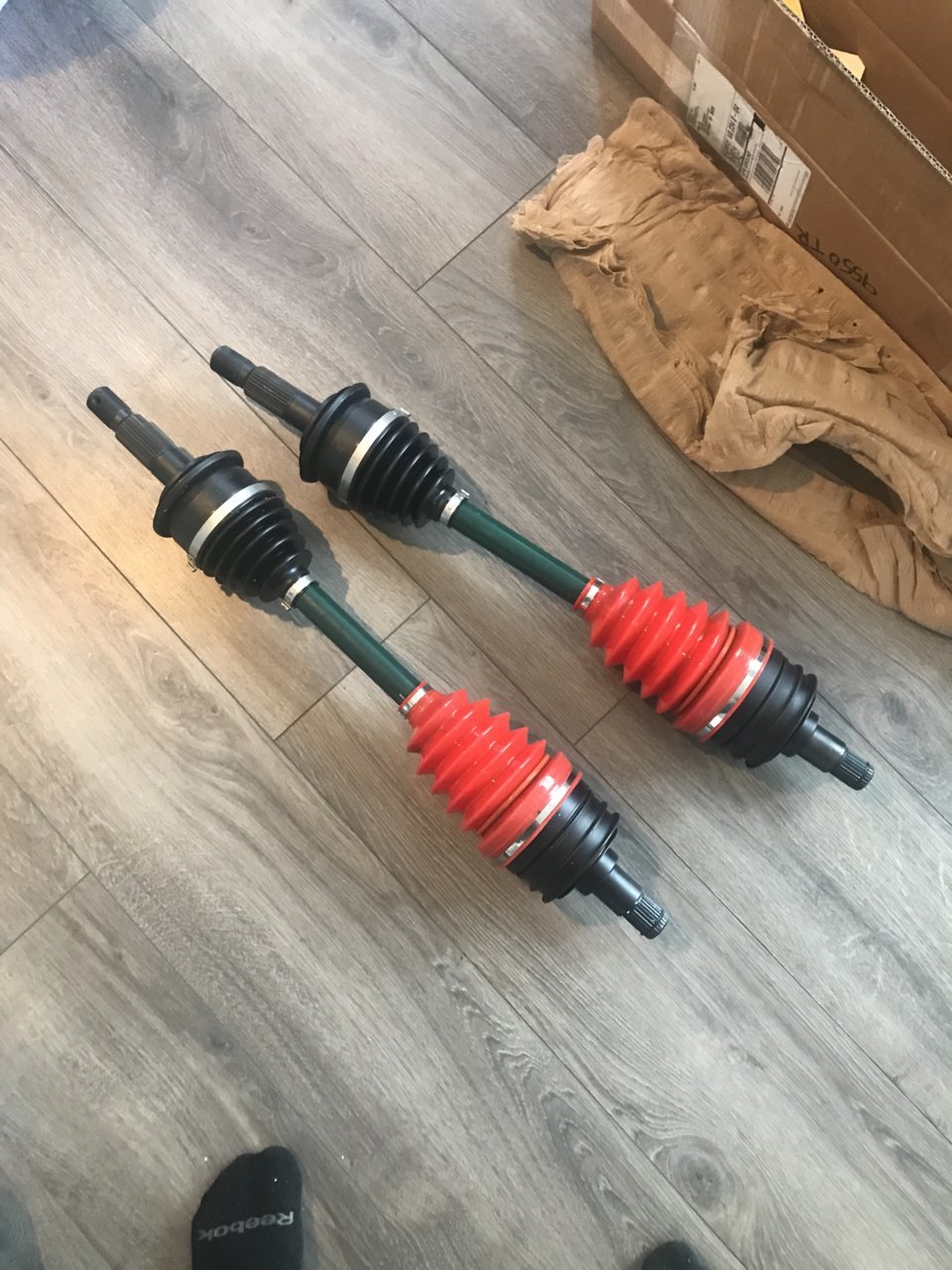

    CVJ Axles Inc Axles came in! Both joints modified for more angle! Will post photos once they are installed! B2D27FFA-B90E-4F1C-A03B-7733D7F8808E.jpg

    If you don't mind my asking, how much were they?

    Hey bud, I called and had them modify the inner joint on their 9550TR’s, which already have a modified outter joint. Doing the extra modification was 65$ / side. All together without returning the cores- $851. After the core returns(both axles) $681

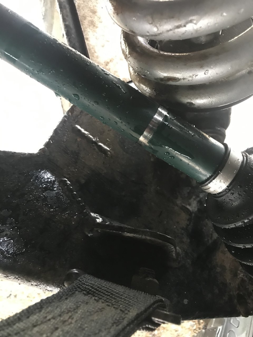

    9292EC10-7751-4E0C-8904-7C2C78387FB8.jpg First axle went in last night. They are beefy-er than the previous ones, so I’m running into some clearance problem between the axle and the spring on the passenger side with I’m locked all the way to the right. A [toyota truck mechanic] friend of mine suggested to take a shim/ spacer out of the bottom ℅ mount and put in on the other side. To space it further from the axle. What do y’all think?

    Yes, a lot of coilovers have different size spacers in order to move them away from the CV axle when installed.
