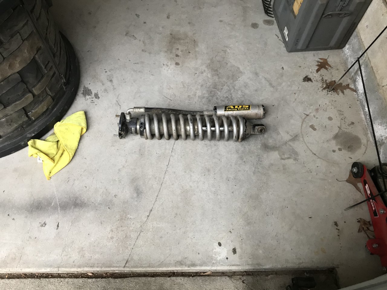

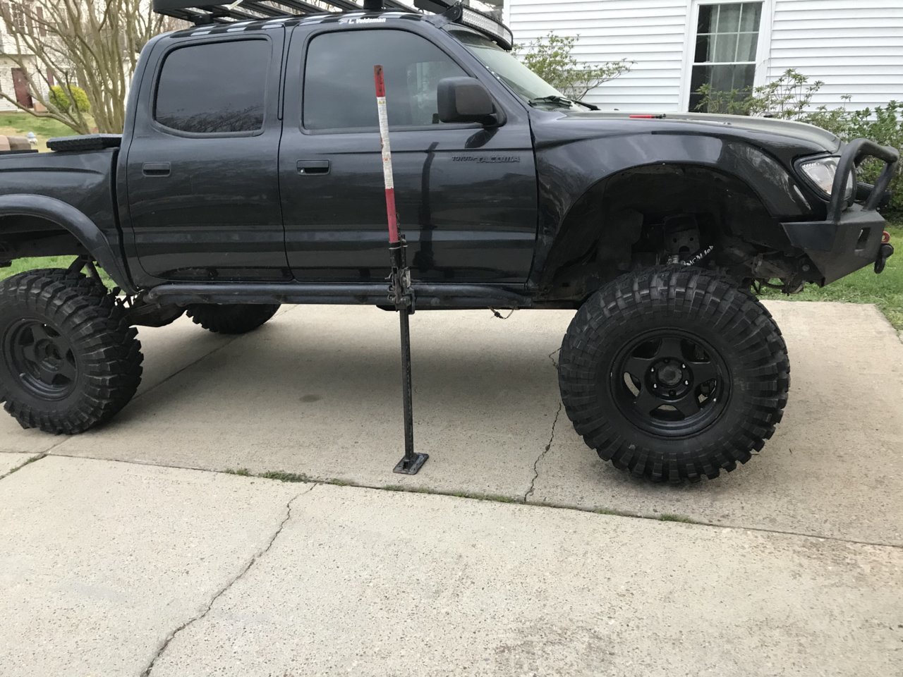

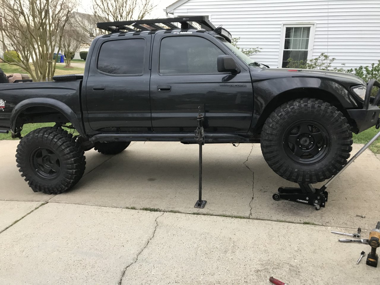

    Took my coil over out to try to space the spring further from the axle. I also wanted to look at the travel of the CV. It made for some cool photos.

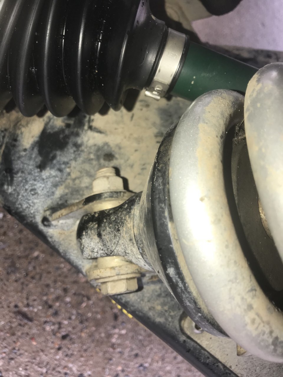

    986B4B65-6368-46BF-9805-558DC310EB67.jpg Got some clearance. Haha what a bitch that was
