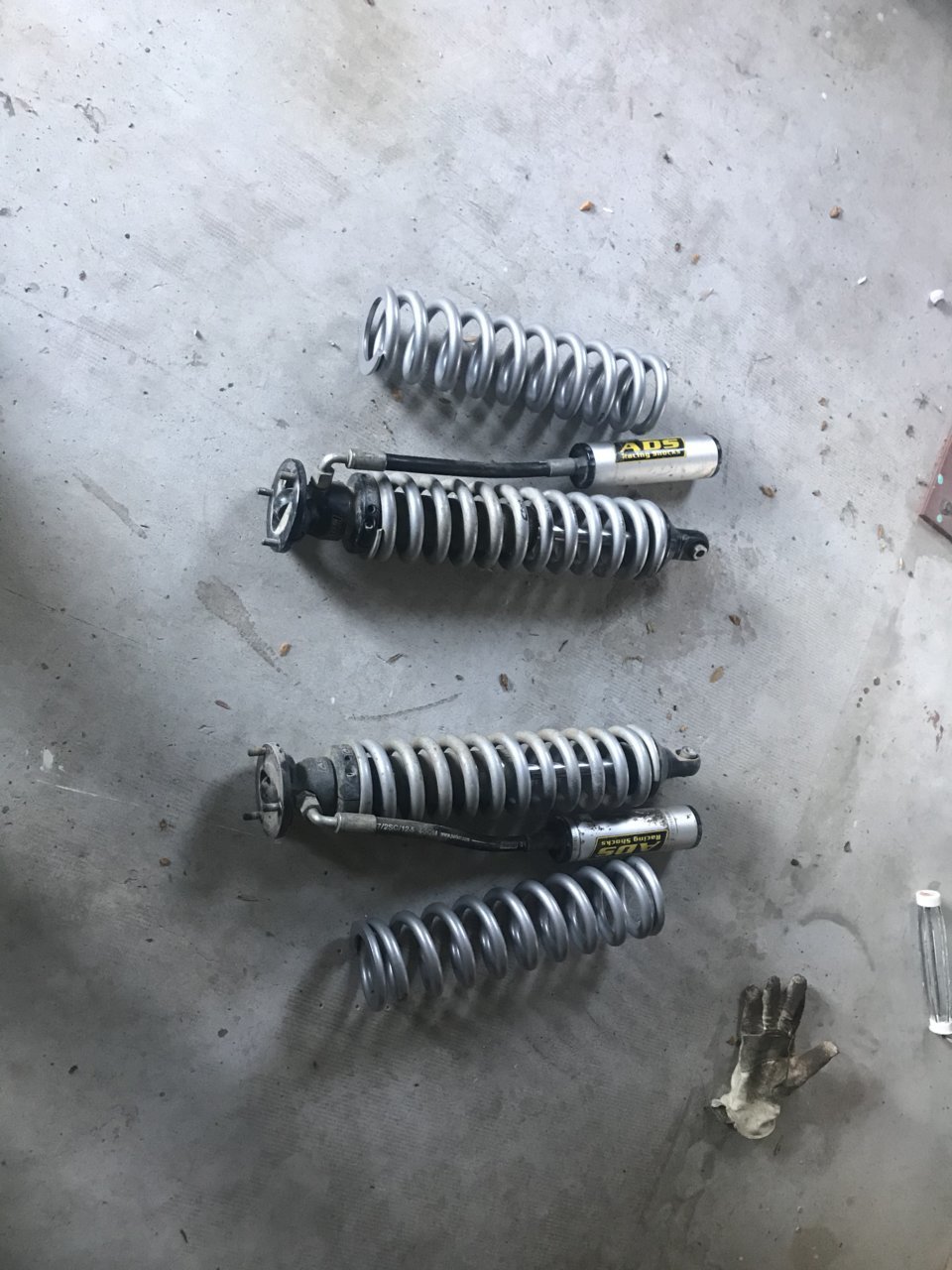

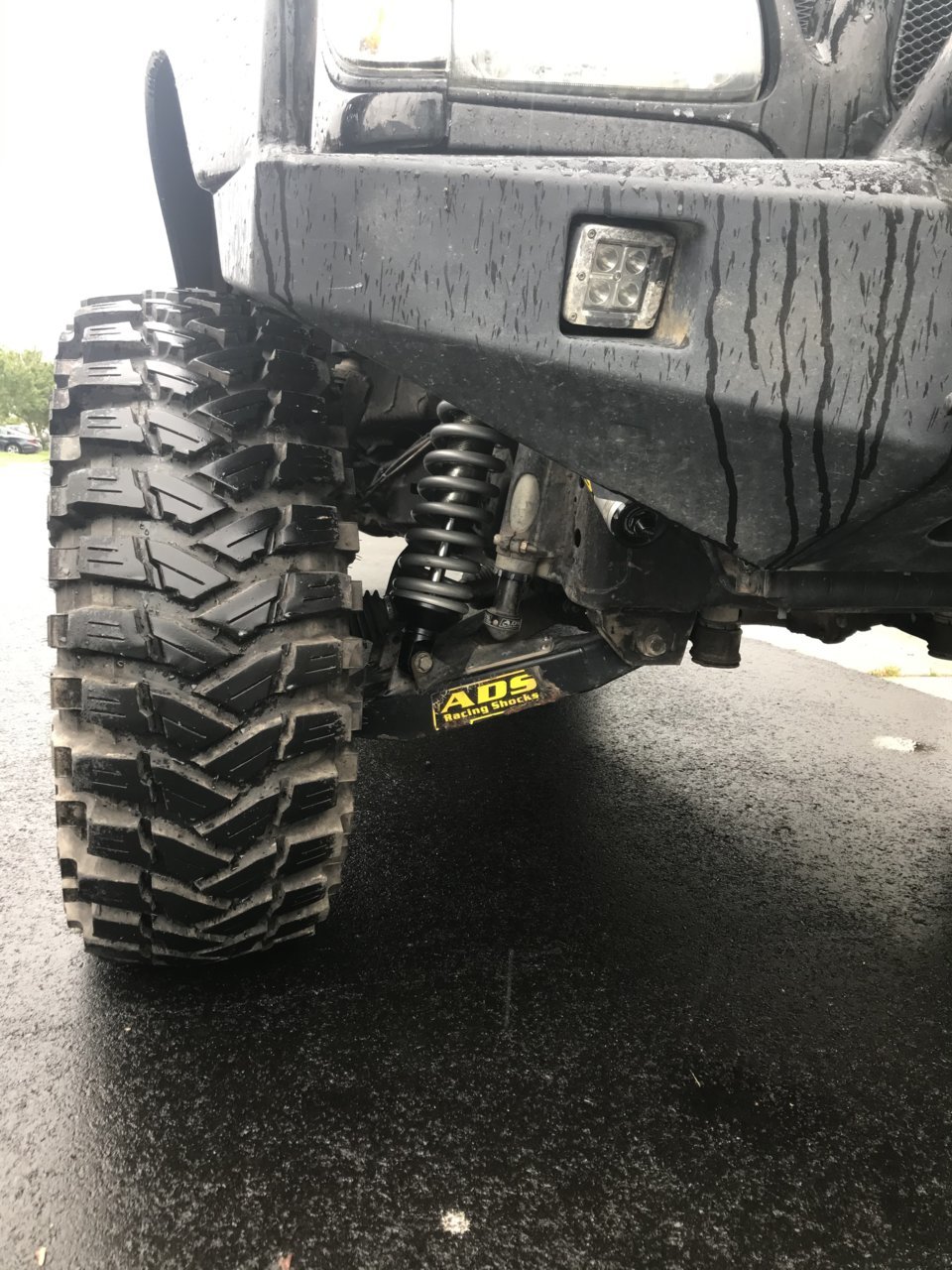

    Alright, here it is. New springs are on coil overs, and installed on truck. The ride height difference is crazy to me. If I were to try to compare it to the old ride height, it felt like I was one of those Carolina bois with half a lift installed. I measured my CV angles before and after using my ‘measure app’ on my iPhone. Before, I was riding at 18 degrees driver side, and 20 degrees passenger with the 18” springs. With the 16” springs, and half an inch spring compression, they are at 10 degrees driver side, and 13 degrees passenger. I’d say it’s quite a big difference and can definitely help with my CV breaking problems. There is now quite a bit of slack in the limit straps. Pictures below of before/after.

    Before3A675ABF-9A25-4F65-836E-4CF58C858AEC.jpg After CBB3B67A-9E0E-4DF2-B4C7-F2CBDE3C4F00.jpg

    73769C45-44FD-44CD-9266-E97FAEF807EC.jpg New CV angle is much better

    99F8DA94-58C7-4A19-B479-6001C37C57AF.jpg Limit straps have lots of play now

    Still looks a tiny bit high to me. Id lower it personally but thats just me. Mine is more "level" CV angles, not sure what they are but I have about 50/50 up and down travel. You're still mostly up travel and less down travel.
    However if you go much lower you'll be riding on the hydro bumps, the down side to having them on the LCA..but probably rides a lot better now too.

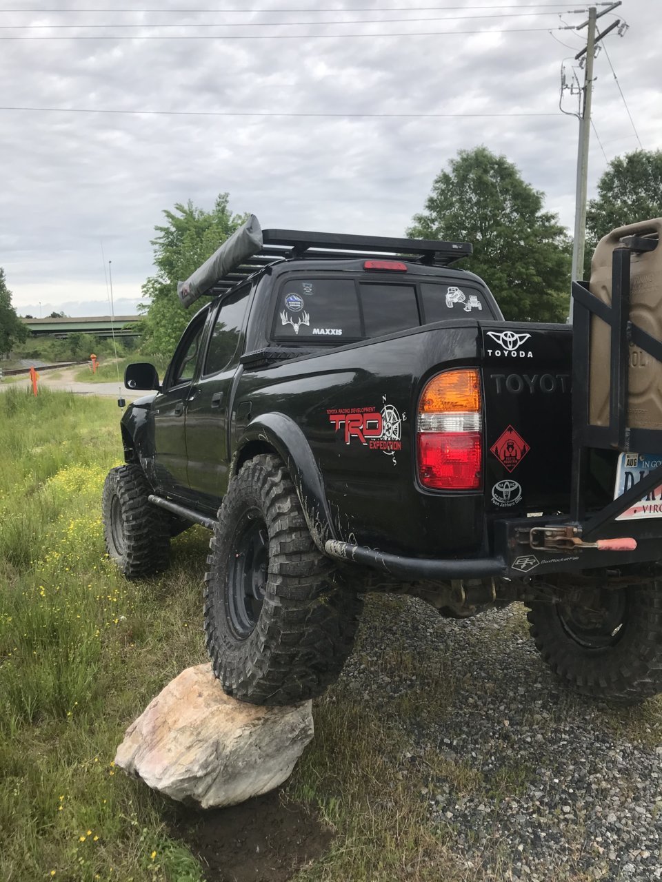

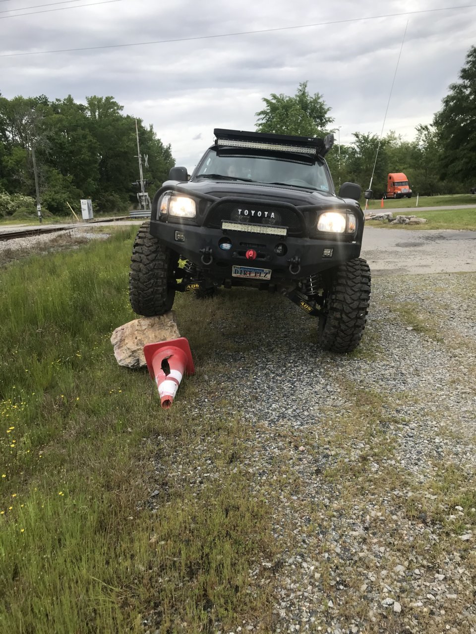

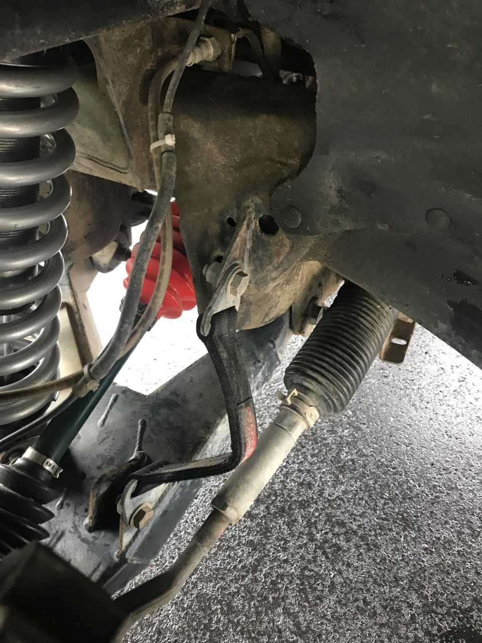

    Went and did some flexes to try everything out. All went well. Tested in 2wd, 4wd, 4wd both cases low, and crawl box double low. Nothing broke and all around a far better feel. Now it’s got me thinking about relocating the bump stops higher. Never tried it with front locker on, cause there is no point and I don’t feel like replacing another Cv today... pics to follow

    Not sure you can move the bumps up. They are just 2'' stroke. If they were installed correctly then when they are fully compressed thats the true bump height. They are basically a small shock so as they compress the stiffer they get.
    But due to the geometry of being mounted on the LCA near the inside by the piviot point, it really means you are bumping the last 4-6'' of travel with a 2'' stroke bump. No way around this really. Other than a fully fabbed spindle, engine cage and then bumping off the spindly/UCA. But thats race truck stuff and you don't need to do that.
