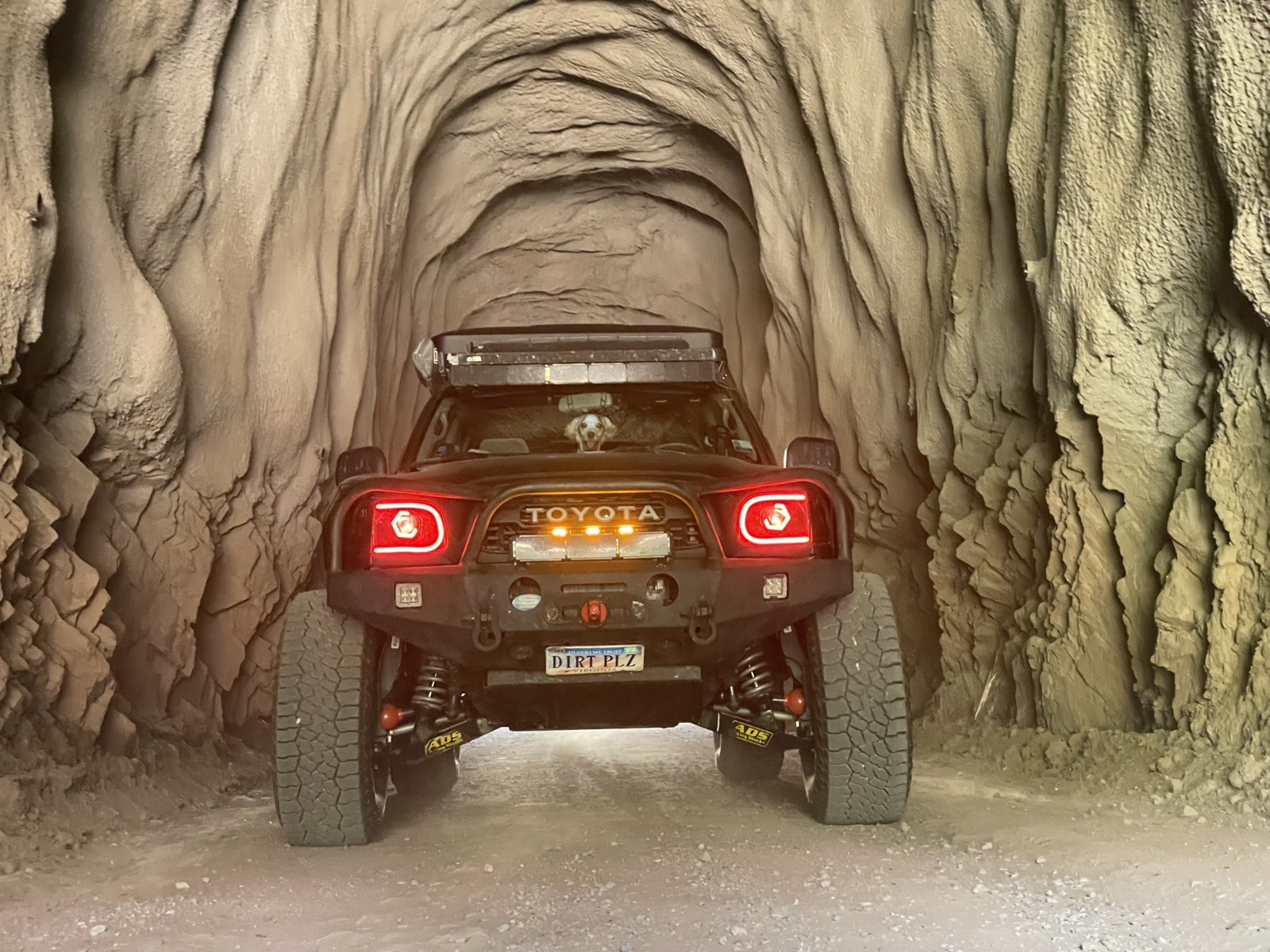

    thanks y’all. We went on one trip since we moved here.. it was only 45 minutes from home! upload_2023-11-3_16-57-44.jpgupload_2023-11-3_16-57-44.jpgupload_2023-11-3_16-57-44.jpg
    before I wheel much again. I need to refresh my rear suspension. Thinking of going with the total chaos fab upload_2023-11-3_16-59-31.png

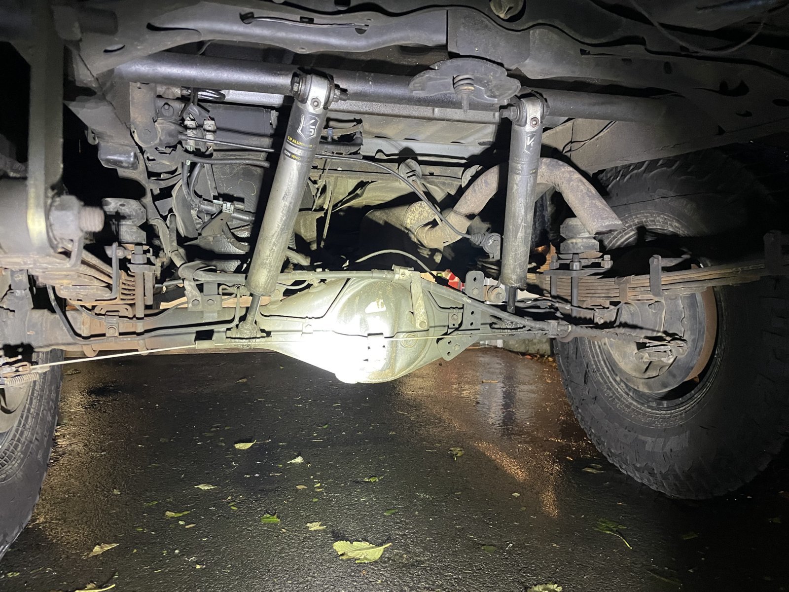

    Depends on you're needs.
    Though I'd maybe do something different to try and at least match the front travel. Stock length leaf spring no matter who makes them won't cycle more than 11".
    And the total chaos kit is great but it'll only allow you to run 2.0 rear shocks.
    You'd be better off going with a 2.5 inboard than 2.0 outboard.AArchive off-road sells a bracket to fit 2.5s outboard.
    Although that is also going to depend on your driving style. If you're not hauling ass everywhere then probably won't matter.
    Best thing would be SUA config but that's a bit more involved and you sacrifice bed space and load capacity.
    So really....depends. what's your driving style and goals?

    well this is what I have currently and my shocks went on my cross country trip, and my leafs are fucked too, I’ve been bottoming out my shocks on right hand turns. I am just looking for a formidable off-roader with good road driving manners as well. I don’t have the ability to haul ass as I am stock engine, so that’s outta the picture. Haha upload_2023-11-3_18-30-32.jpg

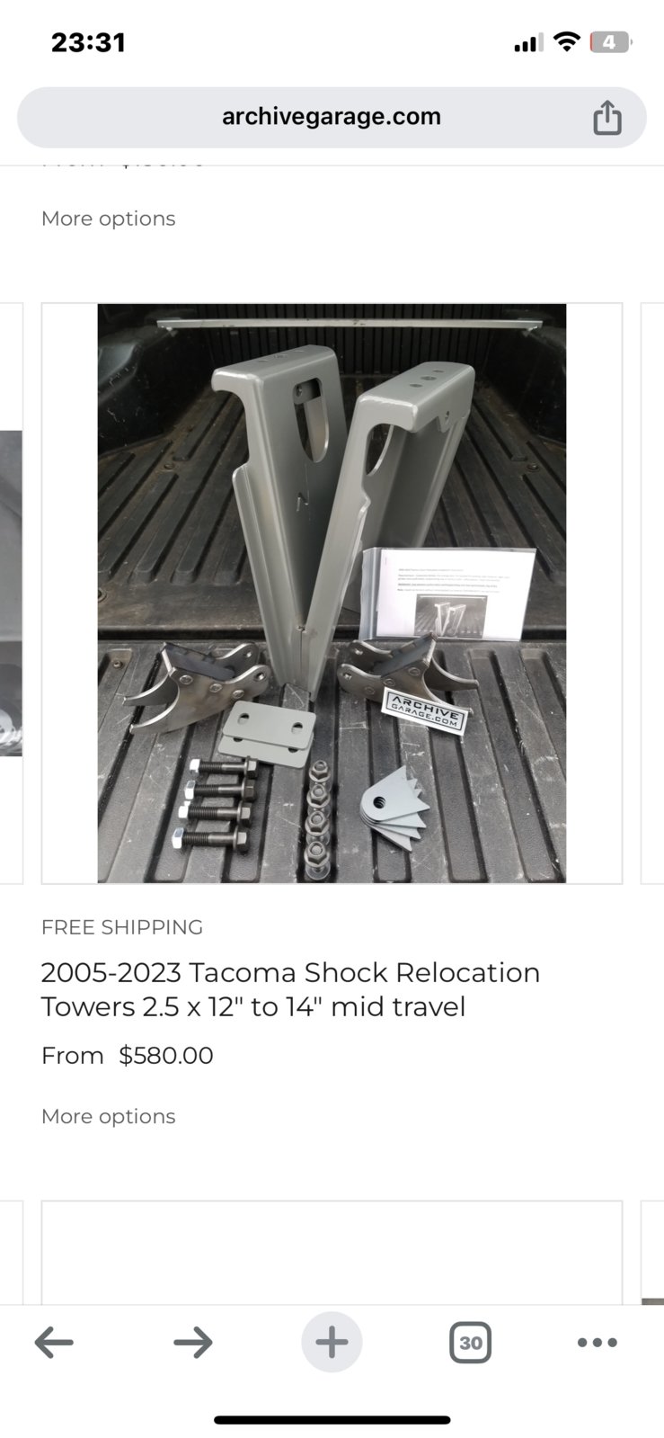

    just looked up that company, and damn. Their shit seems too notch. But my question is… why wouldn’t I be able to adapt their 2005+ towers to my 1st gen? It would probably require a body lift… anything else? upload_2023-11-3_23-32-52.png

    don't bother. They make 1st gen ones.
    https://archivegarage.com/shop-archive/ols/products/1g-tacoma-shock-relo-osr
    However, you'll have to run big spacers or get a wider axle to clear 2.5'' shocks.
    Your current setup looks...mostly okay. Id sat they upper mounts are too low and lower mounts not quite low enough. You could redo that setup with 2.5 triple bypass 10" short body shocks from ADS and it'd be pretty damn good. I'd go more vertical than angled. Then you just have to get replacement leaves which should be custom from Deaver or Alcan with stock geometery but again that'll only pull 11'' at the most.
    If you do the archive kit, get a tundra axle to swap in for more width, then you could do 63s or even a SUA custom setup. Although I don't think the archive kit would work great with a SUA kit due to the increased uptravel so that probably isn't great.
    As for hauling ass, 45mph on back roads can feel pretty quick on two tracks with rocks which I guess was what I meant. If you want the rear to keep up with the front, you'll have to get a bit creative. If you're not trying to baja1000 it everywhere then there are options.
