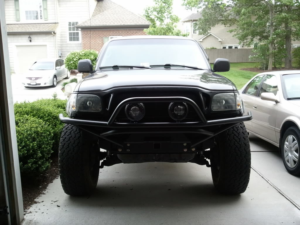

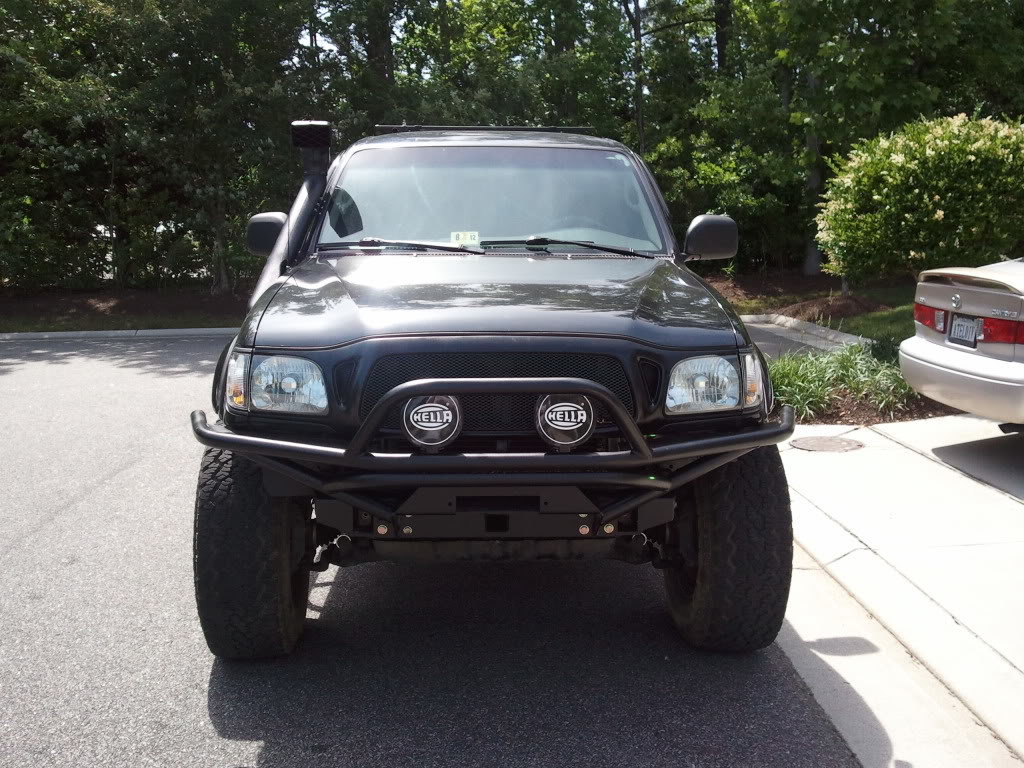

    Installed some hella black magics. I like that they are a bit smaller, also the black lenses look good against the black paint and grill craft.

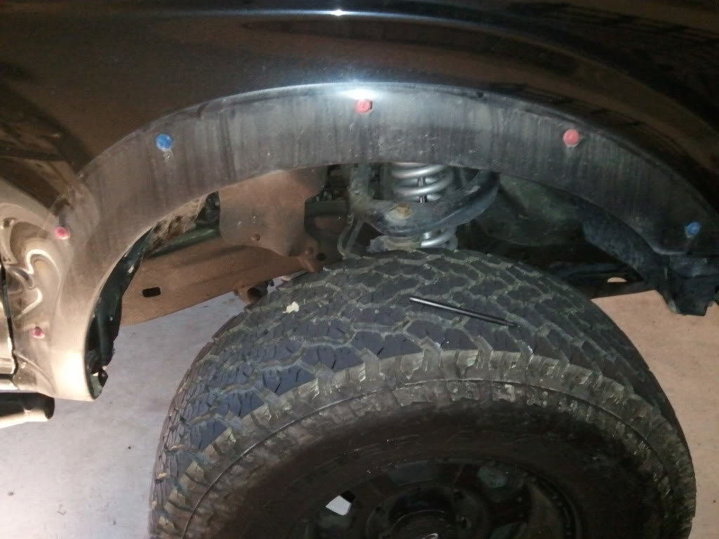

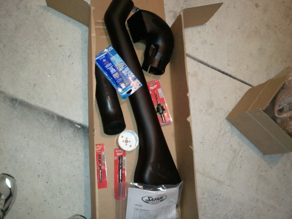

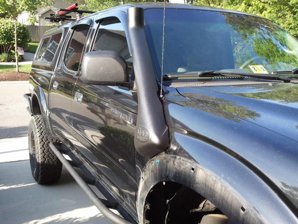

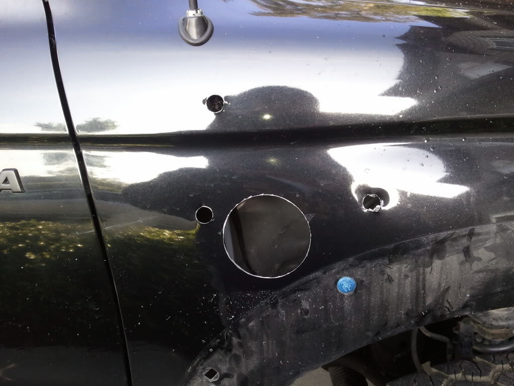

    Here is everything you need to install the snorkel. I also used some clear silicone for the plastic inserts on the pillar.
    some people say you can save some of the clips. I did not save any
    This is the intake tube inside the wheel well. Above is how much dirt came out of it.
    template all lined up. Double check. although the 16mm (5/8) give you more than enough room when inserting the studs in the fender.
    had to deburr all the holes with a dremel tool.
    safari body secure, ready to be tightened
    Finished product. Turned out nice. Here is a tip, make sure you grease the inner tube before you start connecting everything together.

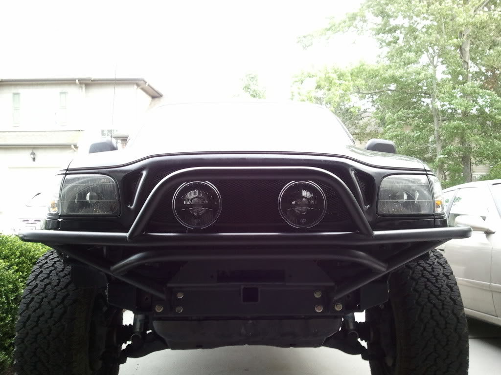

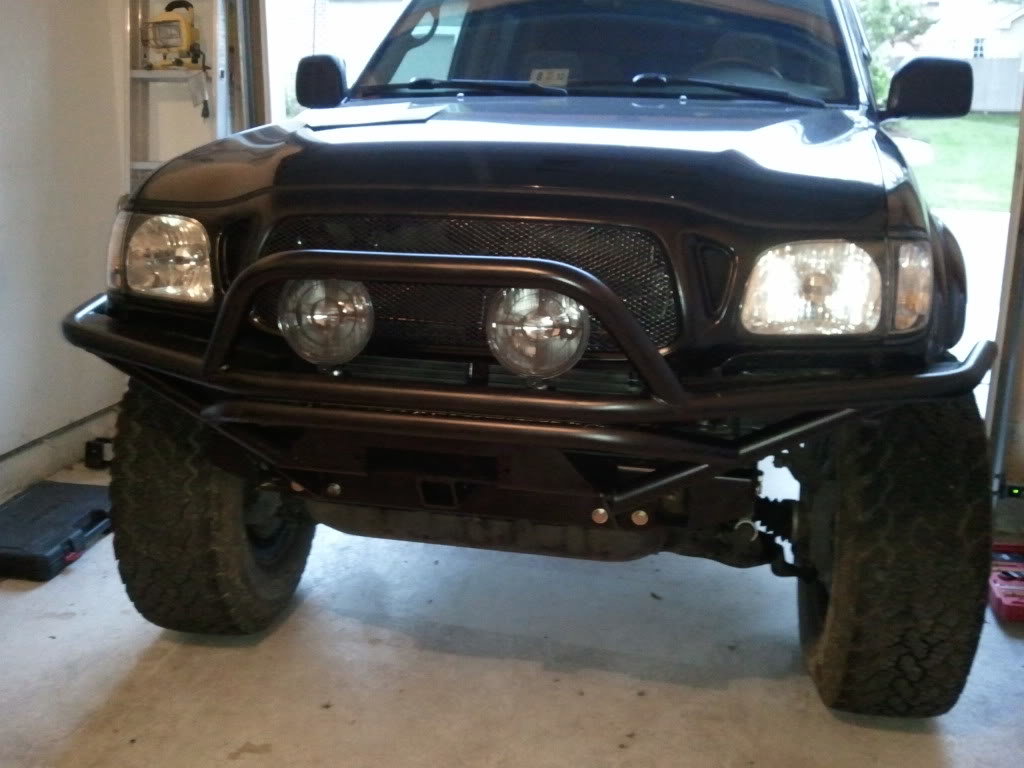

    I looked at your build and noticed you have your lights mounted plus the winch.
    I ordered the super winch lp8500 because you can't beat the price. I have a few questions for you, was the wiring it came with long enough for you to locate to solenoid box under the hood? How about locating the box on the two metal bars above the winch spool? Last question how long is the solenoid box? I'm thinking that it might fit between the light tabs. Unless it will hit the bottom of my grill. Dude, I could use your help on mounting ideas for the solenoid box, also if you had to get the wiring where did you get it What's your opinion?

    hey pone so heres some details about winch set up i have.
    1. the solenoid box come directly attached to the winch and solenoid is bolted directly to the winch terminals. it will come with a few feet of positive and negative cables. to attach to the battery and ground.
    i relocated mine to the engine bay to keep it from getting too exposed the elements and to allow for the 15ft of controller length to reach inside the cab or far enough away from the vehicle to help protect operators from possible injury. i bought ga wire soldered it to 2ga tabs so it would be completely bolt on. i ran the cables through the radiator core support where the ac hardline come through
    SANY0048 by newskooler, on Flickr
    heres a pic of what it looks like in the engine bay
    SANY0046 by newskooler, on Flickr
    SANY0041 by newskooler, on Flickr

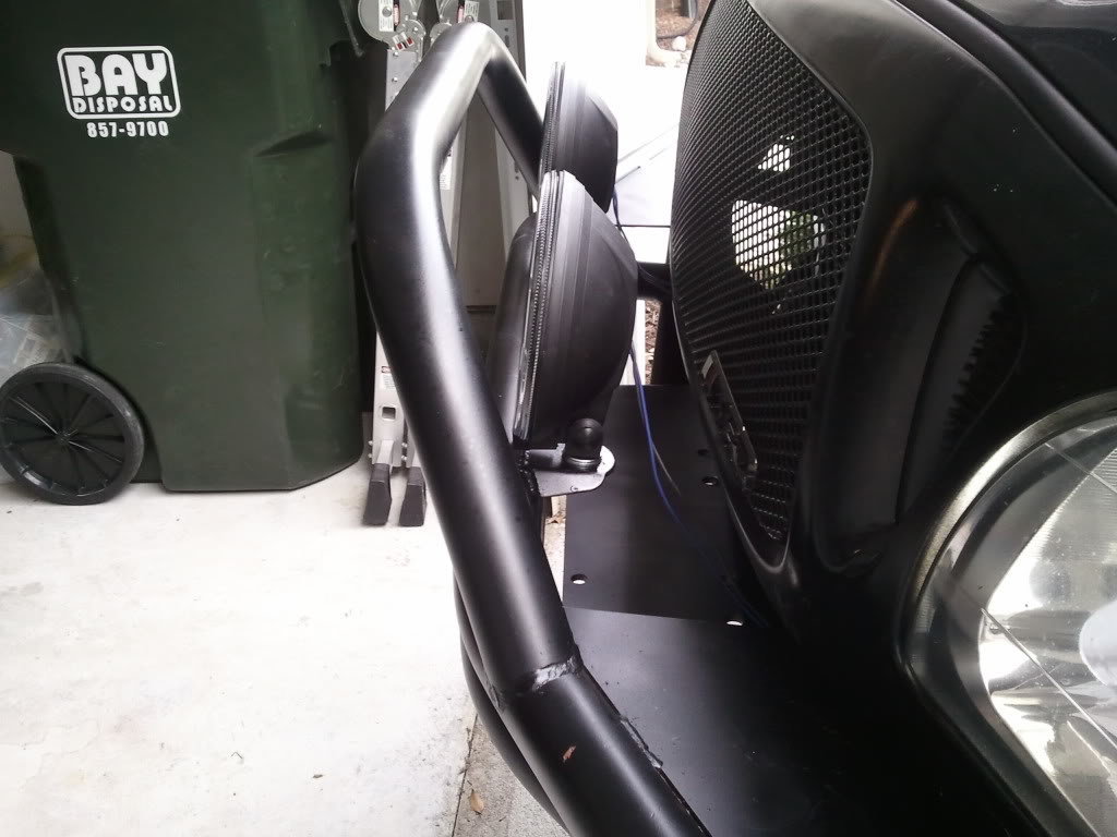

    2. im amost 100% sure the winch wont fit with the light tabs i had to hone the pre drilled holes out about 1/16th of an inch or so to get the bolts to line up. its a tight fit (Pic) if you want to keep the lights mount them to the winch like i did with a piece of flat strap but bent to a 90* angle and drill holes to fit mount to the allen head bolts when you clock the winch.
    you can see if you dont clock the winch you have to cut the grille in the upper right hand corner:eek:
    SANY0043 by newskooler, on Flickr
    3. clocking the winch(clutch)
    A.to move the clutch requires removing the 2 6mm allen bolts from the right hand side
    2012-05-17 18.08[1].33 by newskooler, on Flickr
    B. Stand on end and remove clutch assembly. if the rod come out dont panic it can be put back in easily just keep it clean
    2012-05-17 18.10[1].10 by newskooler, on Flickr
    C. Remove the (10)3mm allen head bolts and rotate the unit to the 3 o'clock positon.
    D. Reassemble in reverse order and carefully retighten the bolts snugly
    SANY0042 by newskooler, on Flickr
    i hope this helps and hit me up if you have any questions cause now that ive reread the post my brain hurts:D.
