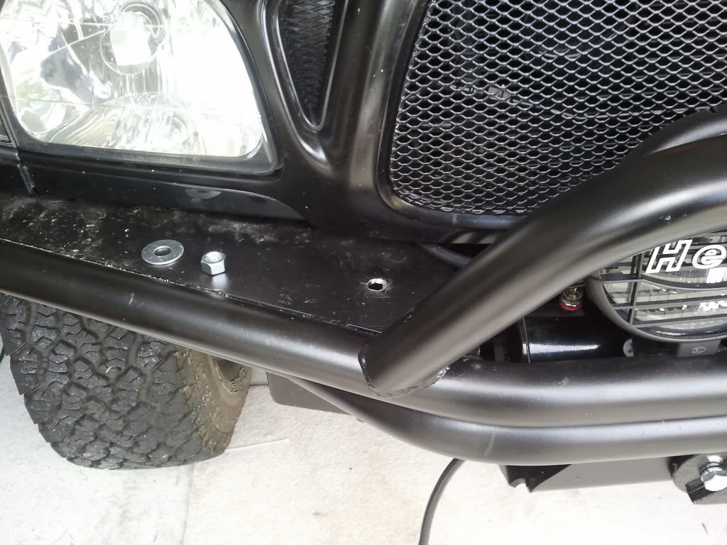

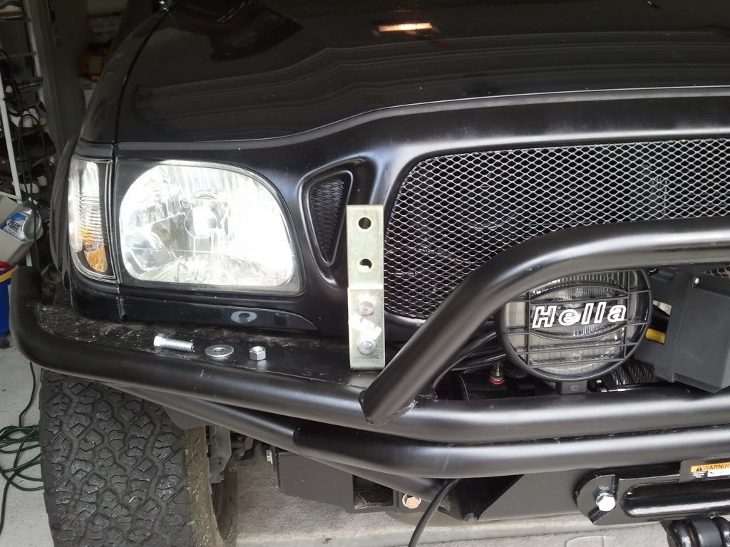

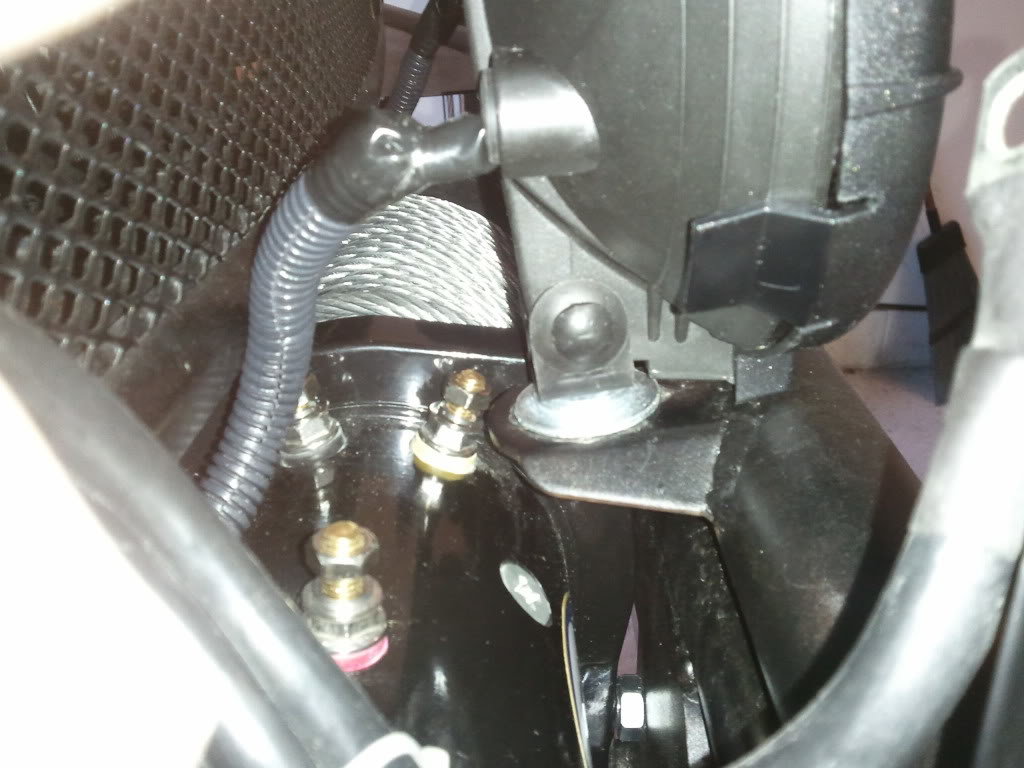

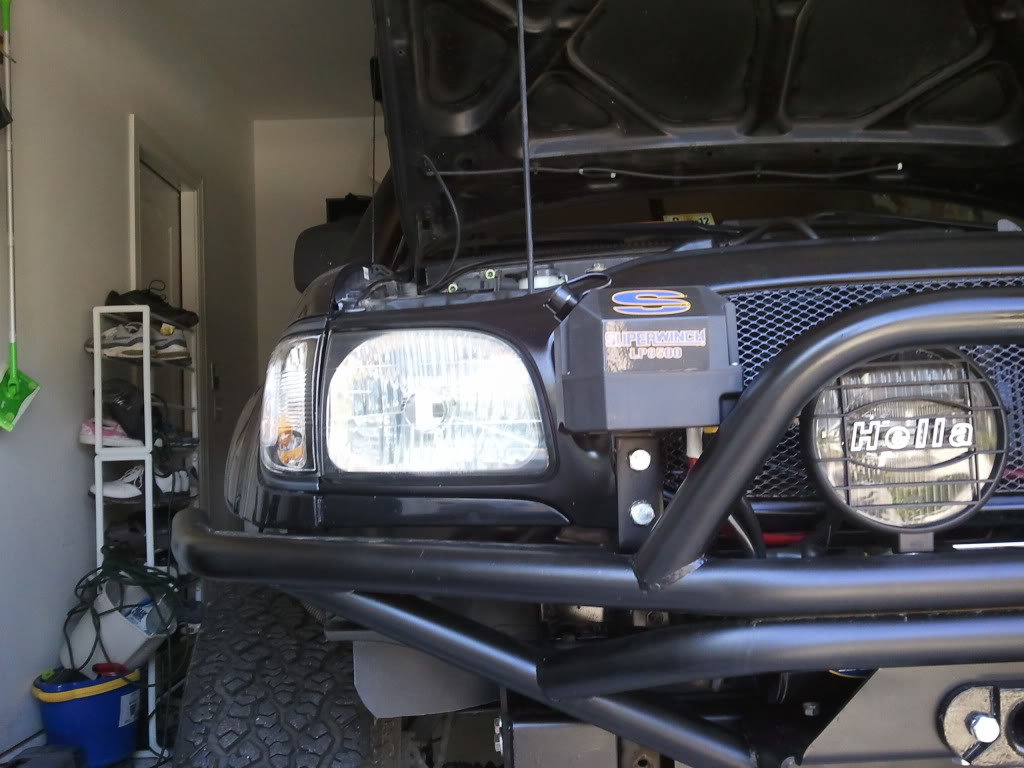

    Started mounting the winch, Light tabs ended up fitting like a glove. Afraid I was going to have to cut them and get them rewelded

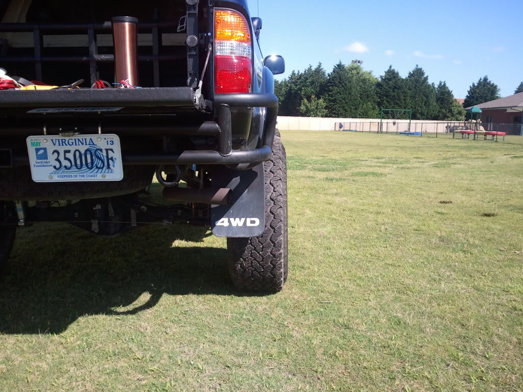

    Also got some rock guards for the hell black magics
    Still gotta find a spot for the solenoid box. Might get a l bracket attach it to my plate on the bumper and bolt the box on to it. Not sure yet. I also have an amsteel blue rope coming in to replace the wire rope (save some weight).

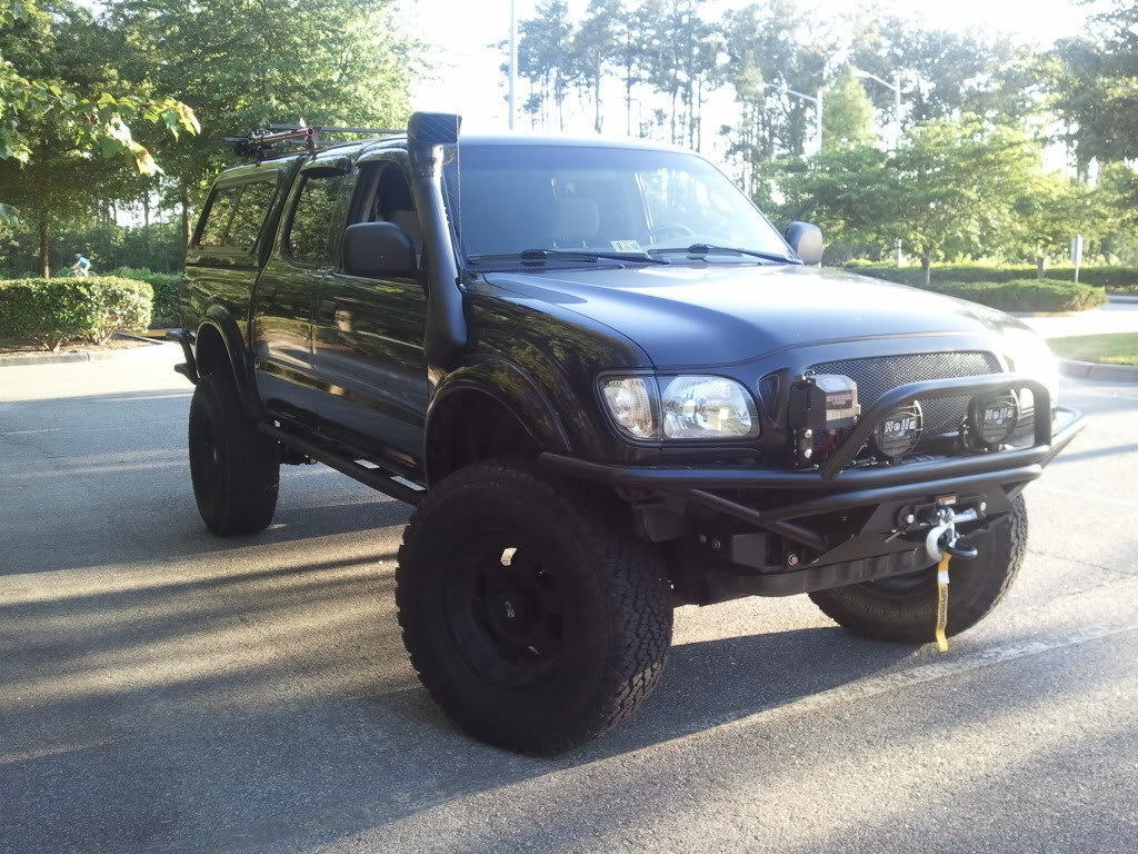

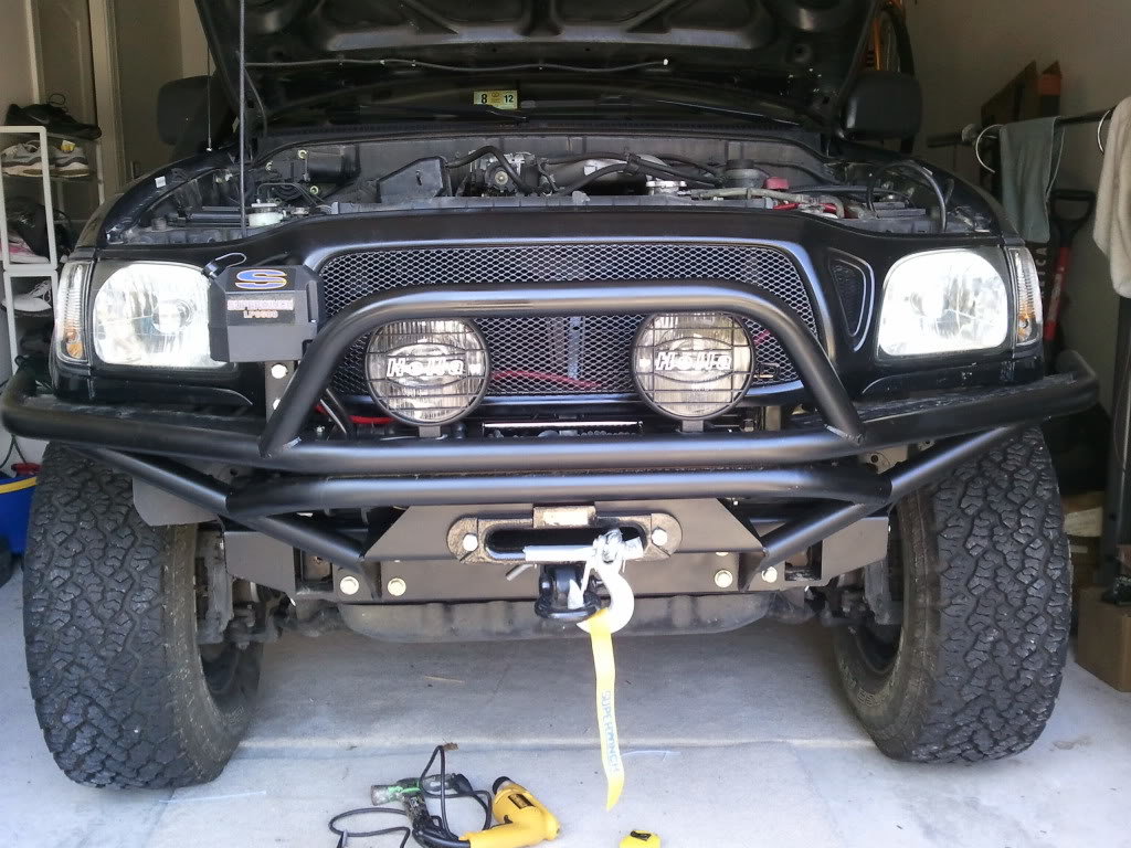

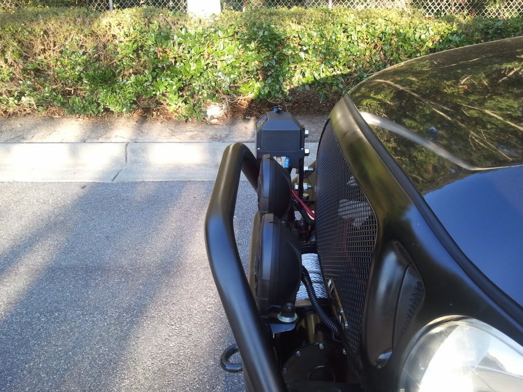

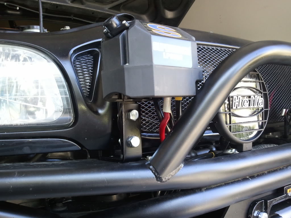

    Winch is all mounted. Here's the process.
    Drilled a hole into the plate I added. (thanks for the idea box rocket)
    Mounted a l bracket (thanks home depot)

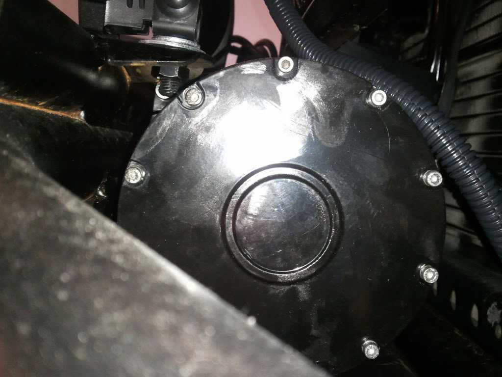

    Took apart the solenoid housing and mounted a bracket on to the back
    Wanted the solenoid box to fit behind the light bar. It is a very tight fit. I thought about mounting it under the hood but wanted to have access without having to open the hood.
    I'm pleased with the way it turned out. One thing about getting the Trail Gear Low Profile bumper is that if you get a winch you will most def have to relocate the solenoid box.
    I have a amsteel blue synthetic line coming in on Friday so I'll post some pictures of the install on that. I like that it's stronger than wire plus lighter too!.
    Went to test it out and snapped some pictures.

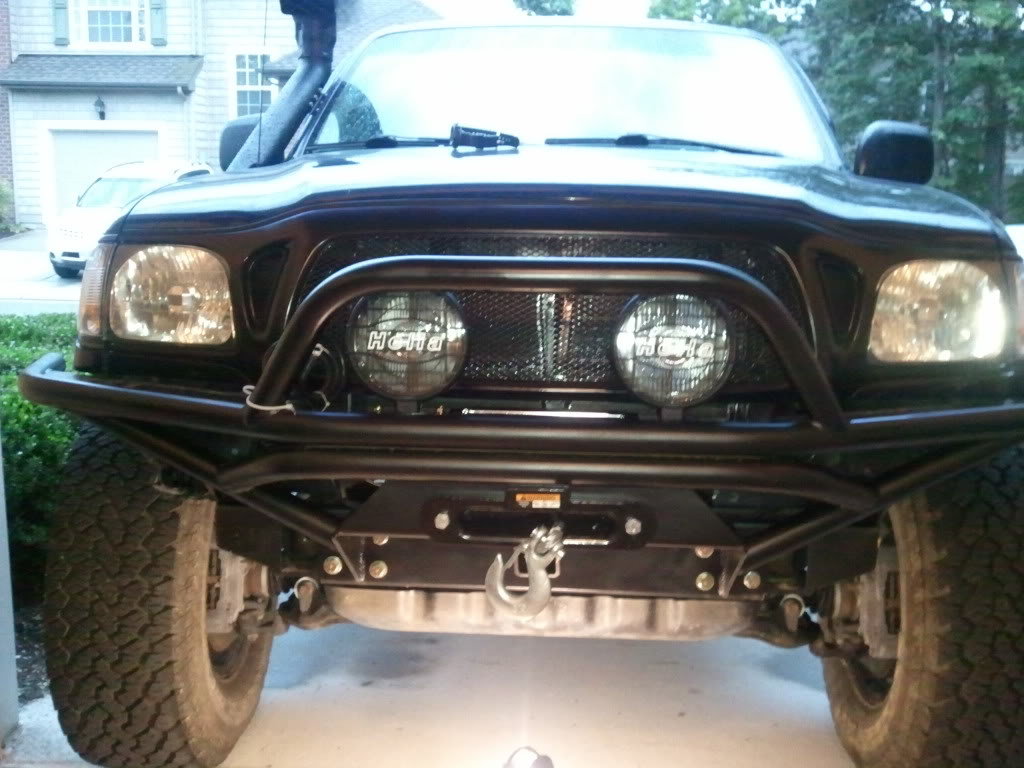

    took the wire rope off and replaced it with an amsteel blue.

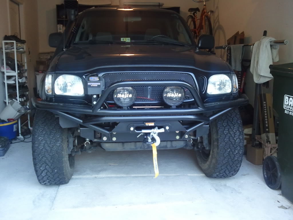

    New sling hook. Had to order a 3/8 sling hook with connection link from master pull. The one that came with the superwinch did not fit the thimble from the amsteel blue synthetic winch line. Customer service at master pull is excellent. They only charged me the difference as if I were ordering the winch line and sling hook together.

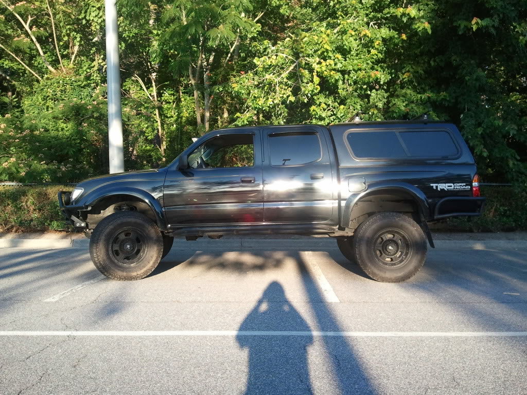

    Black magics are pretty bright.
    Good picture of the stance.
