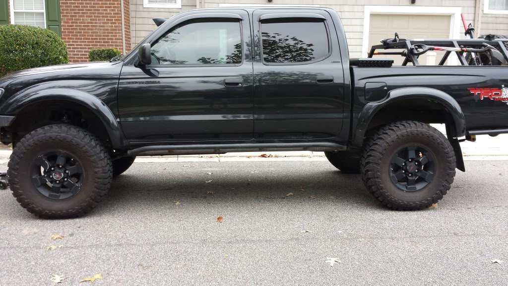

    lifted the truck an inch higher in the front. Love having Icon adjustable coilovers.

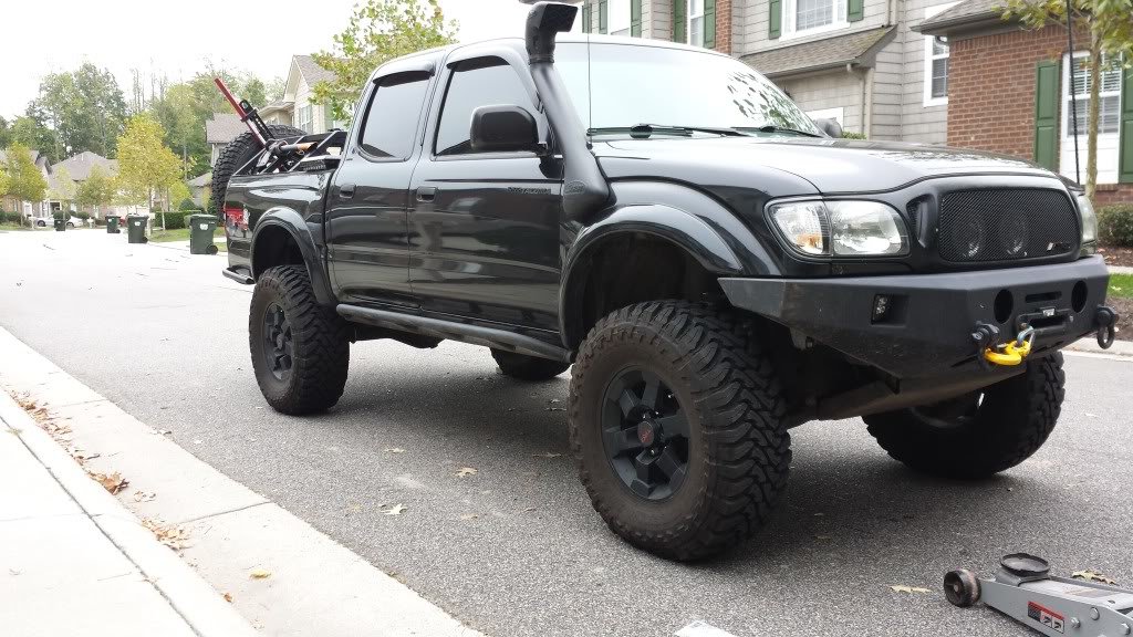

    On your Elite fromt bumper, were you able to get the bolts threaded on the frame rail ends?
    If you didn't, any issues using the winch and getting any shifting or flexing in the bumper?

    Thanks! Very easy to lift. Use the same instructions as below!
    I did get the bolts in the frame rail ends. I've winched many times. I don't remember it being hard to line up. Are you having issues with yours? Weren't you at one point thinking about going to Icon's in the front?

    Yeah, the passenger side bolt doesn't line up and the bumper doesn't sit flush up against the rail ends. It tilts foward around 5 degrees. Been holding off on getting a winch until I can figure out how to fix it. Been wondering if other peeps have had issues with it. Looks like I can hawg out the passenger side hole a bit and it'll work but the tilt is going to take more work. The front grill seems to hang low enough to push on the front portion of the bumper, forcing it to tilt forward. Thought about forcing it flush with a hi-lift on the light hoop then getting th bolts in, but that doesn't seem like a good solution, creating a lot of pressure on that front grill.

    Mine sits the same way, gonna cut my frame ends off and adjust it that way
