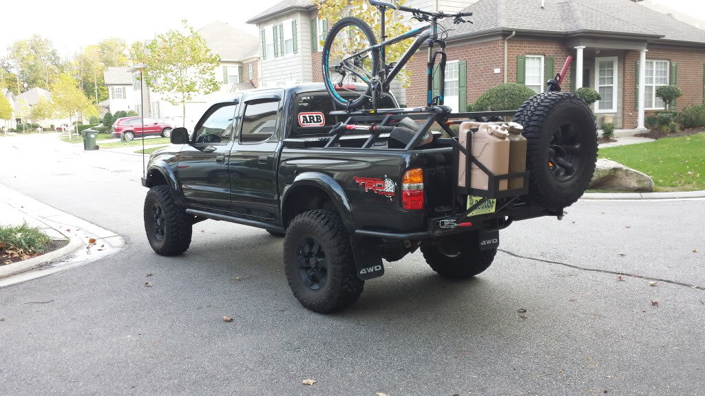

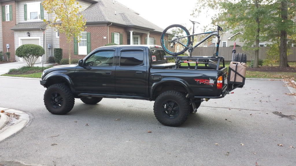

    Snapped some pictures before heading out to ride the new mountain bike.

    lookin good Paul. awesome place to mount the bike imo. got a question for u im thinkin about a rear swing out like u got. i know Adam made urs but waht kind of swing out would u go with im thinkin CBI now but IDK. i was wondering if Adam might be interested to make another one cause i like the jerry can holder a lot man.

    CBI makes quality work. I believe they have the bushwacker series bumpers that have the option of jerry can holders. If not you can call Nathan at cbi and I'm sure they can work with you. I have a friend that has one on his second gen. That's who I would go with if Adam didn't make mine. Last that I heard was Adam is not interested in making any bumpers but who knows. Send him a message. Really cool dude to deal with.

    Wow that's a sexy bumper! :) Seriously though, the truck looks great as always Paul!

    Is that the new Rock hopper from specialized? Pretty good looking all around set up ya got there!!

    You guys should come wheeling with us when we go down to Uwharrie. Shit was pretty fun. We also do a few trips here in VA if you guys want to drive up. Yes it is the new 2014 Rock Hopper! Good eye.
