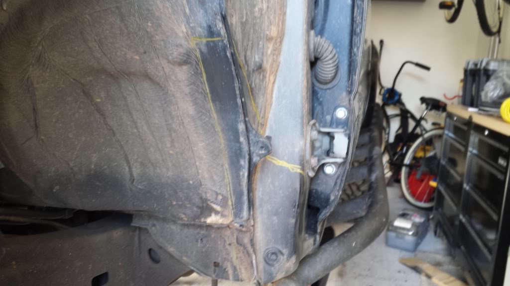

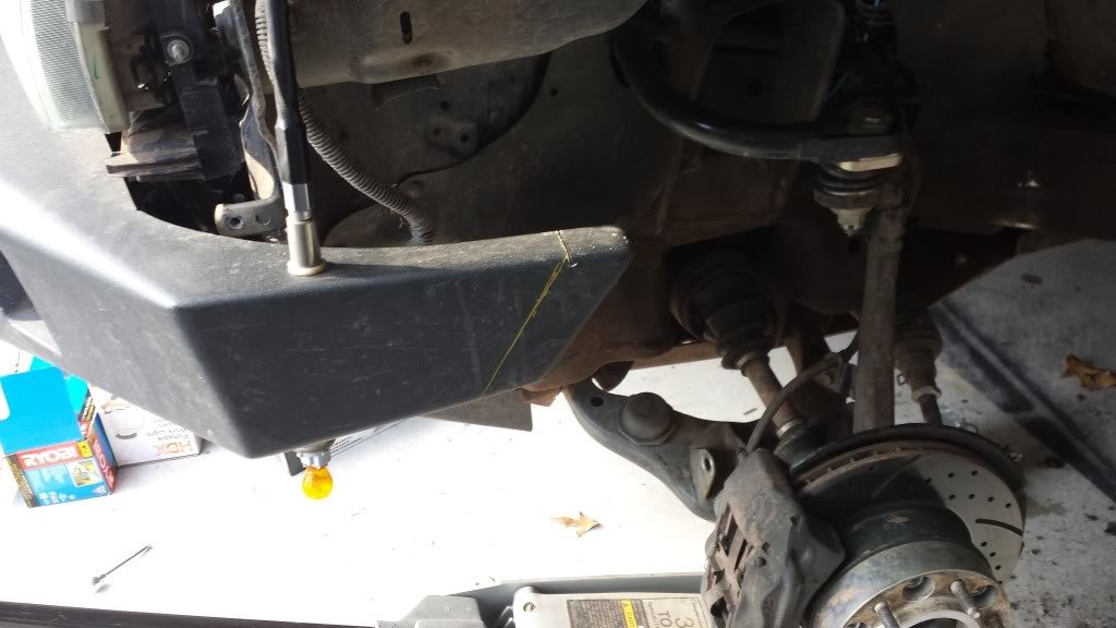

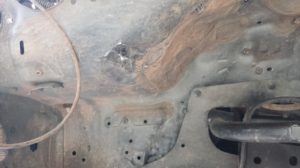

    First I just want to say wanting 35's is a love hate relationship. Love the look and I'm sure I'll love wheeling with them. HATE getting this shit ready! Long tedious process.
    Made my first cut line.
    I ended up having to cut three different times to make it fit.
    The lower portion has a lot of damn sheet metal. Take your time, be patient, don't cut any wires. In fact zip tie the wiring harness out of the way and put a damp cloth between the wall and the wires. Sparks fly everywhere.
    This picture shows after the first initial cut.

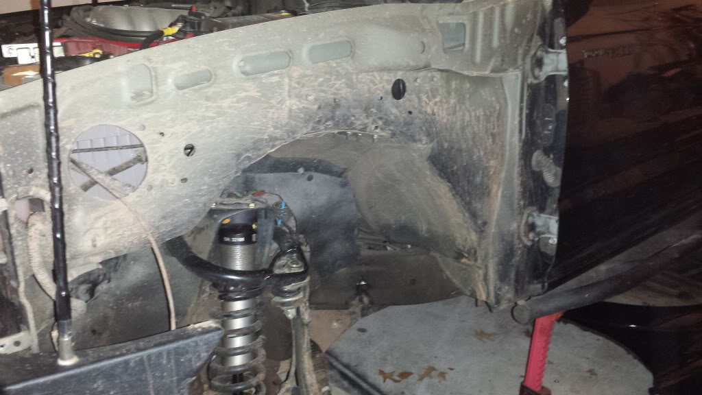

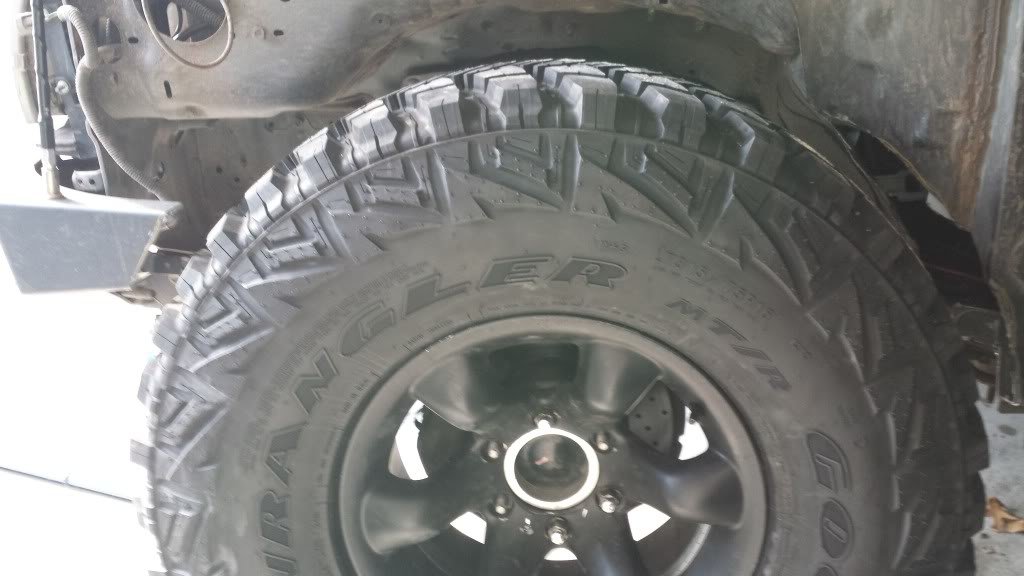

    Now that the first cut was done, time to take out the coilover and compress the tire.

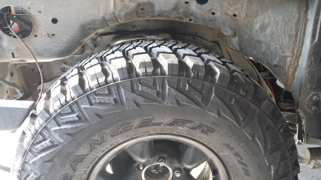

    As you can see the 35 fits nice not fully compressed
    Compressed but not full turned to locked.

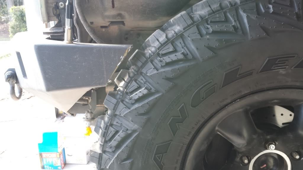

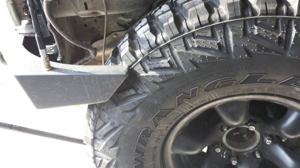

    Ran in to another problem Tanner warned me about. The Elite bumper sticks out too far.
    Ended up taking an 1.5" off of it.

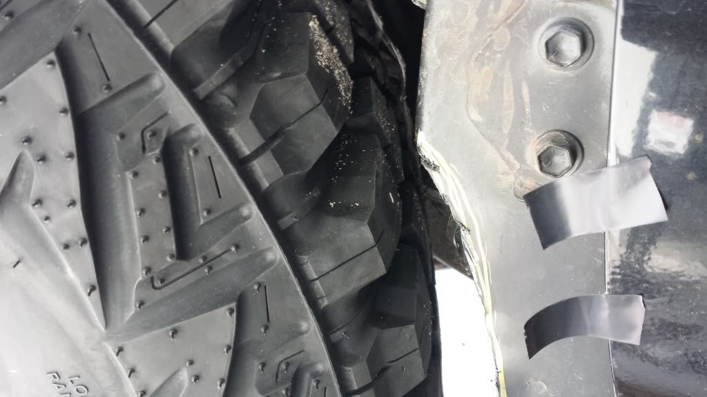

    Second pass. Still rubbed at full stuff.
    Final pass. Shit clears!

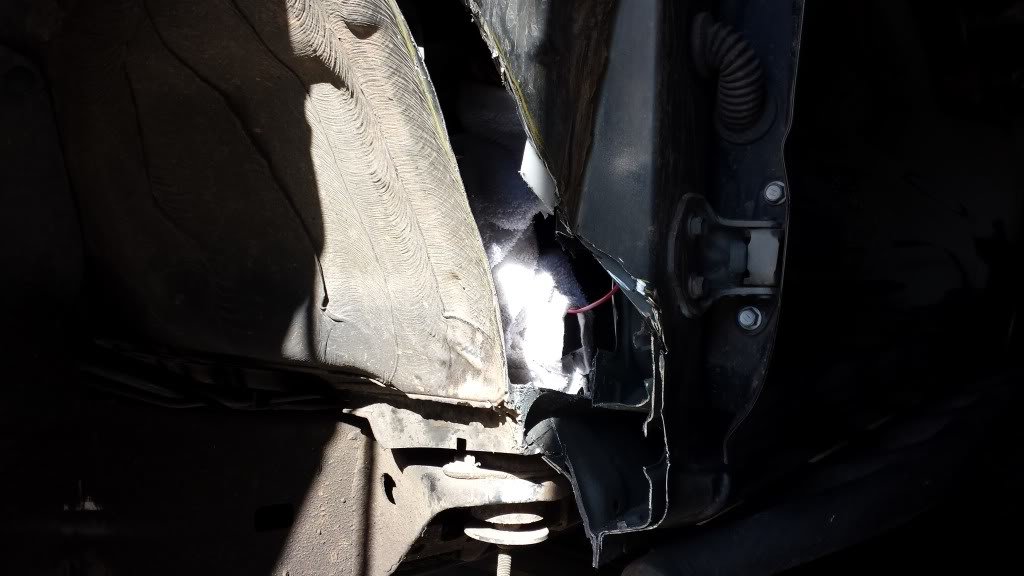

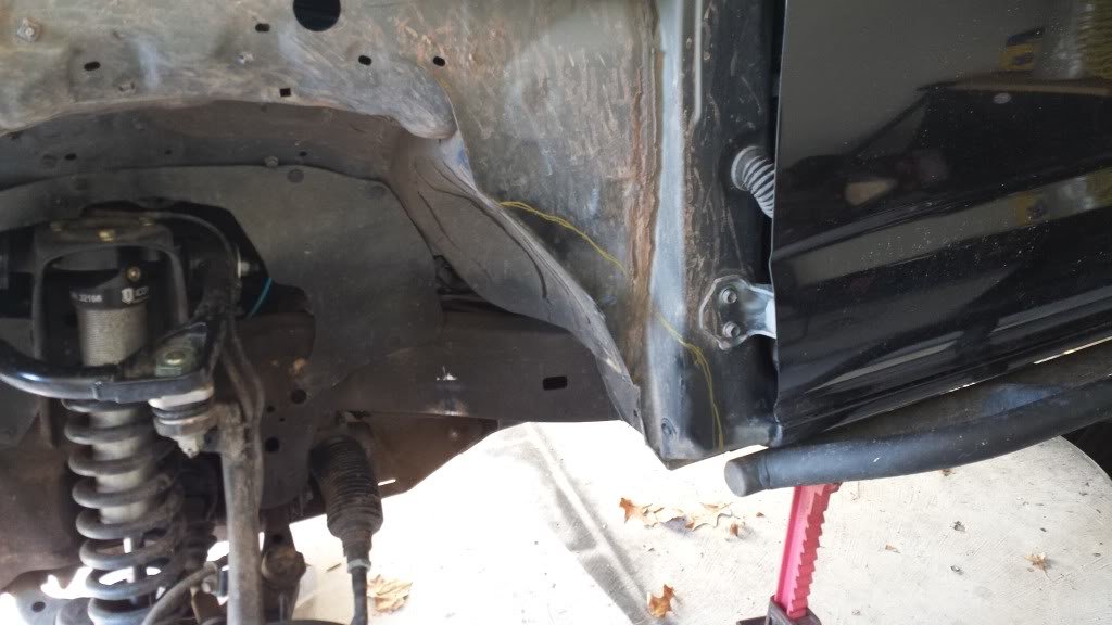

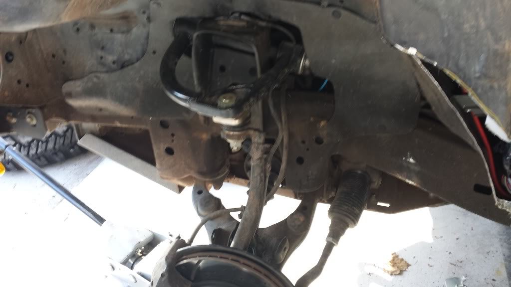

    Tomorrow I'll tackle passenger side. Should go faster now I know what to expect. Also need to trim the fenders, mess with the flares, and trim the rear. I'm going to take my time with this but hopefully it'll be done soon. Hard to work on shit when you have a 1 year old daughter and a wife that is due in 3 months. Might as well do it now while I have a little time!
    I ended up taking about an inch more of depth toward the center of the truck. Pretty much cut to where the kick panel brackets are. I was able to save them
    Finished!
    Also had to push this shit in. Tire hit the top a little.
