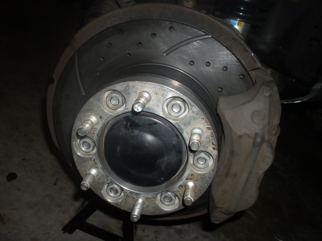

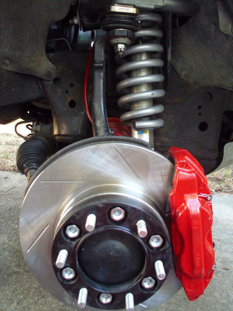

    Yea you swap the front rotors and calipers on from a 1st gen tundra. Works great. Bolts right up. Lots more stopping power to handle the extra weight of bigger tires and armor.
    Id have done it long ago if my 15s would clear them.

    Get the steal braided lines or you will have very squishy brakes after the upgrade.
    I got my calipers off ebay so only spent about $450 total. A few more pics in my build.
