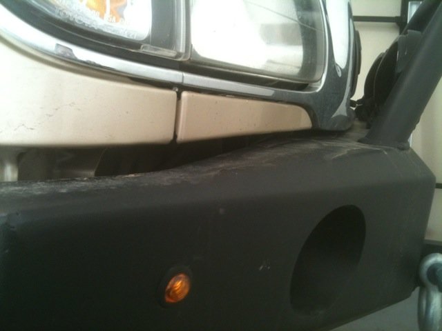

    Tom,
    No problem as far as taking up space. Honestly everything just lined up. I didn't have to do anything special to make it fit. Sorry I couldn't be more helpful.

    Crap. Thanks for the response. Guess I'm going to have to start spending money and trying things.

    Just use washers... in your case put 1 or 2 on the furthest forward bottom bolt, in between the frame and the bumper…. if I'm remembering correctly there should be mounting bolt on the bottom of the frame

    Going to try this but think I need to get new body mounts put in. 125k on the stock ones, I'm sure they've settled quite a bit.

    Thats a good thought but that would just raise the cab a 1/4" or so making your gap larger than it is now. It will help where it looks like its hitting your grille, but it will make your gap near the fender flares bigger

    I'll have to look at it again. The major issue I'm having is the bumper nose is tilted down because of the grill so the "crossmember" is tilted out around 5 degrees from the frame end caps. I can't get the frame end cap bolts installed and I would like to install them in prep for a winch.
    I always seem to get weird issues like this when I do major mods.
    I'm considering going winchless or selling the bumper for an ARB. Don't know if I'd have the same problem though.

    Maybe your best bet is when you go to put a winch on, just enlarge all the mounting holes on the bumper with a step bit that way you can adjust the bumper the way you need too
