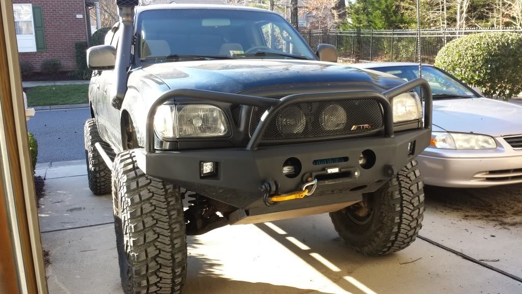

    Did you have to notch the other end of the tube at all? Or did u notch just the side that connects to the center light hoop? I'm gonna be doing the same in a week or so

    All the tubes come raw from relentless. For the center i cut so it would lay vertical then cut again for the desired angle. For the hoops I notched the tubes connecting to the center bar and also shaved the inner tubes closes to the body for it to tilt in a bit. A lot of shaving and test fitting.. No fast way about it.

    Yeah it looks like its gonna take a wile to grind those down, I don't have a tube notch. I have the relentless tubes in the bed of my truck, just gotta get started...
    Did you use a notching tool or the grinding "notching" method?

    grinding notching method. fit, test, fit again. What bumper do you have? Relentless DIY?

    Yeah the relentless DIY. I've always liked the hoops on bumpers, so mine looks incomplete without the hoops IMO.

    Hoops turned out great Paul! Nice work!

    I can honestly say that if I have the money I will buy an Elite and add the hoops just because it looks so much better than mine!

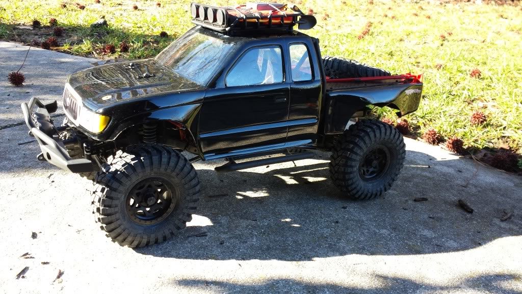

    So they can make ex cab roof racks for the rc's but not real trucks...

    Looks good Paul! I started cutting mine off last night then decided to hold off for a little bit. I still need them to grow on me haha.

    Thanks Tanner.! I like the way these hoops are super close to the body. Really tight though to weld!

    Yea that's the problem I'm having. Mine was super close as well to weld, and even more so to clean up the welds with the flap disk after. I think once I weld my sliders on it'll tie everything in. My main purpose for the hoopers was to protect that from corner from the tight trees we have up here. The fenders are kinda flimsy without the liner and flares now. As I'm sure you've noticed haha.
    I think I'll keep them. Looks pretty mean coming down the highway to :)
