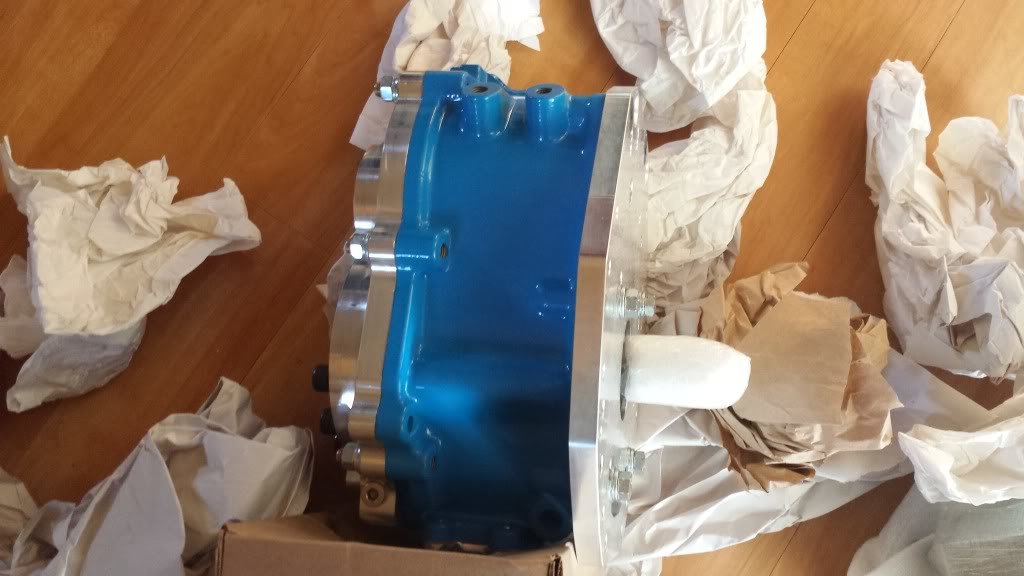

    Where the clocking ring? Also, make sure you use ultr grey between all the mating surfaces between everything. Had mine torn apart this weekend to get rid of the oil leak I was having. Also, take a close up pic of the bearing that goes in the tcase side

    It's all there just not in the picture

    Just got off the phone with inchworm... They already put the upgraded bearing in it.. Apparently thats what the hold up was about!!! So no need to break it down..
    Thanks Lump and Ryan for the heads up!!!
    Looks like they are aware of the issue and will now be sending them with the new bearing!

    i'd still pull the rear plate off that connects between the case and clocking ring. just to put ultra grey on the mating surfaces. mine either didnt have a very good job of sealant on it, or none at all. its all good now

    also, can you get a pic of the bearing we are talking about?

    Thanks ryan.. Tyler sent it with some ultra grey

    Possibly when i get home.. Might not have time with the baby and all.

    Funny, I called them and they said the bearings were fine with only a small handful of cases where they had issues.
    My bearing -
    DSC07641 by wyo_taco45, on Flickr

    same one i got. mine was still in good shape when i pulled this weekend.

    I too got this same answer back in early December. .. today he told me he sent it with the new bearings.. something changed.

    X2.. he stopped me mid sentence and said yours has the new bearing.. This is why i waited to build it.. Straight from Tyler's mouth.

    No Prob, man. Hey, do you know which bearing they went with? (maybe the MRC??)
