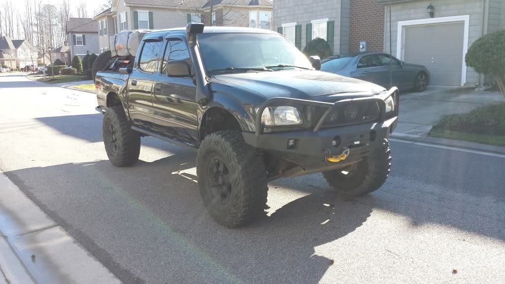

    Between you and PCBuilder I am going to have to look at adding those hoops to my Elite bumper. Did you both get them from Eric?

    Dang man, looks like a lot of fun. I should have done this one...

    Nice looking murdered out truck!

    Thanks guys
    Shoe Creek VA.. It's in Amhurst VA
    Yup.. ordered the from relentless. You just have to notch them yourself and figure out the angles
    Good time. Too many trucks though
    Yeah man! I pretty muched replaced all the chrome. It was a limited model. bunch of chrome
