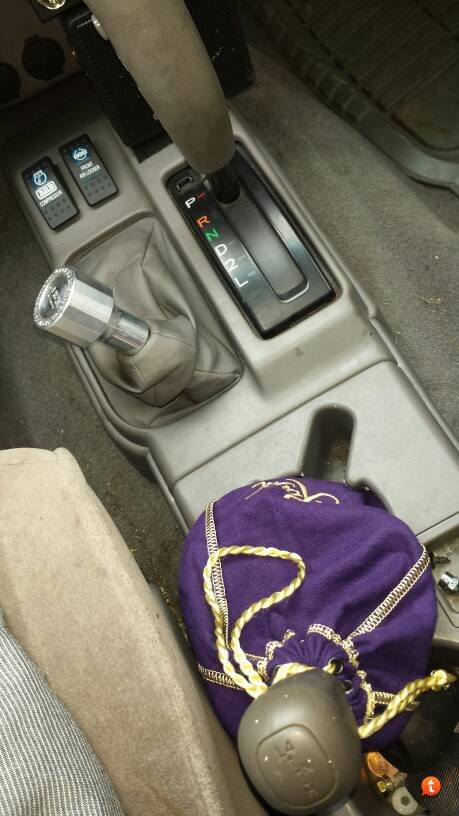

  5. Apr 8, 2014 at 11:38 AM
    #1805
    superwhite10
    superwhite10 Well-Known Member
    Sep 17, 2010
    #43425
    3,526
    Garner, NC
    somebody likes crown royal
  6. Apr 8, 2014 at 11:39 AM
    #1806
    ponethousand
    ponethousand [OP] Well-Known Member
    Apr 5, 2011
    #54384
    4,098
    Paul
    Virginia Beach
    04 trd dc limited
    regeared, locked, armor, and stuff
    Poppin bottles

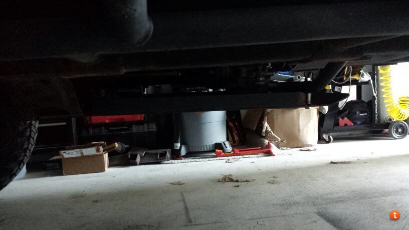

  7. Apr 8, 2014 at 4:55 PM
    #1807
    ponethousand
    Apr 5, 2011
    #54384
    4,098
    Paul
    Virginia Beach
    04 trd dc limited

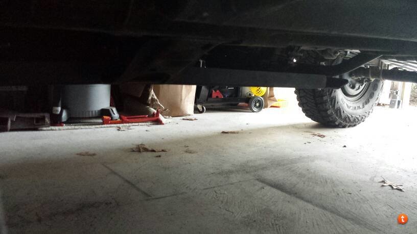

    Had to add 1" spacer to the rear so my bud built skid would fit back on and clear the crawl box mounting plate
  8. Apr 8, 2014 at 4:57 PM
    #1808
    Redneck92
    Redneck92 Well-Known Member
    Aug 9, 2012
    #84398
    1,683
    Concord, NC
    02 Tacoma Limited TRD
    Just the norm skids, sliders, & 35's
    You not clock the case up?
  9. Apr 8, 2014 at 5:01 PM
    #1809
    ponethousand
    Apr 5, 2011
    #54384
    4,098
    Paul
    Virginia Beach
    04 trd dc limited
    I did but still didn't clear my rails by a little. Probably could have put the skids on without the spacer but wanted a little room

    This is making me want to get the Lefty transfer case more and more so I can find out how it compares to the crawl box.
  11. Apr 8, 2014 at 5:26 PM
    #1811
    ponethousand
    Apr 5, 2011
    #54384
    4,098
    Paul
    Virginia Beach
    04 trd dc limited
    Do it! Although all the different options as far as gearing goes I'm pretty excited about. A few different combinations! Lefty would have been so much easier to install. Shit took longer than I thought because the drive shaft place was backed up.
    All in all I paid less than $450 for my drive shafts to be lengthen and shortened.
  12. Apr 8, 2014 at 5:29 PM
    #1812
    Redneck92
    Aug 9, 2012
    #84398
    1,683
    Concord, NC
    I thought it was possible to flat belly it with duals. Might be a little work though. I might consider a lefty case moar research.
  13. Apr 8, 2014 at 5:31 PM
    #1813
    ponethousand
    Apr 5, 2011
    #54384
    4,098
    Paul
    Virginia Beach
    04 trd dc limited
    Probably is but that shit was sitting too close. A little room won't hurt anything. Shit.. Rather that shit scratch my skid plate than fuck up whats above it!
  14. Apr 8, 2014 at 5:33 PM
    #1814
    Redneck92
    Aug 9, 2012
    #84398
    1,683
    Concord, NC
    Very true. Lots of expensive shiney parts.
  15. Apr 8, 2014 at 5:43 PM
    #1815
    Blackdawg
    Blackdawg Dr. Frankenstein
    Dec 31, 2010
    #48500
    81,642
    Monte
    Wyoming/St. Louis
    The Trifecta of Taco's
    you can flat belly. Just have to clock the case 15˚. But you have to beat the shit out of the floor boards and do some modification and have a different mount.
    not sure how it would go down with a double cab now that i think about it. All the builds i have seen have been extended cabs..

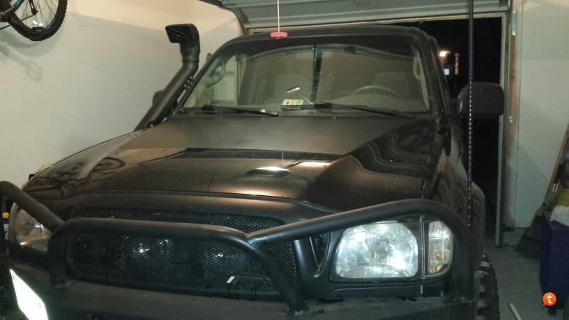

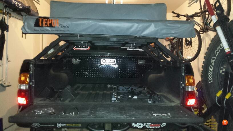

    Did a few things tonight.
    Crawlorado hood blackout. Sitting in my garage from a local member. Originally for a second gen. Trimmed it up a bit.
    4 ft awning from tepui. Measures out to 4'10. .
    Went to mount my LED light bar and one of the brackets are pretty bent. Going to mess with it when I have more time. Actually going to message the place I bought it from to see if I can get another mount sent.

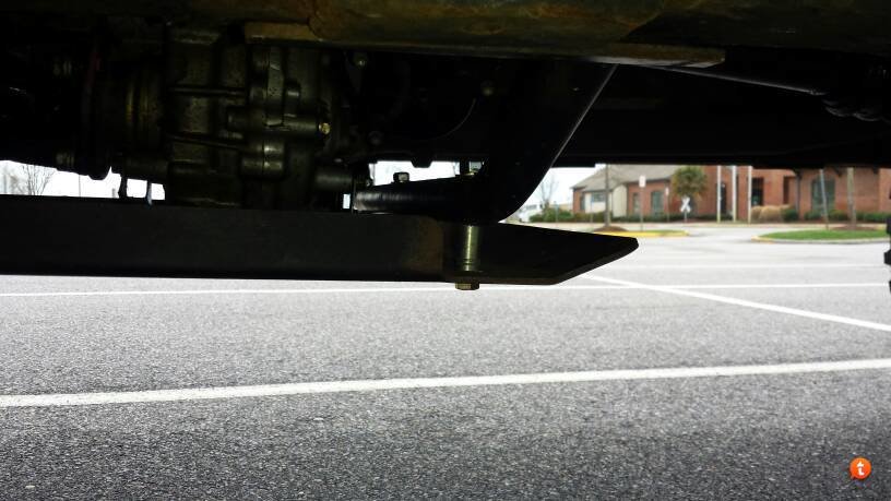

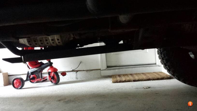

    Here are some pictures of the bud built mounted
    Even with it clocked It would not clear the rails on a dc. Still happy with the end result.

    I like it! I wouldn't worry about it either. I ended up clocking my case to almost have a flat belly and still haven't redone my skids. Honestly, I haven't really noticed it hanging up when wheeling... yet... :)

    I think i would have to beat the shit out of the floor boards to make it fit better like monte said. I think your right. It's fine the way it is. Shit's protected..
