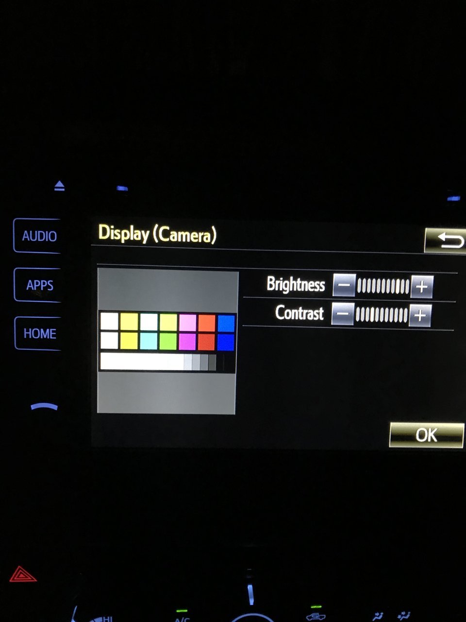

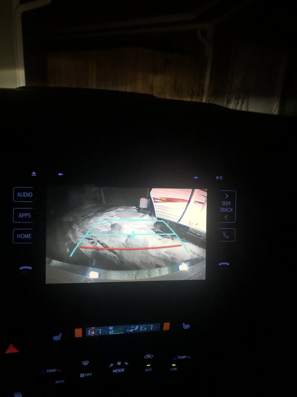

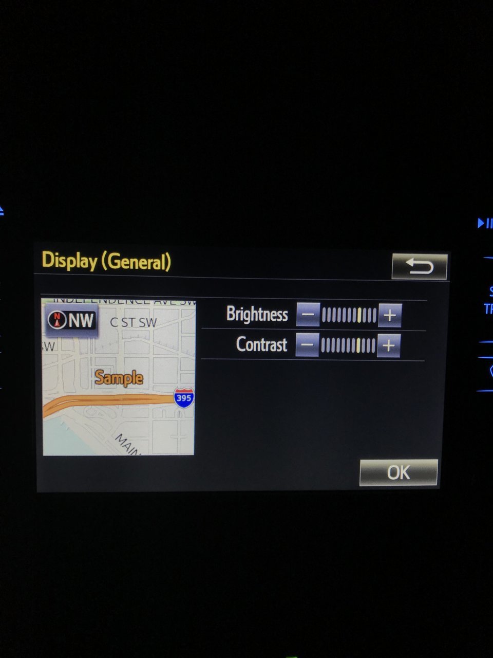

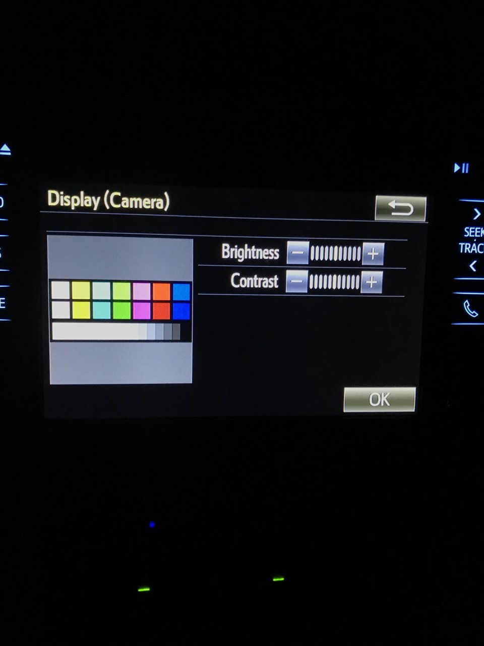

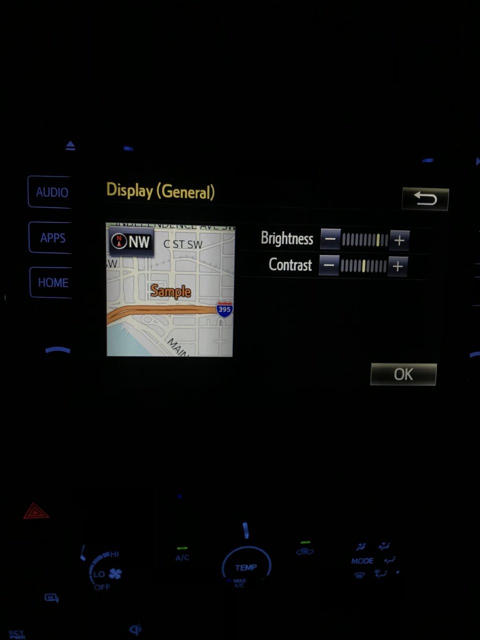

    Check the contrast and brightness.... had the same problem. Also - wipe the camera with a cloth (any dirt causes problems)
    Here are my settings:
    Turn the truck on and enter the display settings.
    - With lights off - the first two pictures are my settings. (Note the general and Camera settings in the picture)
    - With lights on - the last two are my settings. (Note the general and camera settings)
    - Also- my ‘Day Mode’ option is un-checked
    Lights off Camera: Right in middle (both)
    Lights off General: 8 clicks right (both)
    Lights on General:
    9 clicks over for Brightness
    6 clicks over for Contrast
    Lights on Camera
    4 clicks over for Contrast
    See if that helps....

    I don't know about anyone else, but I can't make out the settings in your first and last photos.

    Just edited with the ‘number of clicks to the right’. Posted this on my phone so was hard to tell how that landed on the forum. Hope this helps!

    perfect, thanks!

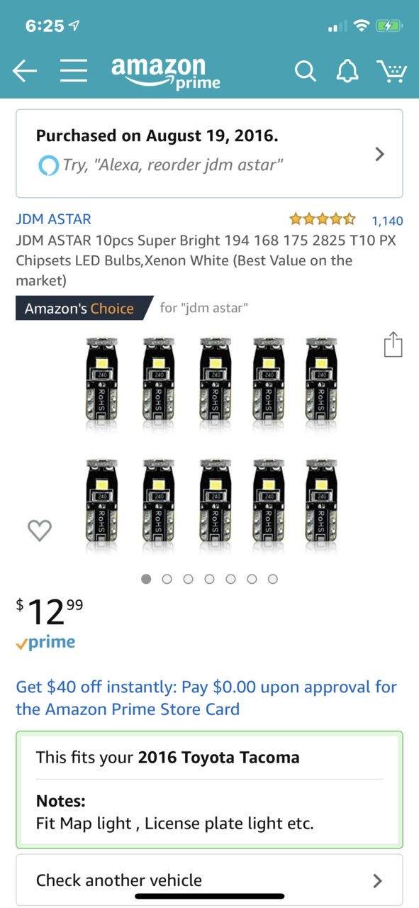

    LED license plate bulbs. 0530 this morning. No issues and crystal clear image

    I’ve been running these since 2016. No issues and very bright.
