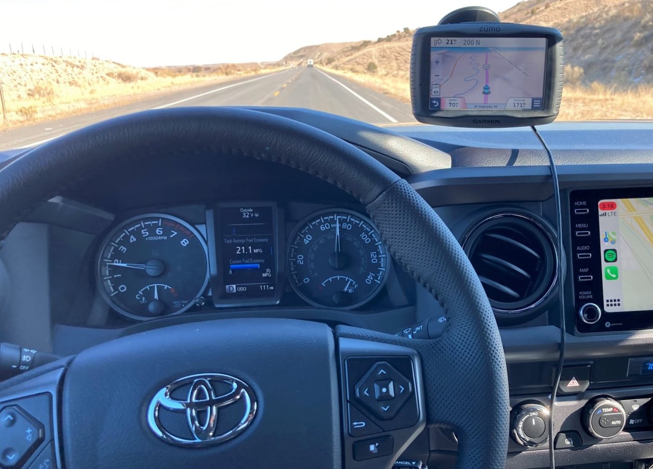

    I purchased my truck in Salt Lake City and drove it back to the Midwest last fall with the same GPS and with the 265/70-16 tires, the speedometer indicated a faster speed than actual in this pic.
    Speedometer was reading 2 to 3 mph fast vs GPS speed..
    Here is a pic with only 111 miles on it, while driving back.

    My general assumption/theory is that Toyota either planned to install larger 265 series tires and then abandoned the idea, hence the difference in speedometer reading. It could also be that was an easy way for Toyota to cheat the system. Allows the person driving to believe they have the cruise set on 70, but they are really getting 66-67 MPH economy. It’s not a huge difference but for a truck that already struggles with downshifting it could have been the push they needed to be able to broadcast the efficiency they claim.

    I believe the Michelin Defenders run slightly small for their size.. I run 28 psi cold in them due to the increased load capacity over the stock 265/70-16 load capacity which could impact rolling diameter slightly also.
    Both my 2000 and 2006 Tacoma's had optimistic speedometers also with OEM stock tires.
