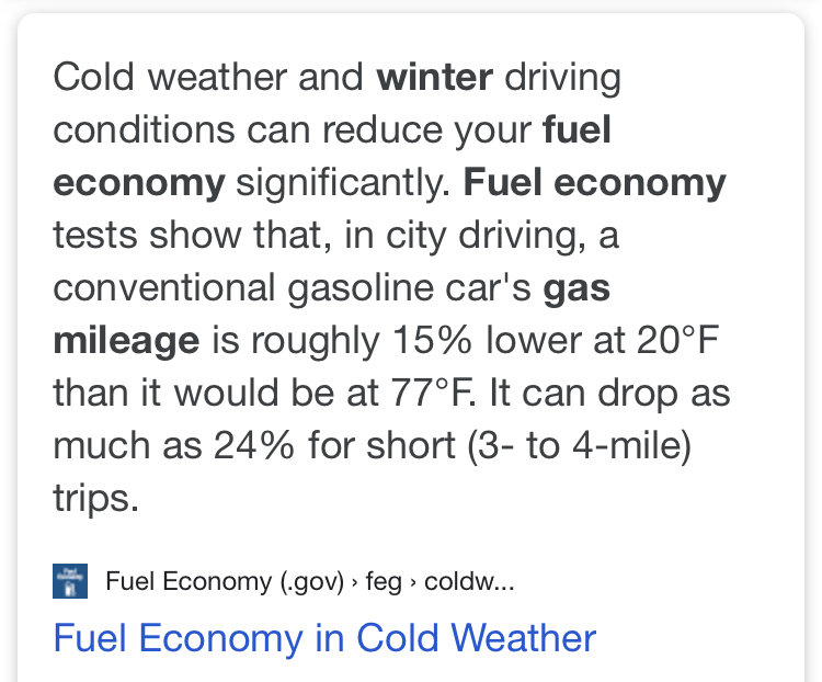

    Not again....
    also winter gas
    Edit:
    tacotoe and Junkhead like this.
