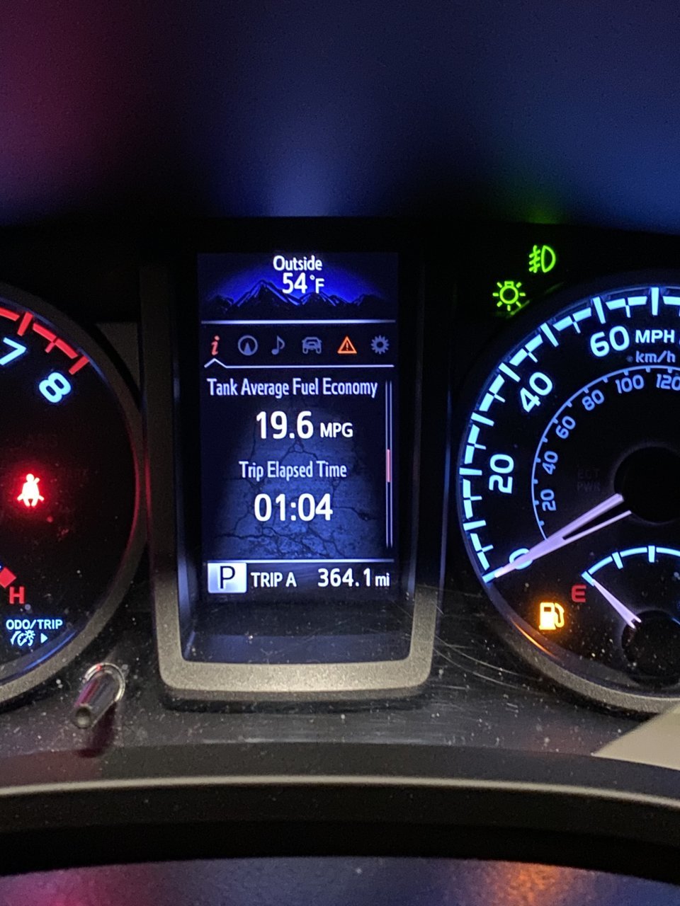

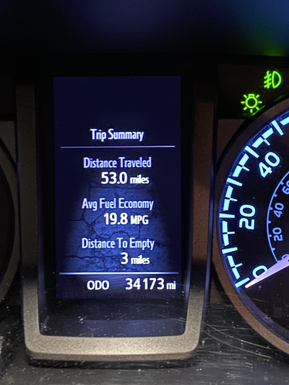

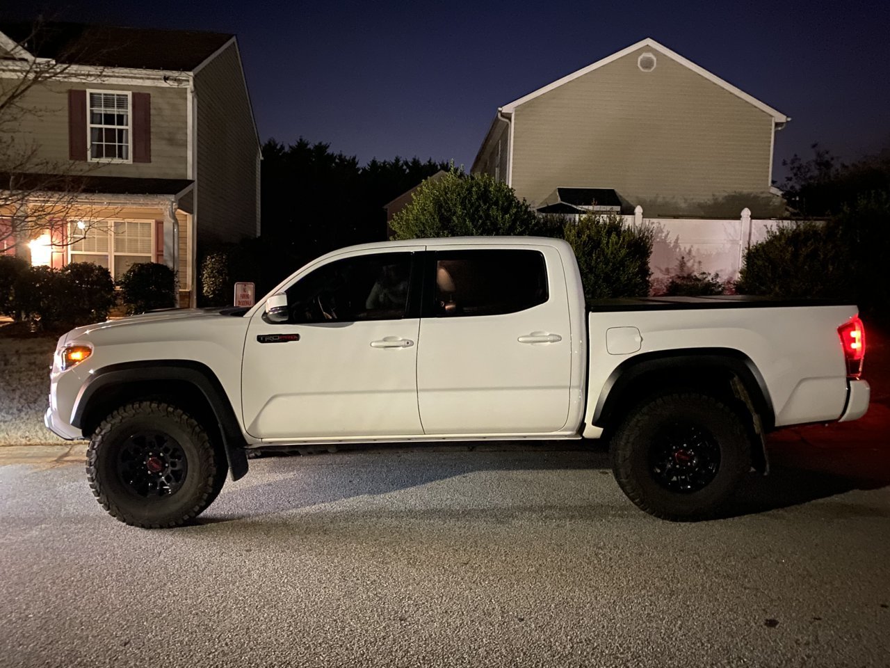

    0CB2E852-FADE-484A-9B75-106053F48601.jpg 923EE10F-4F21-4B6B-9530-E43D4720F716.jpg Uncorrected speedo driving like an asshole today, in 4wd checking trail cams and pig hunting, still averaged over 20mpg for the tank, and I’m on 285s....86689D80-757B-4397-B9B1-4D1F164CC530.jpg
