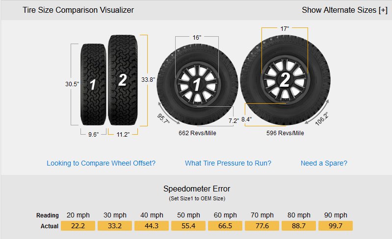

  4. Dec 26, 2024 at 2:22 PM
    #24
    chadstacoma
    chadstacoma Well-Known Member
    Jun 17, 2015
    #157616
    2,264
    chad
    mcclave,colorado
    2005 tacoma crew silver trd
    I have a 05 double cab 4x4 auto and have a 4 in lift and 285/17 tires and no matter town or hiway i get around 9-10 mpg, i drive around 55-60 all the time. I usually drive in 4th instead pf drive because it pulls easier and dont want to downshift all the time. Iv tried it both gears and its worse in drive. When i first got it ,it had 32 in tires on it but no lift and was getting around 17 mpg? Really all that changed is lift. I cant afford to drive it anywhere. I want to take it to the mountains here in colo to drive sum trails but im 4 hrs from mountains and it would cost me bout 80 bucks in gas just to get there

    Re-calibrated the Speedo / Odo?
    At 50 you are going 5.4 MPH faster than your truck is registering.
    That means you are going 10.8% faster and 10.8% further so if you are not logging that mileage you are getting 10.8% worse perceived fuel economy.
    Right away that explains 17MPG down to 15.
    Your tires are likely larger than your gearing can handle thus the need to drive in 4th all the time and never into fuel sipping Over Drive. Time to regear that pumpkin.
