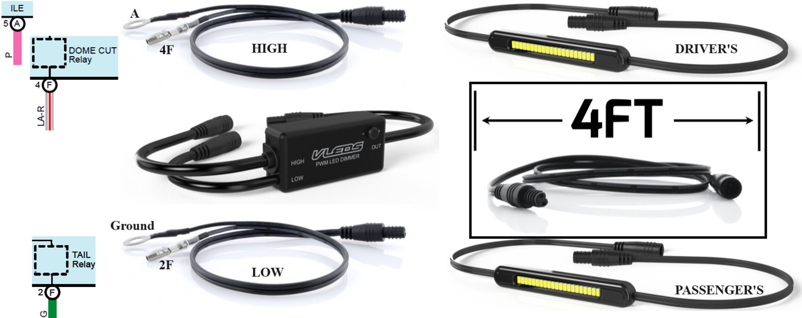

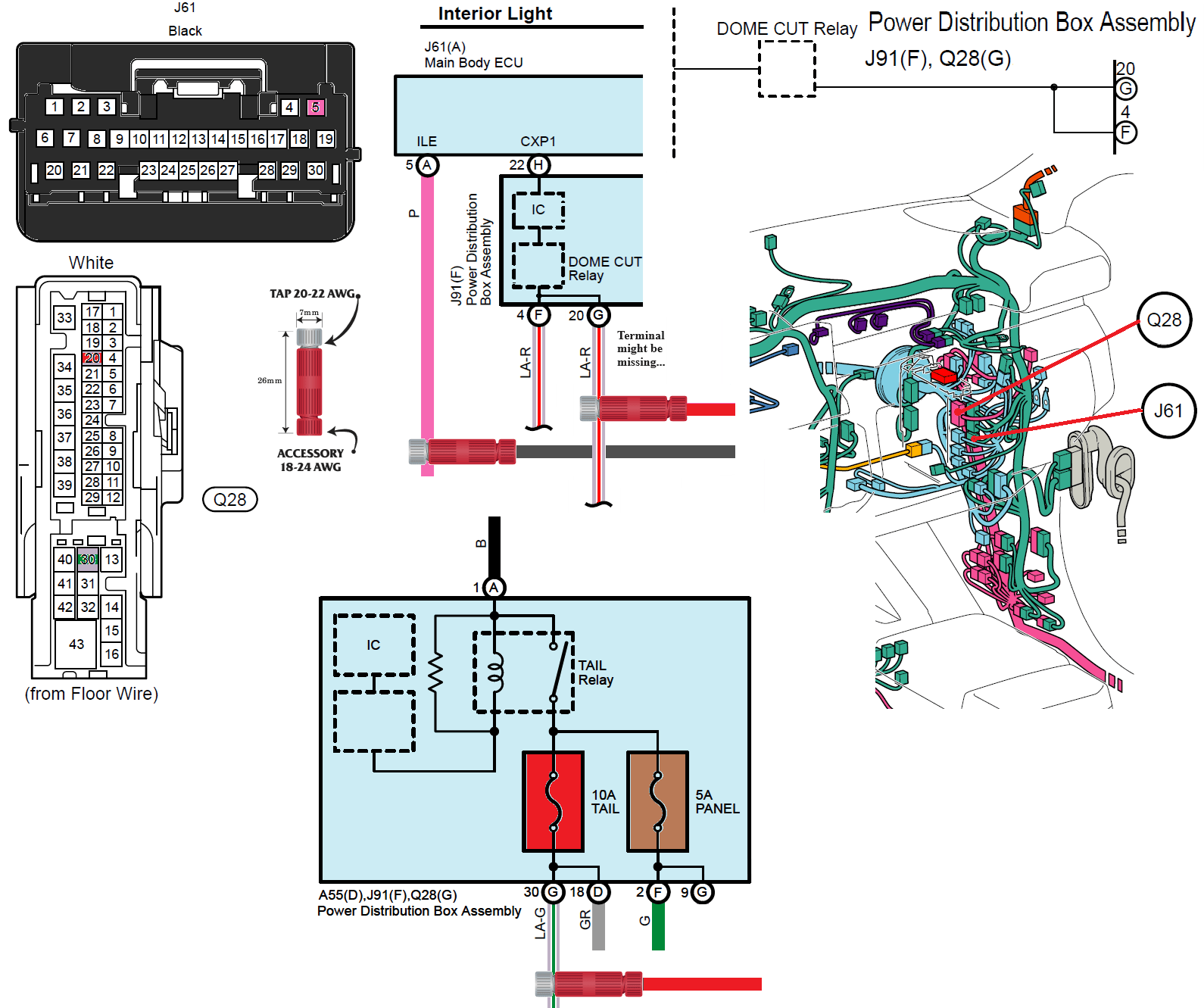

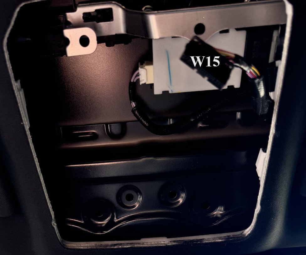

Poor man footwell or puddles LED's
Discussion in '4th Gen. Tacomas (2024+)' started by caribe makaira, Aug 7, 2024.
  1. Aug 7, 2024 at 1:20 AM
    caribe makaira
    caribe makaira [OP] Well-Known Member
    Feb 13, 2011
    #51121
    11,764
    Caribbean, Puerto Rico
    05 PreRunner TRD Offroad AutoTrans
    Hood Struts, My version Fogs always ON, Map & Overhead Light Mod,

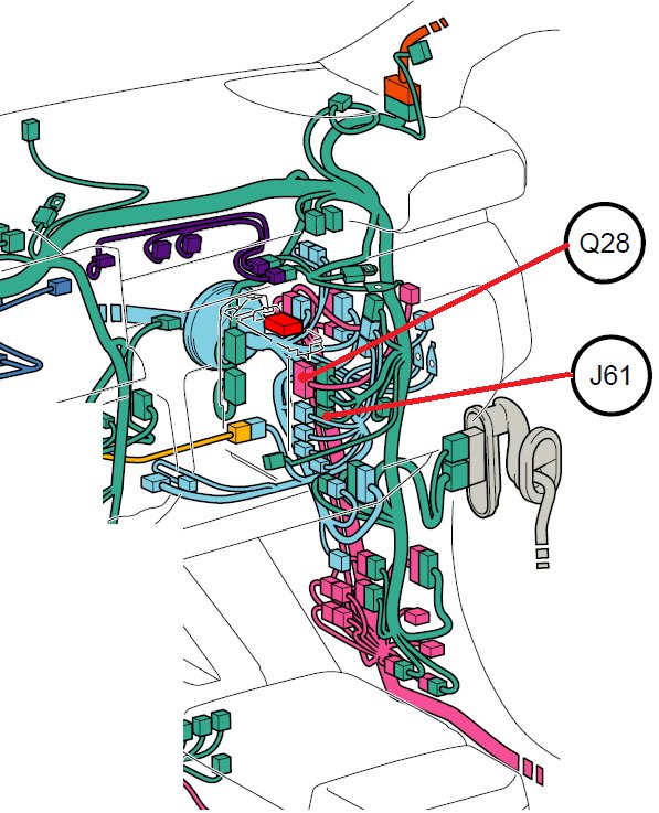

    Connectors:
    Locations of connectors

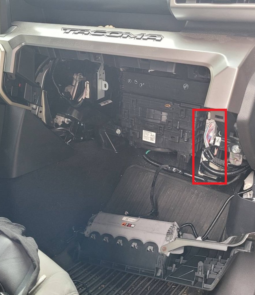

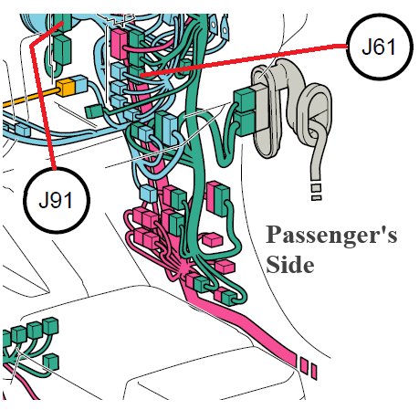

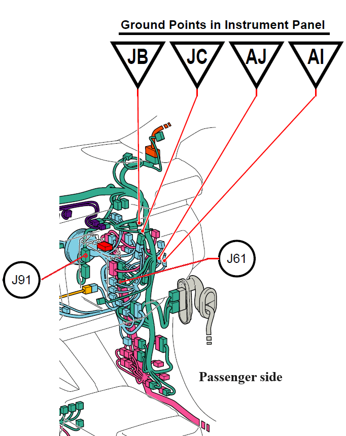

    J91 is on back of Power Distribution Box (firewall side)
    On/Off Switch optional.
    Recommended tap types.
    Pro version soon by @kmorgan3

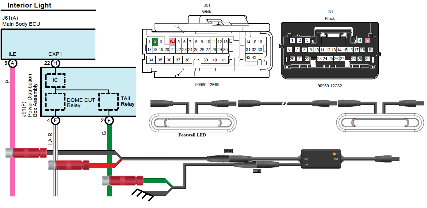

  2. Aug 7, 2024 at 8:00 PM
    caribe makaira
    Feb 13, 2011
    #51121
    11,764
    Or this:

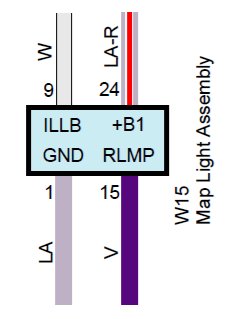

    Another easier version if the wire is present on connector Q28_20.

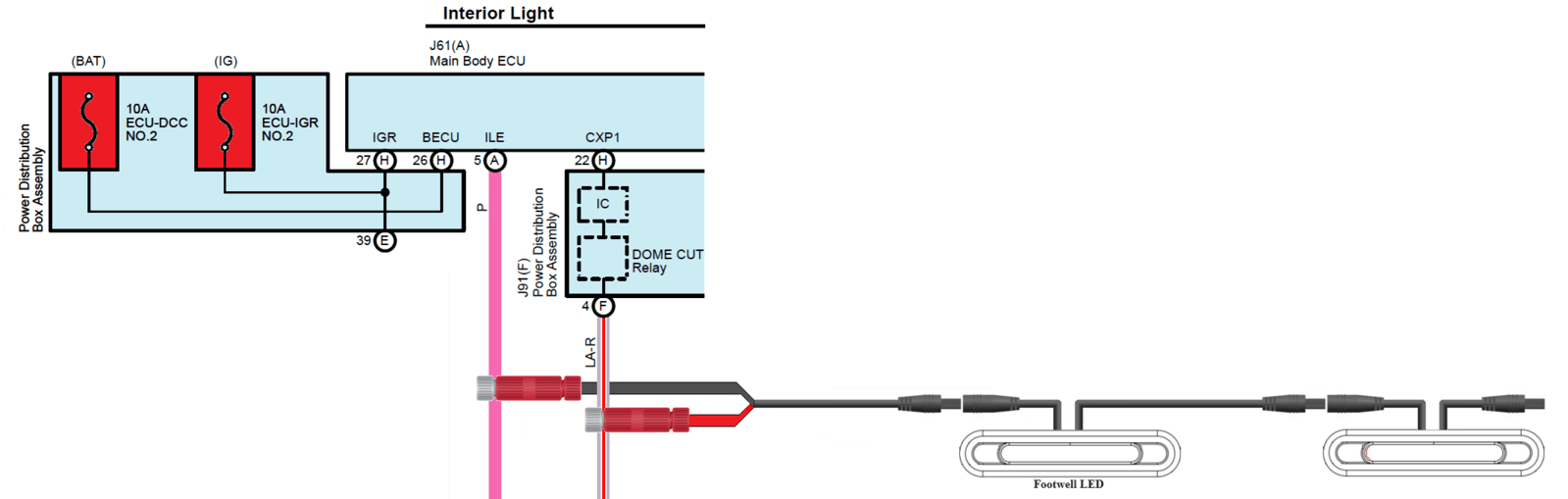

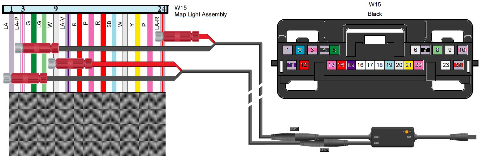

    Another iteration:
    Slave to overhead switch. Overhead switch selection can turn the footwell lamps off, but upon selecting parking circuit, they turn on. This 2nd illumination has brightness control via footwell module.

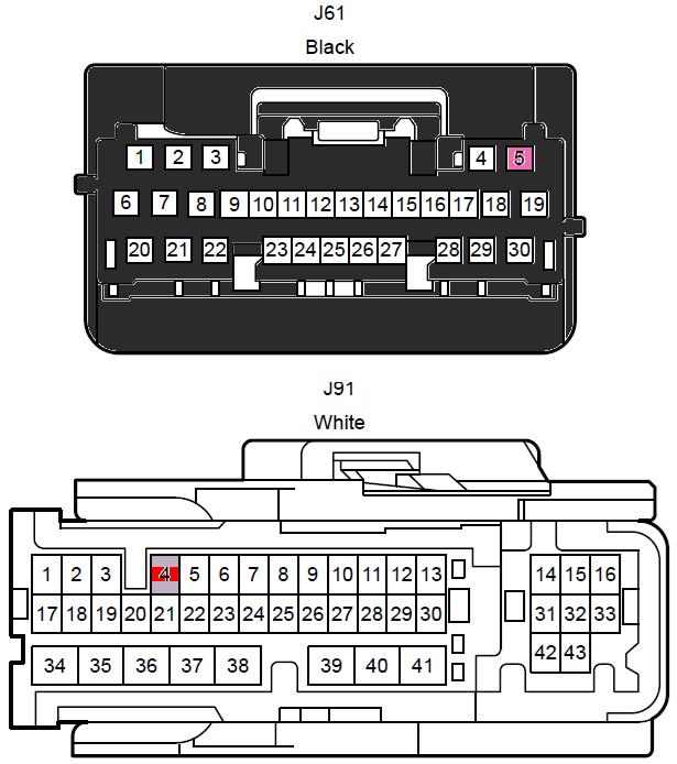

  8. Sep 26, 2024 at 8:43 AM
    Iqudayo
    Iqudayo Well-Known Member
    Aug 23, 2024
    #455707
    77
    Antonio
    Toyota Tacoma
    So what are you connecting to Q28, and J61 can you give some more in depth detail. What did Did you tap into.
  9. Sep 26, 2024 at 1:15 PM
    caribe makaira
    Feb 13, 2011
    #51121
    11,764
    Read all again, slowly...
