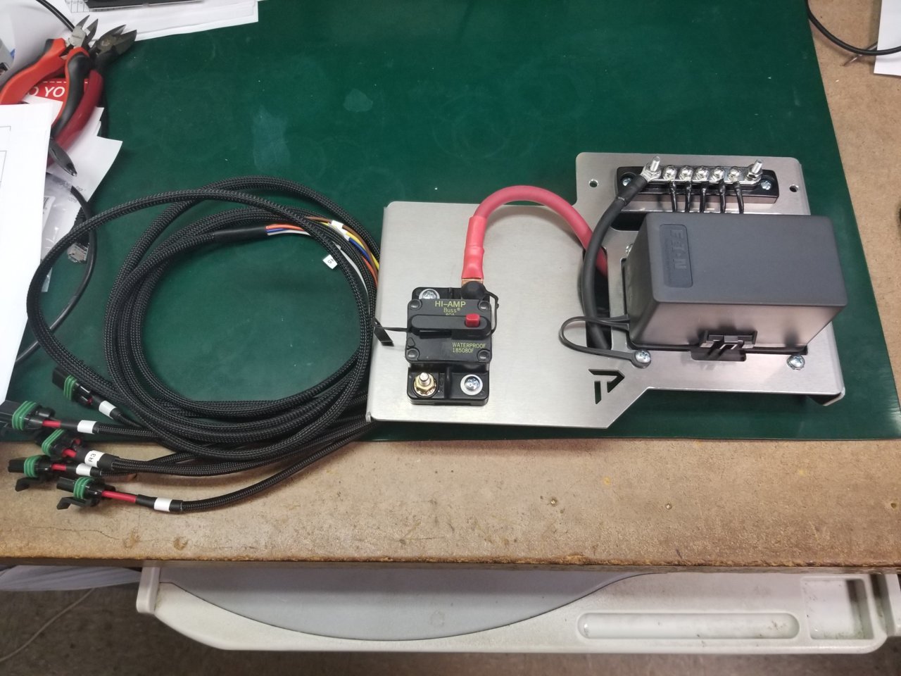

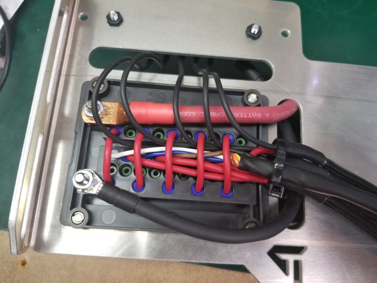

  8. Apr 12, 2018 at 6:43 AM
    #28
    VangaSTL
    VangaSTL [OP] Well-Known Member
    Oct 27, 2015
    #167889
    3,602
    Garrick
    St. Louis, MO
    2016 TRD Sport 4x4

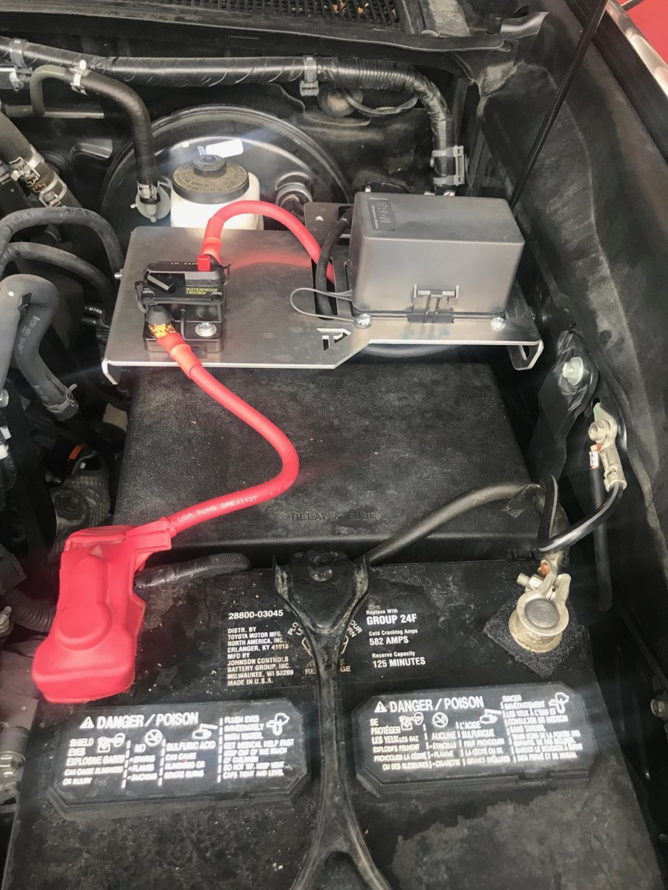

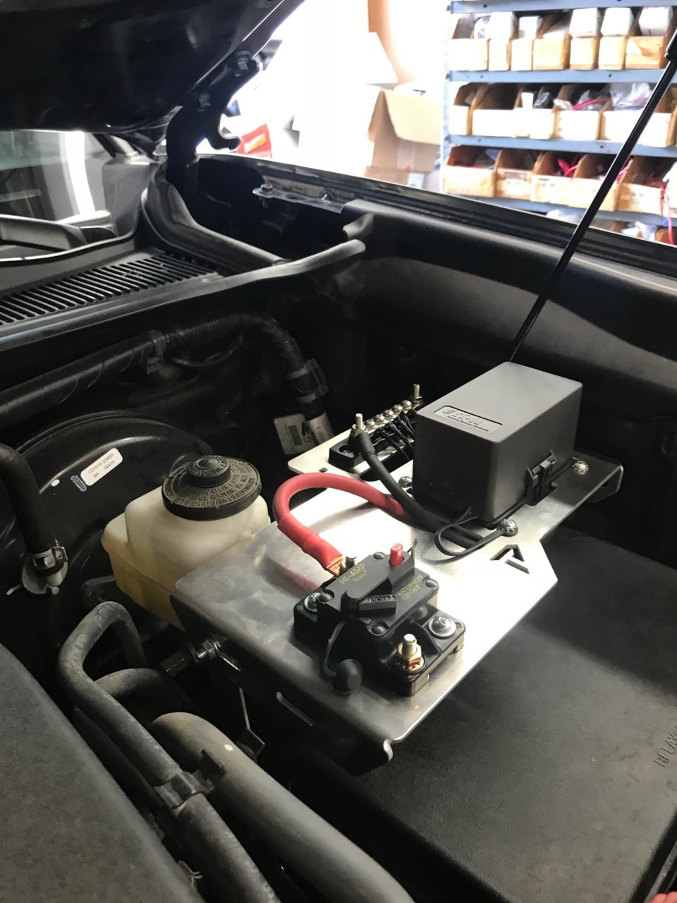

    Version 3 is finished, this was by no means a "Poor Man's Relay box" but if you want your Relay box to be as professional as possible, this is the way to do it. I was approached by another member on here (You know who you are, I'll let you decide to come forward or not) to build him a "no expense spared relay box." I did NOT make profit off this. Just another challenge I accepted. All in all it cost him $332.10 for supplies which includes:
    -Bussmann RTMR
    -Connectors
    -Cable Seals
    -Cavity plugs
    -Micro Relays
    -100A grounding bus
    -80A Breaker
    -lugs
    -8 AWG battery cable for grounding
    -4 AWG battery cable for Positive
    -14 AWG GXL wire
    -12 AWG GXL wire
    -shrink wrap
    -fiber loom
    -powertrays mounting bracket

  9. Aug 4, 2018 at 4:00 PM
    #29
    jptheriot
    jptheriot Meso Investor #5
    Nov 2, 2012
    #90353
    968
    Jp
    St. Louis
    3rd Gen TRD Sport DCSB 4x4 / previously owned 1st and 2nd Gen
    Step Bars / BakFlip FiberMax Tonneau Cover /5% Tint Rear 20% Front / Reverse Cam Anytime / Coin Holder / LED Interior and reverse lights / Katzkin Leather Interior / Hondo knobs / TRD Pro Wheels / Black badges / Pro grille / @mesojdm designed Ultimate LED side mirror turn signals, BTLM, BD 3rd Brake Light, GASSHOLE, Ultimate Dome Light, Ultimate Map Lights, Custom Fuse Cover, Custom OEMeso Headlights / In-dash Universal Mount with iOmount
    IMG_9876.jpg IMG_9875.jpg And here are a couple of pics installed.
    VangaSTL[OP] likes this.

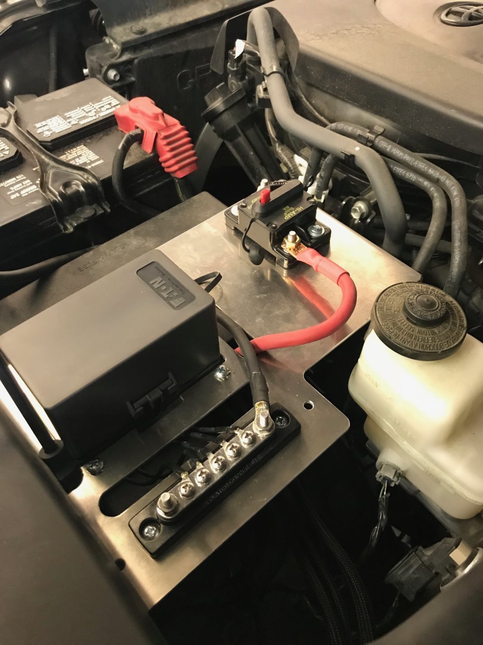

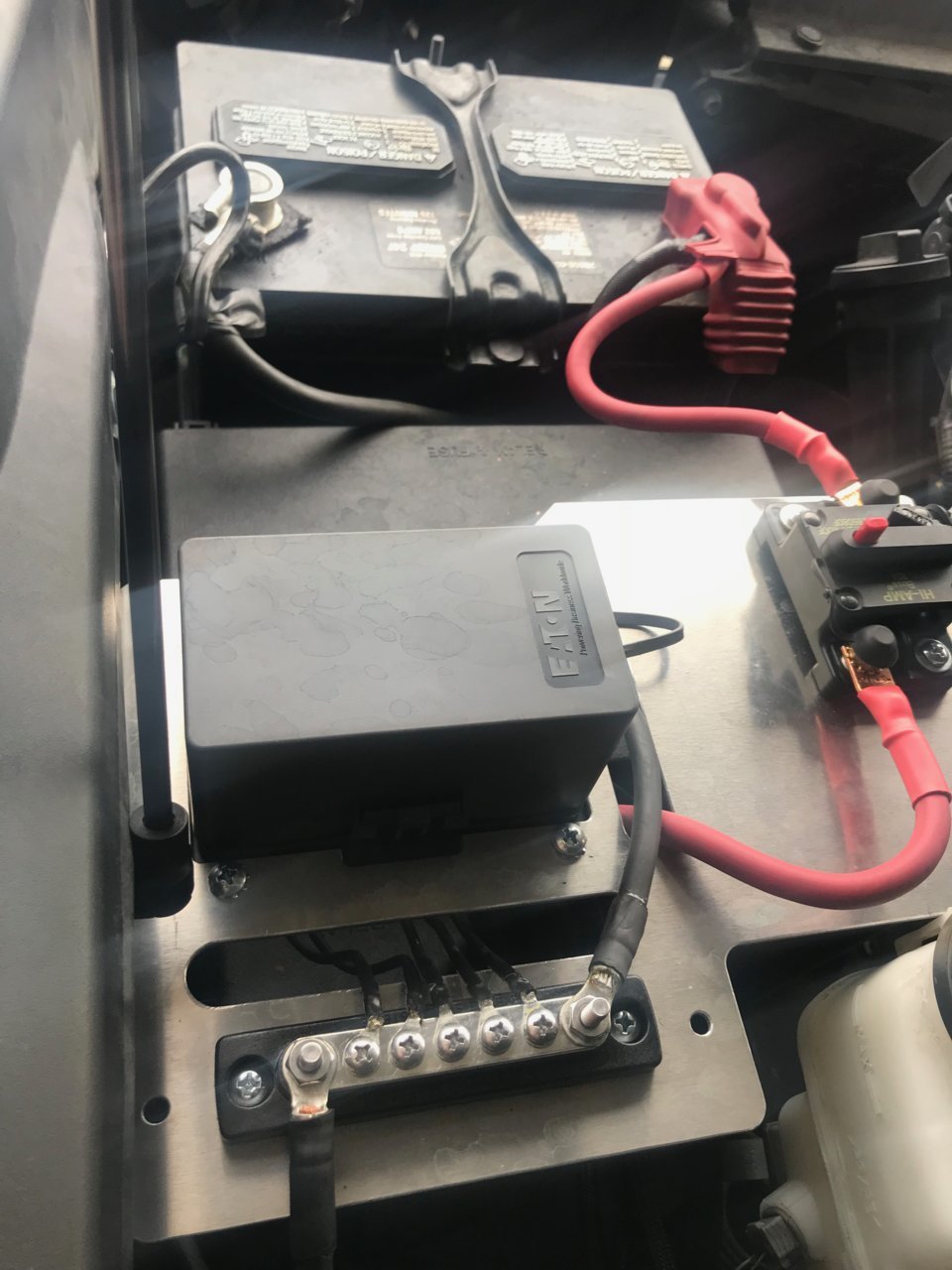

    Here you go!
